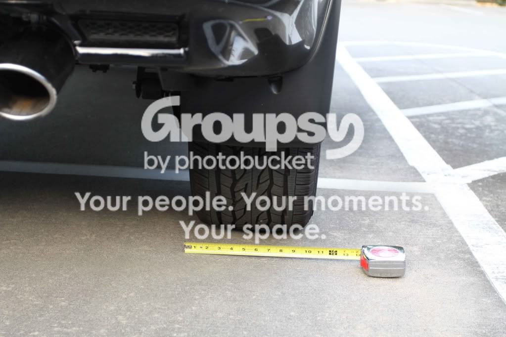

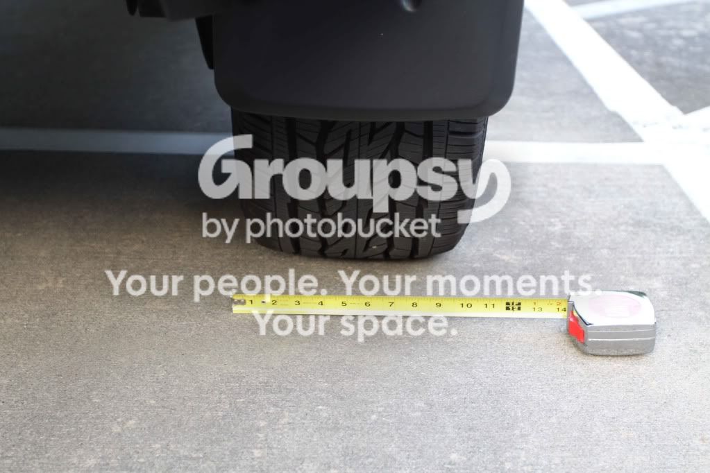

Would either of you be so kind to post a straight-on shot from the front/back to get an idea of the stance/width of the tire compared to stock 245s? It's still a 7" rim but I'm sure the 275s will look better, just perhaps not as beefy as say on an 8" rim.
Thanks!
I would like to see this as well if its possible! Thanks!
zepjet/jcatan3,
Thanks!
Sure. I'm out of town but will post photos next week. The Conti's are about the same width as the OEM mudflaps. They would be wider on an 8" rim.
Still waiting for the pics - :hungry:

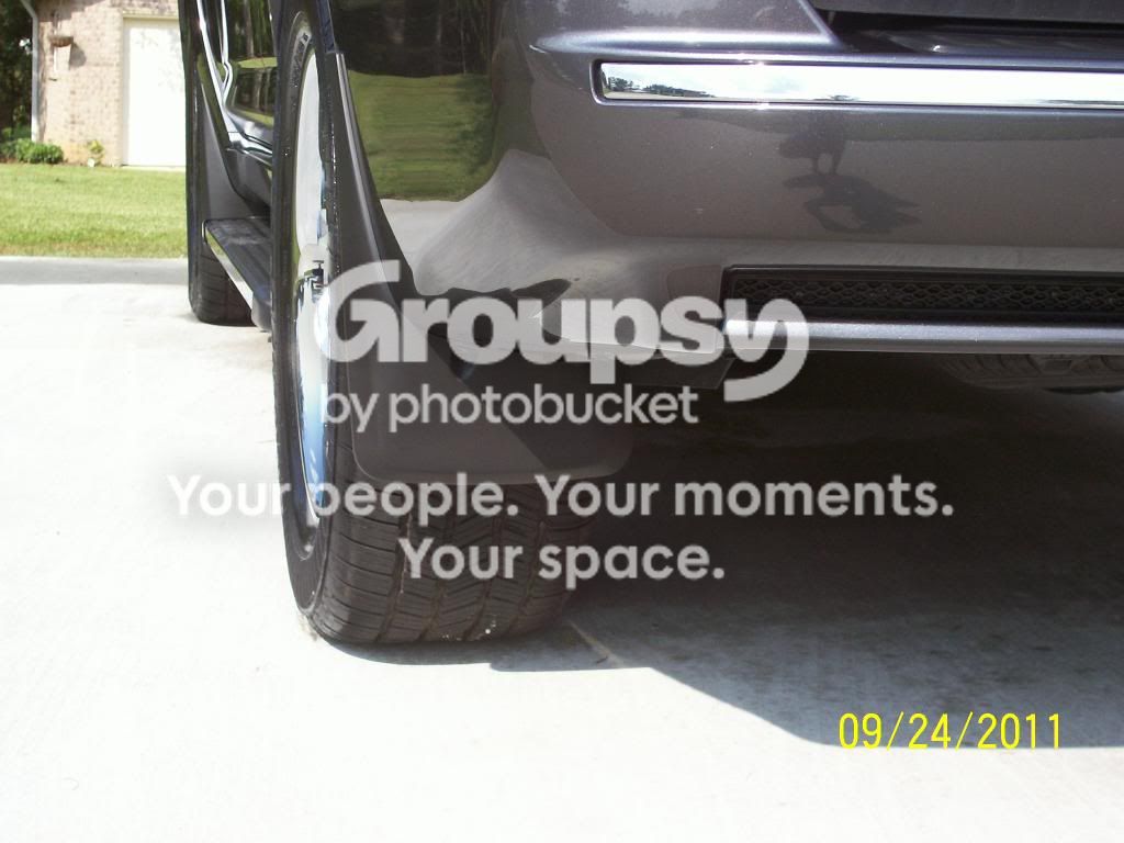

Sorry for the slow response. Here's a couple photos...
IMG_1955_1.jpg~original
IMG_1956_2.jpg~original

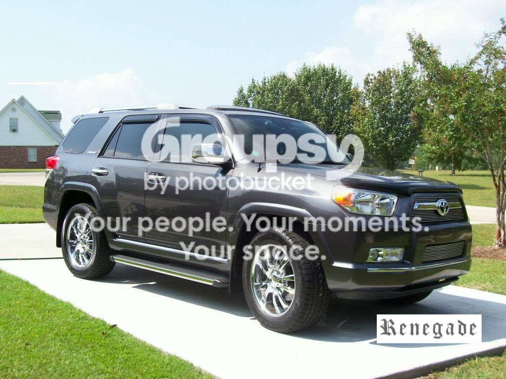

These are KMC 20x9, with 275/55/20....no rubbing, seems to be a nicer ride. I'm happy with the fatter footprint...:thumb3:

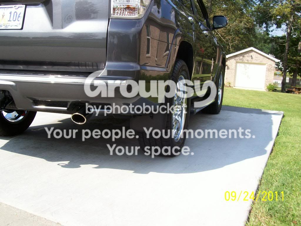

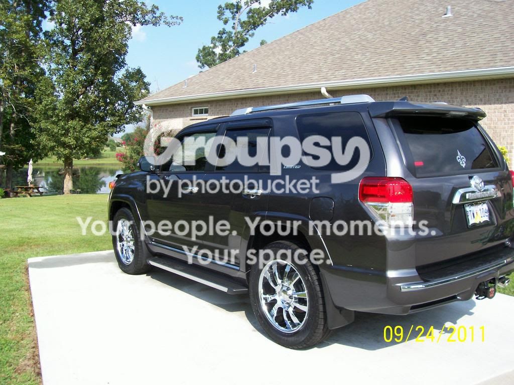

Thanks for the pics. If you get the chance take some pics from the back but so that we could see the whole vehicle.
Still thinking I'll go with the CrossContact LX20's and keep the stock rims,..but those KMC wheels that Renegad44 put on his LE look mighty sexy.

Thanks probos, I decided to add chrome wheels, give it a little bling...
