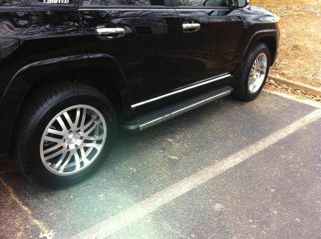

I looked at wheel and tire combinations for months, but the stock 20" are what sold me on the vehicle. I have about 4,000 miles on them now, rotated at my 5k oil change. I replaced the OEM Yokohama at about 2,600. On road, I think the NTG ride better than stock and they don't track the grooves in the road like the stock tires. I tend to drive fast and corner hard coming from a 20thAE GTI. The stock tires came with 40PSI so I run the same in the NTG's. They are good on the highway and I feel comfortable driving 70-80MPH. They are now starting to make a bit of a hum on the highway (only with the radio off), but not too bad for an AT tire. Around town they are quite. Off-road has been minimal, just dirt roads and mud - there is not much open to off-roading in eastern MA. Had them on sand, over-sand roads and they did great; never aired down - I didn't really hit areas that were not compacted by other vehicles. I have not seen any evidence of rubbing either.
Would you take a pic from the back and front "dead center" of your T4R? Maybe from about 10ft away? Want to see how much wider the tires look from center front/rear?
<a href="http://s1166.photobucket.com/albums/q612/4runner12/2012%20Toyota%204Runner%20Limited/?action=view&current=4Runner_2012_011_Nitto_Side_Front.jpg" target="_blank"><img src="http://i1166.photobucket.com/albums/q612/4runner12/2012%20Toyota%204Runner%20Limited/4Runner_2012_011_Nitto_Side_Front.jpg" border="0" alt="Nitto TerraGrappler 275/55-20R"></a>
<a href="http://s1166.photobucket.com/albums/q612/4runner12/2012%20Toyota%204Runner%20Limited/?action=view&current=4Runner_2012_012_Nitto_Front.jpg" target="_blank"><img src="http://i1166.photobucket.com/albums/q612/4runner12/2012%20Toyota%204Runner%20Limited/4Runner_2012_012_Nitto_Front.jpg" border="0" alt="Photobucket"></a>
<a href="http://s1166.photobucket.com/albums/q612/4runner12/2012%20Toyota%204Runner%20Limited/?action=view&current=4Runner_2012_014_Nitto_Side_Rear.jpg" target="_blank"><img src="http://i1166.photobucket.com/albums/q612/4runner12/2012%20Toyota%204Runner%20Limited/4Runner_2012_014_Nitto_Side_Rear.jpg" border="0" alt="Photobucket"></a>
Must admit they look good, are they OK for the thin rim on the LE 20's?
