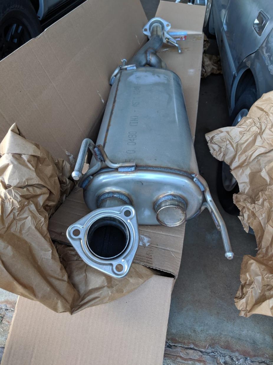

The tailpipe will not bolt up. The TRD muffler has three bolts connecting the tail pipe to the muffler, the regular 4runner muffler has two bolts connecting the muffler to the tail pipe. It would have been nice if Toyota made the parts interchangeable. I would like the TRD muffler with the rear exit exhaust. It can't happen because of the way Toyota made the TRD muffler tailpipe connection.
Adding...... A 2020 TRD Pro exhaust can be swapped out, from the cat back, including the tailpipe that goes straight back.

Theoretically, you should be able to replace one of the flanges, either from the muffler or the non-TRD OEM exhaust from muffler-back to get these to mate. Looking at the photos, the flange appears to be a sleeved unit.
Maybe I’m missing something, but I bought this exhaust to put on my 19.
Unbolted old one... bolted up this one. Fit perfectly. No modifications to flanges, etc. I see zero reason why someone couldn’t take a stock exhaust (from a 19 at least) and bolt it on a 20. Also can’t imagine a difference between a 19 exhaust and other fifth gens. But have no specific knowledge of that. Only that there are zero issues with a 19 fitting.

What I had gathered, someone was looking at the potential of bolting the non-TRD muffler-back to the TRD muffler because they were looking at a rear exit with the TRD muffler characteristics. This is where they highlighted the difference in flanges to make this work.
I just swapped my stock TRDP exhaust with a standard exhaust from a forum member here. No issues with the swap as long as you swap the full exhaust from the muffler back. As stated above, the standard exhaust flange bolts to the tail section using 2 bolts. And the TRDP exhaust bolts to tail section using 3 bolts.

No problems at all. All of the hangers for both exhausts are the same. You just need to take off the right rear wheel/tire and then make sure you get it jacked up high enough that you can rotate it out and over the axle. Theres also a small heat shield that shields heat from the spare tire that comes off with two 12mm bolts.
I thought we were gonna have to drop the spare but we were able to get it out without doing that. We probably had both exhausts off and reinstalled in like an hour or so.
