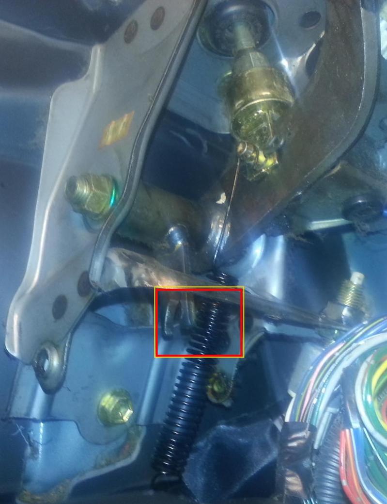

I had the same symptoms last week, which I resolved by replacing the double-coil torsion spring with a suitable clutch pedal return spring, but I'm not completely happy with the results (as the spring I used touches the P-bushing mounting tab when the pedal is depressed).
So I'm searching for anyone who has found a suitable spring that does NOT touch at the one or two points that most other springs seems to touch.
