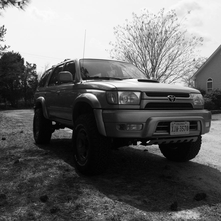

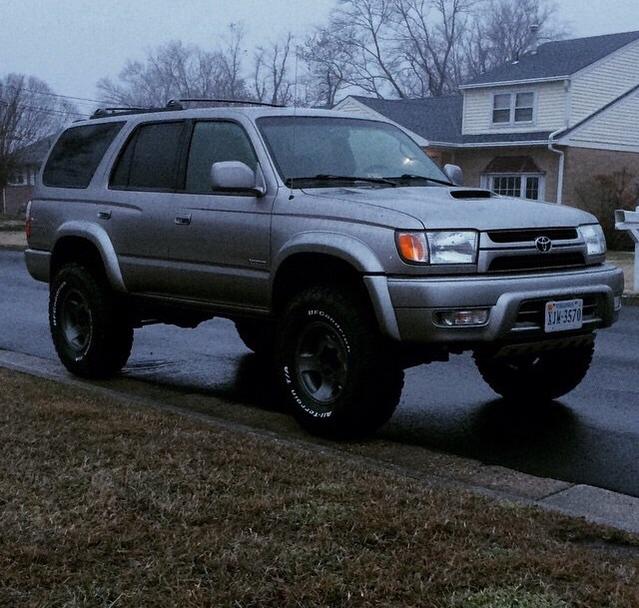

Any lift should be accompanied by an increased track width IMO. I'm lifted 2.5" and with my landcruiser wheels, spidertrax spacers and 285's, my track width is about 5" wider than stock.
I have nothing on my roof and lots of added weight down low in the form of plate bumpers, skid plates, rock sliders, and a winch.
Always respect the fact that lifted 4runners are very easy to roll, both on and off road... ask me how I know
