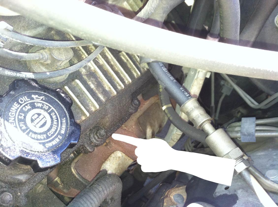

I've been seeing smoke coming from under my hood for the past few weeks. Only seems to do it first thing in the morning, at the end of my morning commute. Doesn't seem to happen any other time.
I think I've pinpointed where it's coming from (shown in the attached photo).
Anyone have any ideas? When I purchased the vehicle in March, I was told at the pre-purchase inspection that the valve cover gaskets were leaking, but I never noticed anything until now. Could that be the problem? Oil level is good. No lights coming on on the dash.

Change the valve cover gaskets. Then I bet your smoke goes away permanently.

Mine leaked like that for years before changing the gasket. I cleaned them up as much as possible and the smoking stopped, but it is still worth the time to swap the gaskets.

Ok before ya spend a few hundred bucks get your 10mm socket with various extensions out and starting tightening the vc bolts, lightly, if ya got a torque wrench keep it to 5in-pounds or less. You'll have trouble reaching the top ones without removing anything, worry Much more about the bottom ones especially on the right side but do both sides. Now that's done, clean it up as best you can and wait. It will take a few days/weeks maybe a couple months But it will end, the smoking that is. Mine was tightened over 4 yrs ago and still holding.... Luck!

Either learn to deal with the smoking (which is most likely oil leaking down and hitting your exhaust manifold, then burning off), or replace the gaskets. As stated, I understand it as being a pretty easy job, though a bit time consuming. Or, find an independent ma and pa shop that will do it on the cheap. I would bet that a small shop would charge around $250ish in total. I still think it would be better to purchase the inexpensive parts and do it on a Sunday in your or a friends garage.

Change the gaskets and pressure wash the engine when done. They are leaking onto the hot exhaust manifolds causing the oil to burn and smoke.

I think I'm going to try tightening the bolts, doing some cleanup on the engine, and then seeing if the smoke goes away. If the problem persists or comes back, I have a couple of acquaintances who I think can do the job reasonably cheap and do it well.
