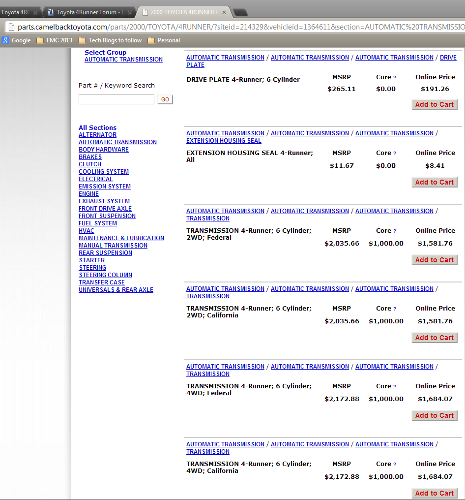

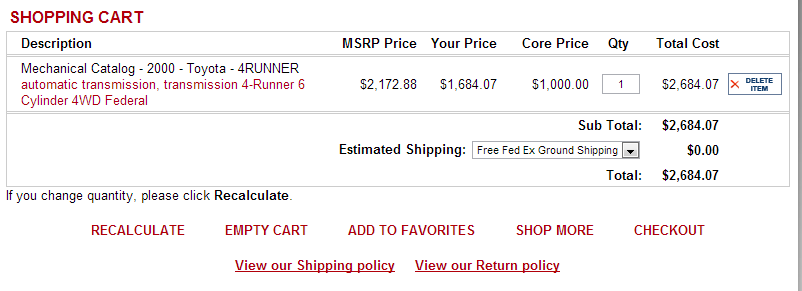

The cost of a BRAND NEW transmission from an official Toyota dealer (CamelBack Toyota of AZ) is only $1700 (4WD) after you return the core. Free shipping and no tax BTW.
So you put the total of $2,684 on your VISA card, pay a local Toyota certified shop to swap the transmissions out. You pay $150 (or whatever) to ship the core back to AZ. With the $1000 core credit minus the shipping you are looking at $1800 - $1850 cost plus maybe $200 to do the swap. So lets call it an even $2000.
I would much much rather have a brand new Toyota transmission than a rebuild. Rebuilds rarely last 5 years and many break again within 18 months.
BTW, my 97 transmission is still going strong with no slippage (knock on wood)!
