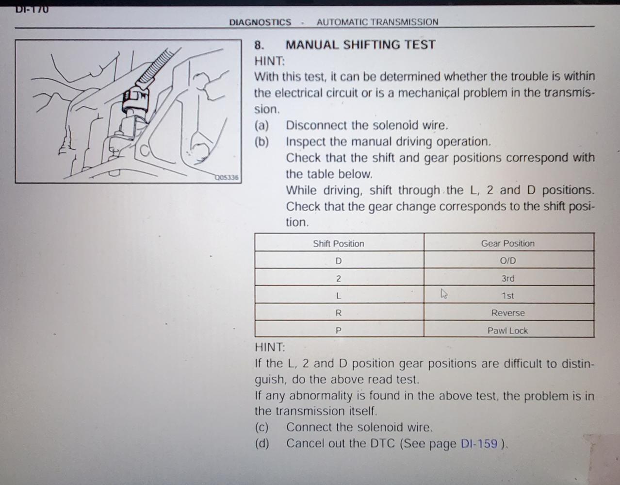

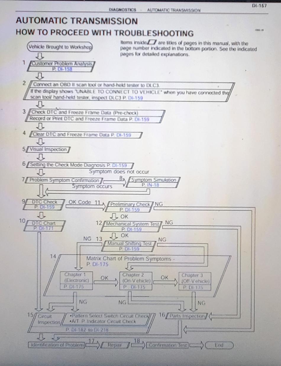

Could be mechanical or electrical - the FSM has complete diagnostic tests to run - here's a couple excerpts.
