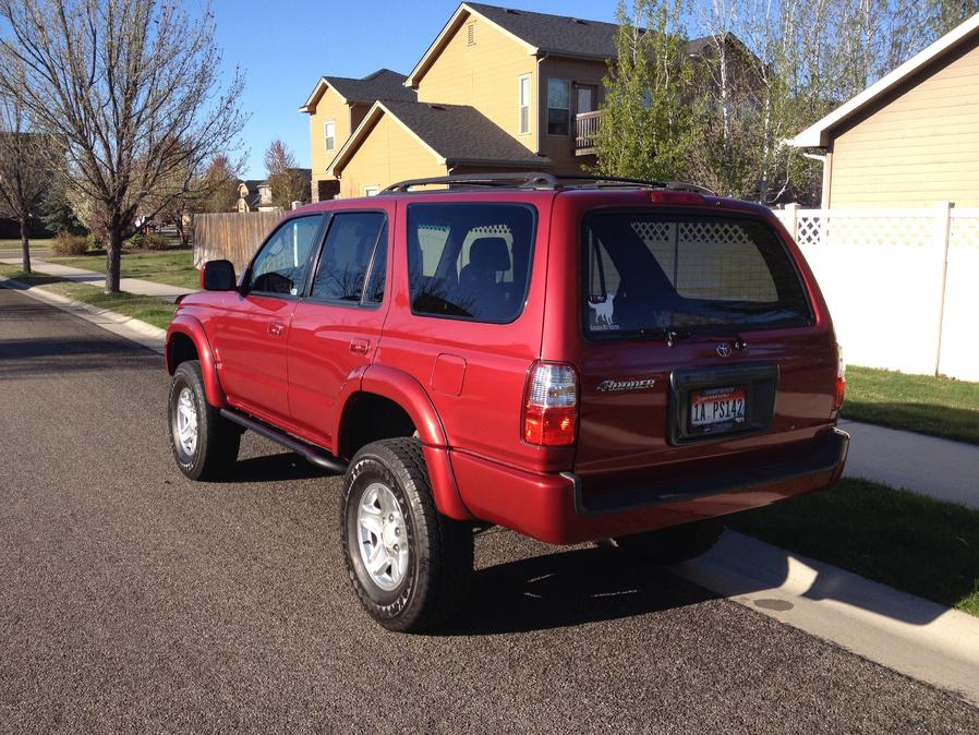

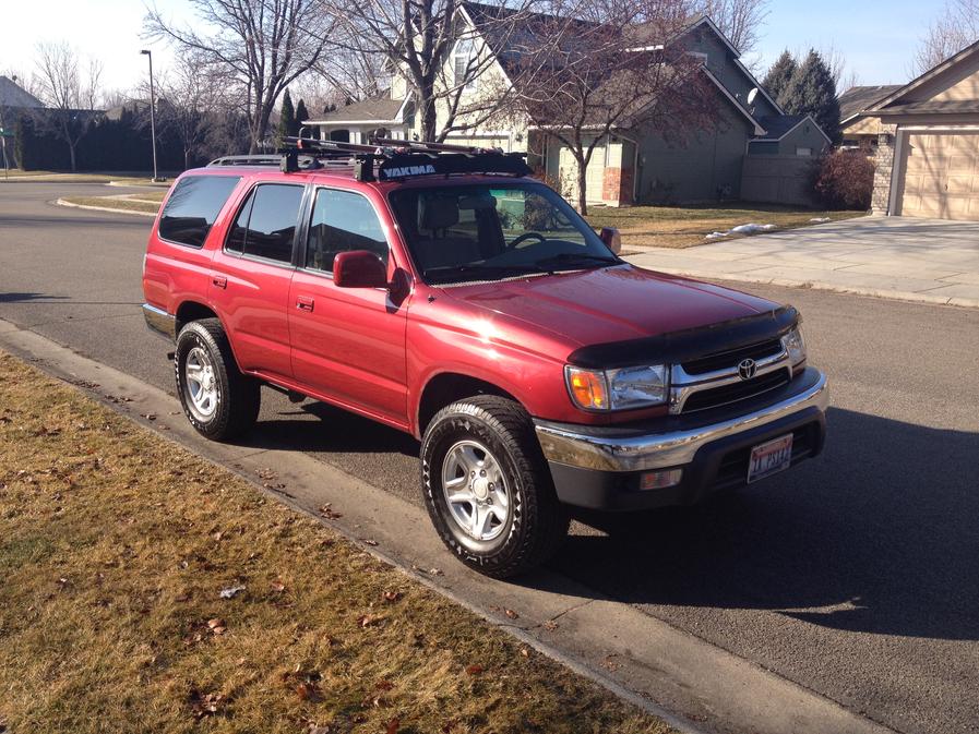

This is what the 4Runner looks like today
In 2007 the we purchased the 4Runner with 75,000 miles on it. I spent the next few years changing the fluids and parts for maintenance.
In 2013 I started looking at replacing the rear dented bumper, Front drivers side fender. After doing some research on this form I decided to start with removing some old trim parts including the chrome fenders and running boards. I loved how removing these tired and old parts gave the 4Runner a new fresh look.

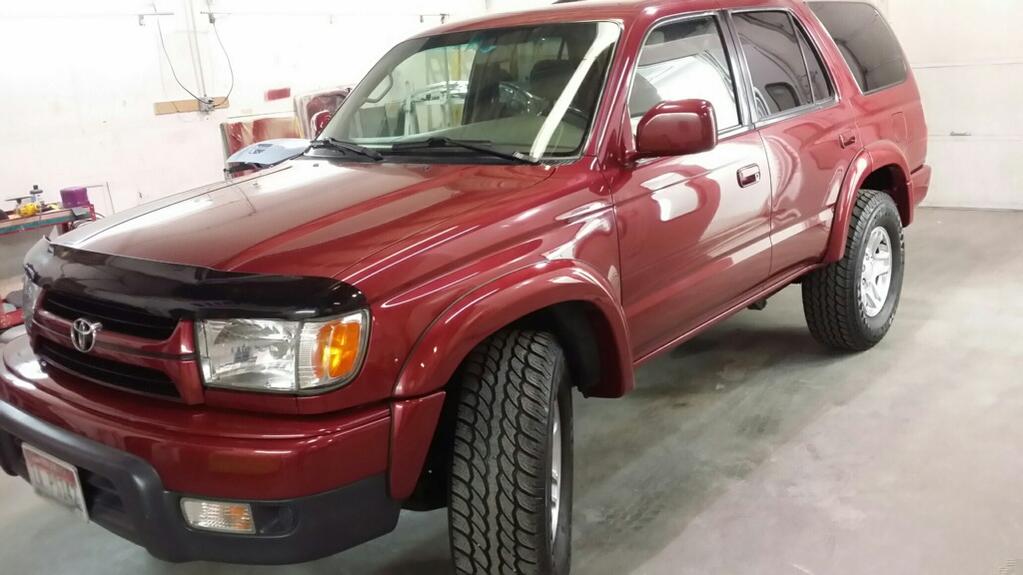

The next project was fixing the damaged body parts. I purchased Bushwacker fender flares, front and rear bumpers as well as a new grill. I took the new parts in to get painted to match the body. I am very impressed the way they turned out.

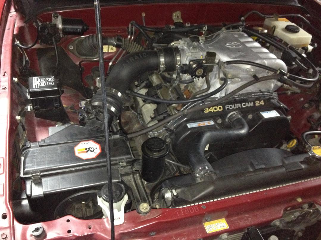

Now for the fun! Next was the ISR and Deckplate mod. This mod gave the 3.4 a little more growl. The filter I used is a K&N including an AIRAID intake tube.

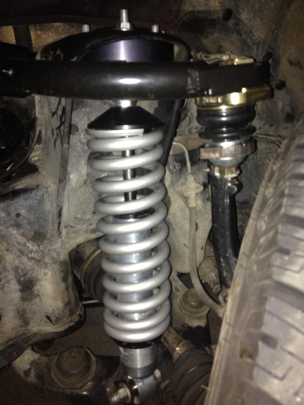

Next was the suspension lift and what was used.
I started with the Toytec Boss Lift:
Front coils 550 Springs
All Pro UCA's
Rear
Toytec Super Flex Coils
Billstens 9602R703
Sonoran Steel Bum stops
Sonoran Steel Diff Drop
Sonoran Steel adjustable Trac/ PanHard Bar

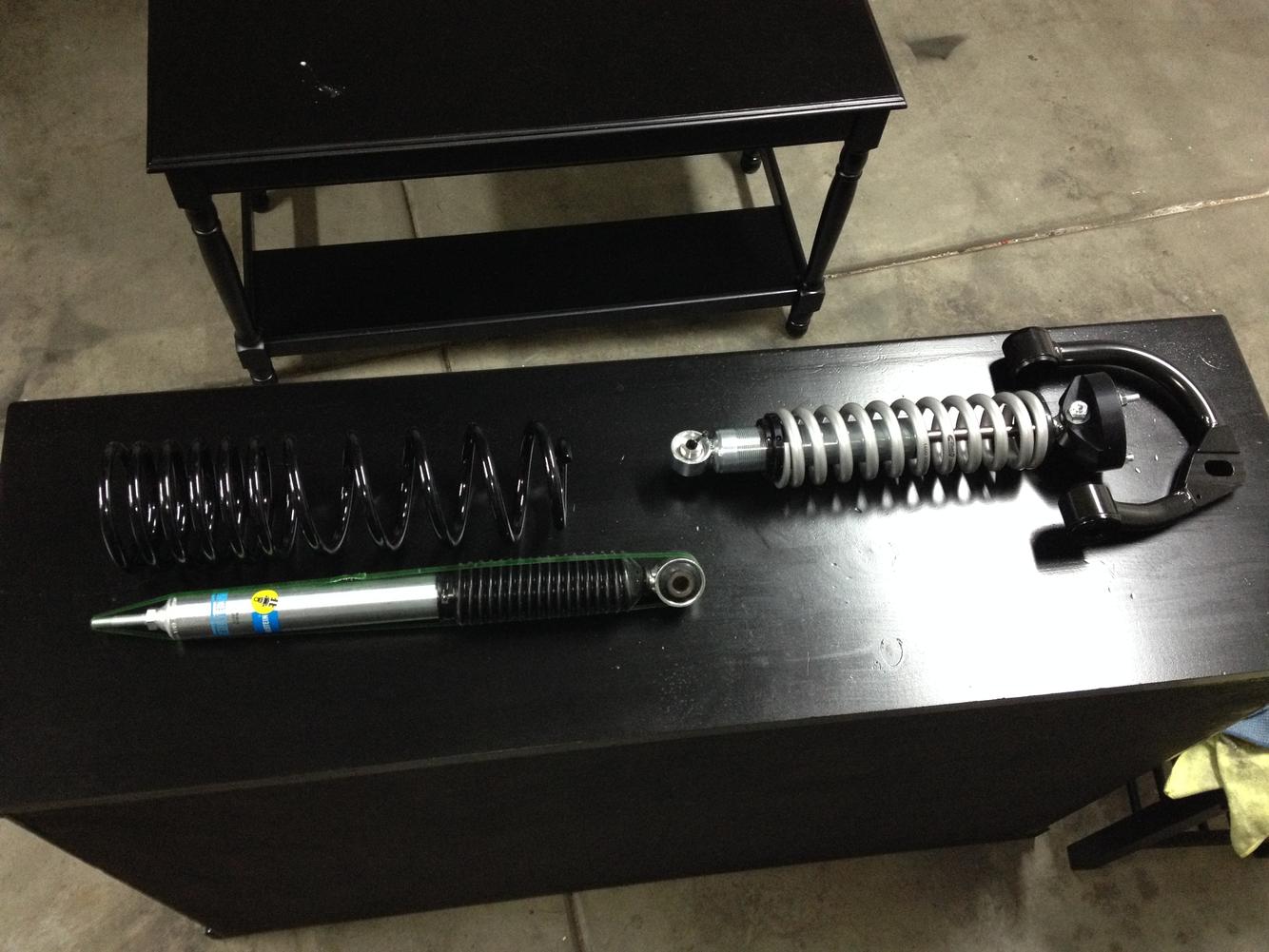

This is what some of the parts looked like unboxed. I could not wait for this!!! fyi freshly painted furniture makes a great canvas for sexy suspension parts.

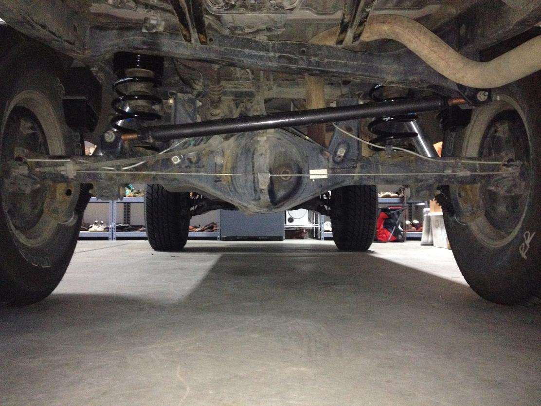

First off what an experience overhauling the suspension on the 4runner. I can not thank my friends enough for the help. For the record I hate the factory upper ball joints :gun5: I take that back the only trouble we had was the drivers side. Enough of that how about some pics.

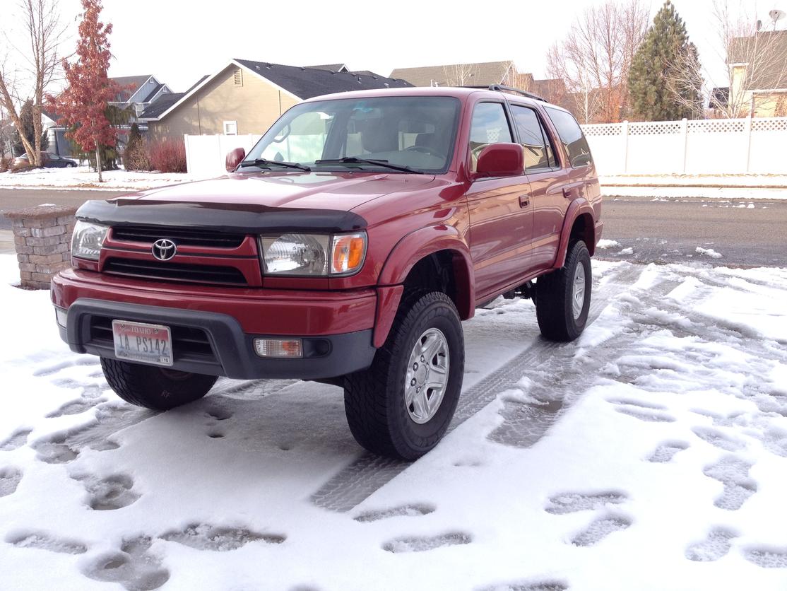

I added some Savage off-road sliders here is a pic after the install.
