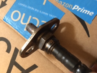

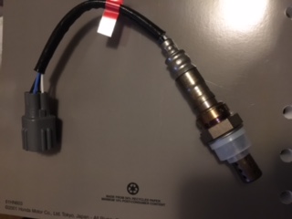

2001 4Runner oxygen sensor mystery
I replaced the rear converter on my 2001 4Runner with a Magnaflow Part # 49579 converter and ordered a OEM Toyota rear oxygen sensor (89465-35580) at the same time. The opening for the O2 sensor on the converter is a oval shaped bolt on plate. The OEM Toyota sensor is a round screw in sensor. When you look at the sensor on any Toyota parts site it shows the oval plate attached to the sensor, but the one I have does not have it. Toyota said this is the correct part and they have no idea about the plate, but they even show a gasket that goes under the plate. Magnaflow said this is the correct part for my 4Runner.
Any ideas?

The OEM Toyota one I ordered is the screw in sensor in the right side picture, the sensor in the left side picture was to show what my magnaflow converter needed as the converter is already installed, I should have been more clear on the pictures.
The confusing thing is that Toyota shows a image of the flange sensor in the parts break down for the rear sensor and they also list a flange gasket and two nuts for the rear sensor.

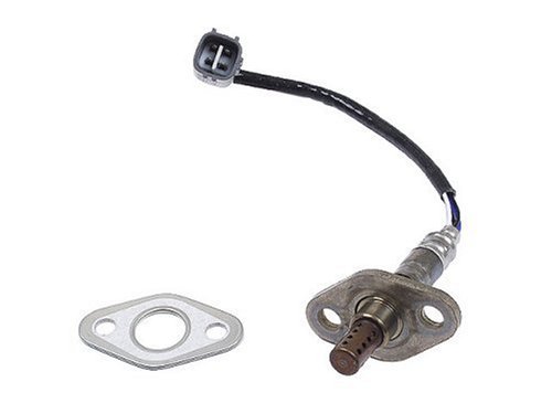

https://www.densoproducts.com/product.aspx?zpid=18115
https://www.densoproducts.com/product.aspx?zpid=18213
You can see the plugs and specs are the same. The wire length looks like it might be longer on the '99-'00, although that should not be an issue. Just ziptie it if you have to. I can't absolutely guarantee it will work, but it's what I would do in your case. Worst case you can always install a URD Sim if it sets a P0420 code. With a Magnaflow or any after market cat, you will probably end up there anyway.
I use those links because the pics are better than Amazon, although I would buy wherever you get the best deal on that Denso p/n.

it looks like the first one unscrews from that flange.
Just a follow-up on this-
I purchased the Denso O2 sensor that kball suggested to try. This one was made for the 99-00 models and worked with the Magnaflow flange opening. No problems at all, runs great and no codes.

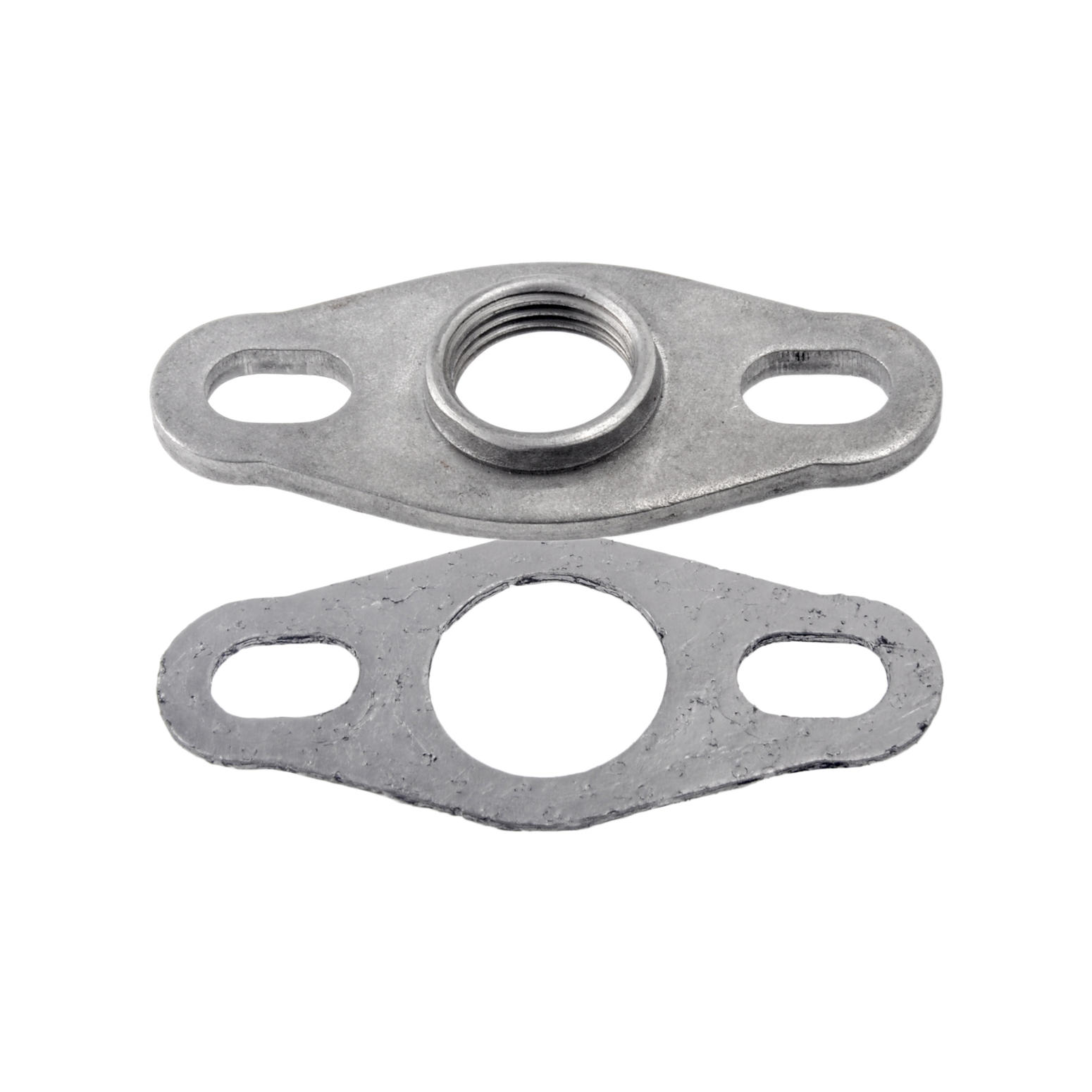

I also found this
SGF1 Oxygen Sensor Mounting Flange Bracket With Gasket (44mm) for Toyota Lexus
SGF1 Oxygen Sensor Mounting Flange Bracket With Gasket (44mm) for Toyota Lexus | eBay
that would have let me use the correct sensor for my 01 4Runner.
