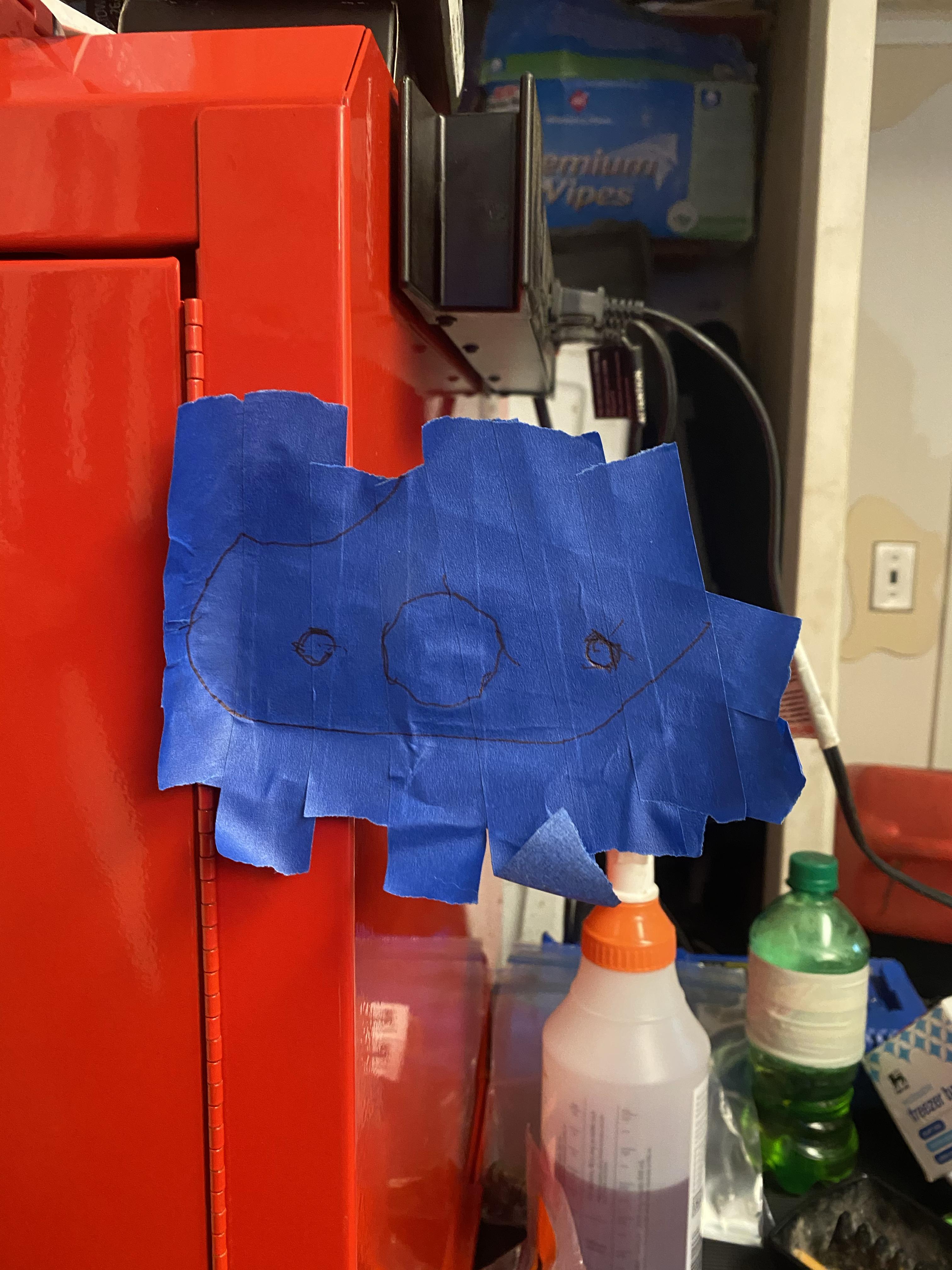

I think I might be a day late and a dollar short; but for my swap, I traced the clutch master mount on the firewall to transfer it over.
You are, but its good info for other people viewing the thread. Cutting those holes definitely could have gone more smooth. Thanks for the picture.
When I cut mine on my 97 limited it was even worse than what y'all are dealing with.
A previous owner had run wiring for an amp but for some reason drilled an almost 1" hole for it. It was right where i needed the CMC to mount and offset.
Luckily I was able to cut it out but not the way you would think.
I used the gasket to trace best I could and then used a very small drill bit to drill the outline- something like 15 holes around the edge of the hole. Then just got progressively larger drill bit until the holes overlapped.
