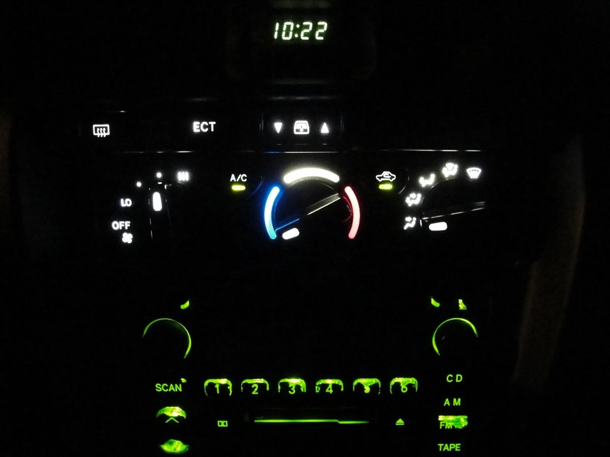

are you sure it's 01? my 01 has a different A/C climate control panel. look at photo. mine was built 12/00. perhaps the panel is going bad.
OP has a limited with electronic climate control. You've got SR5 01thunder. I wish my limited had the basic turn knobs to be honest.
