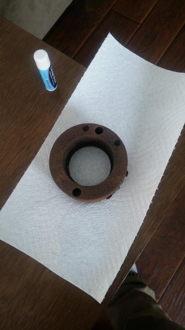

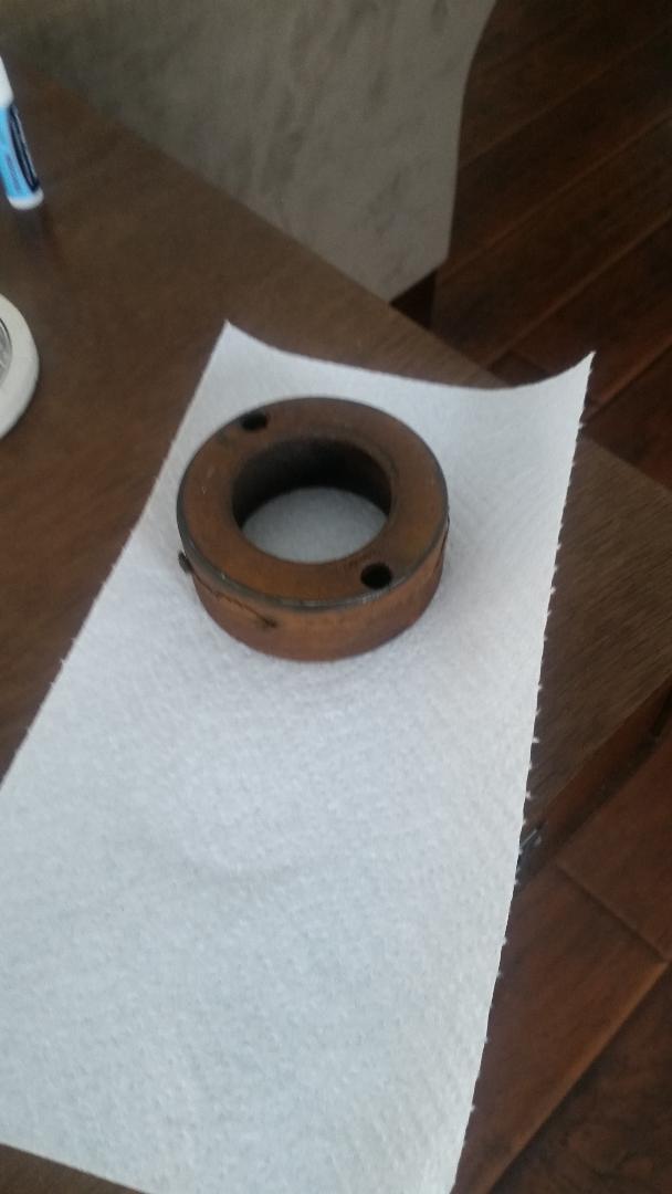

Hello,
I'm not much of a car guy and know very little, but have enjoyed this forum for information and ideas.
Today my 2002 was making banging / grinding noises as it warmed up. I looked and saw the fan was hitting something and stopped the engine. I was able to pull this piece from what I have learned is the crankshaft pulley, but not sure if it is the pulley itself or the balancer or what. I drove the car around the block and it seems fine, but i don't think I ever went of 20 MPH. I don't feel an bolts for the two holes and this was loose inside the pulley, i.e. it wasn't a snug fit from the outside either, there was enough room for it to pitch forward and hit the fan.
How bad is this? I had a tune-up and timing belt changed about 6 months back and have had no issues. But wanted some unbiassed opinions before bringing her in.
Thanks,
Mike
2002 4Runner SR5
86,500mi

Bolded is a red flag here. Something killed that HB, mileage is not enough for it to wear out. I have 180k on mine. Another vote for insufficient crank bolt torque. You could have a damaged crank nose or at least a wallowed out keyway, which is not good.
I hope I'm wrong.
