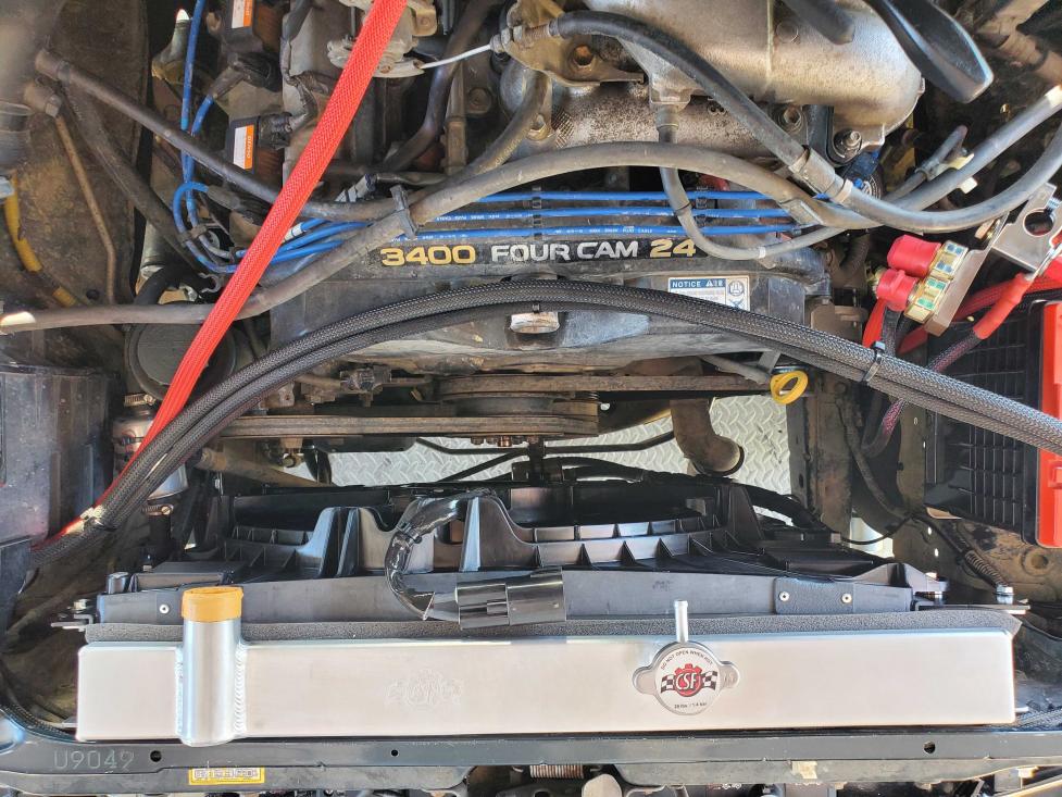

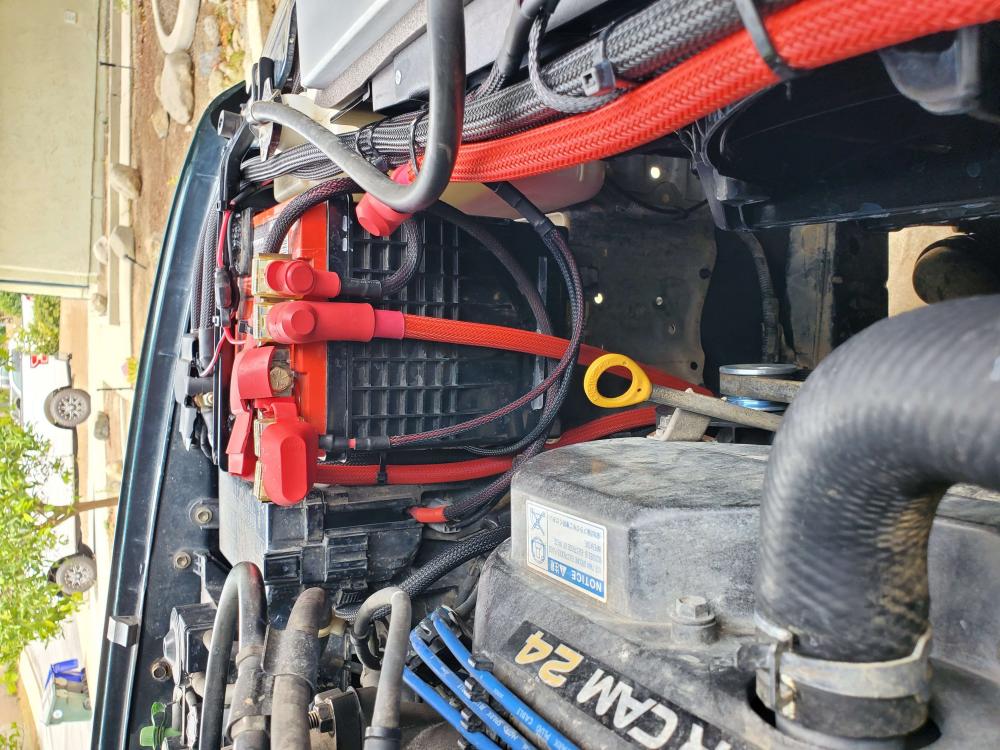

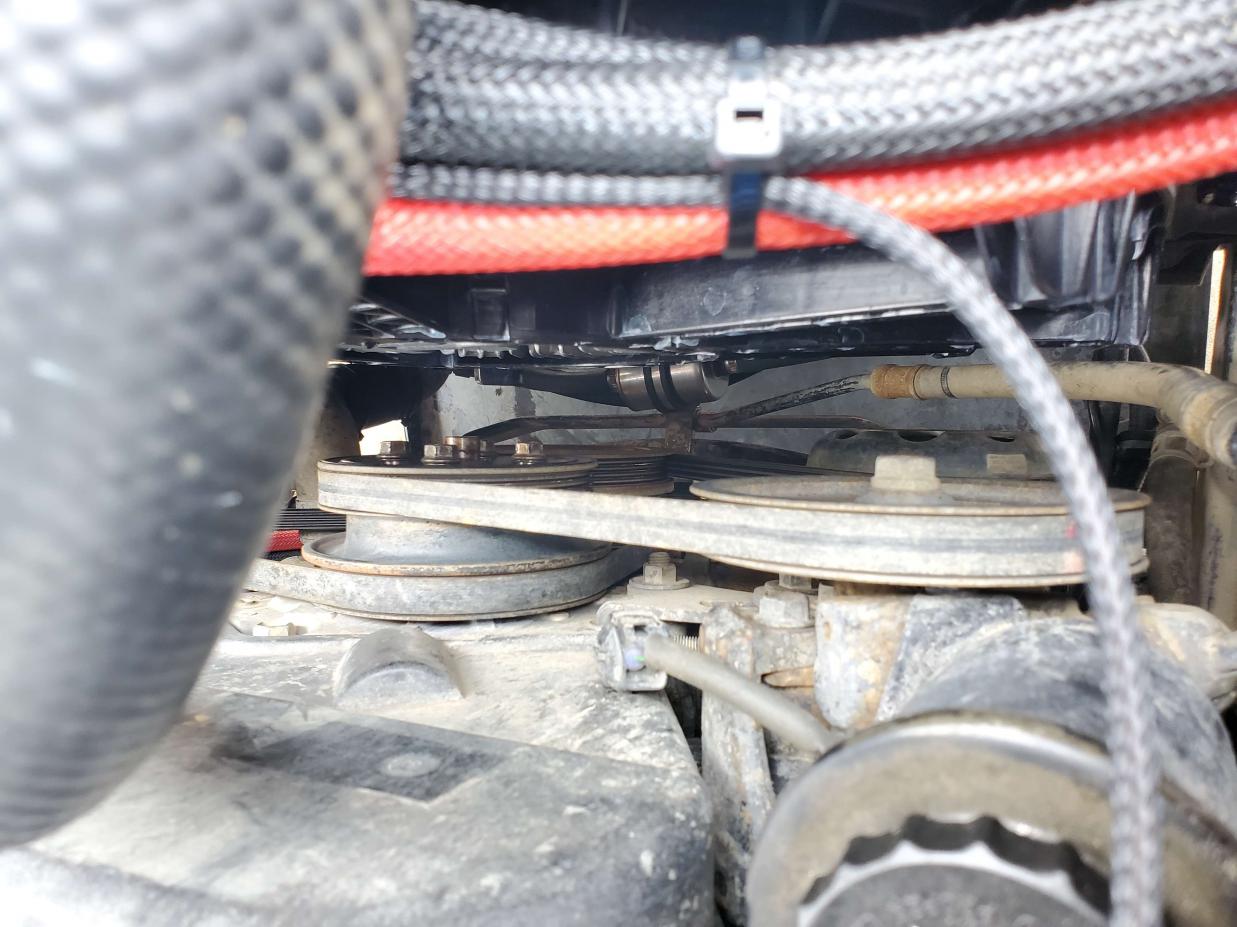

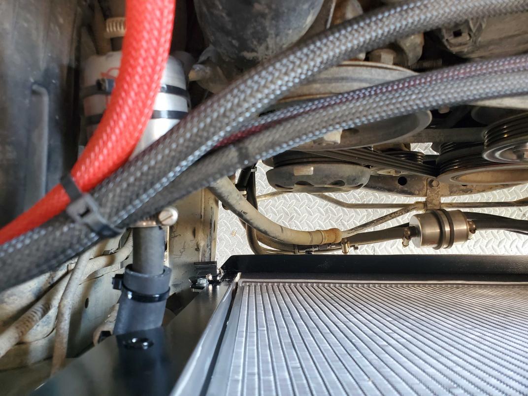

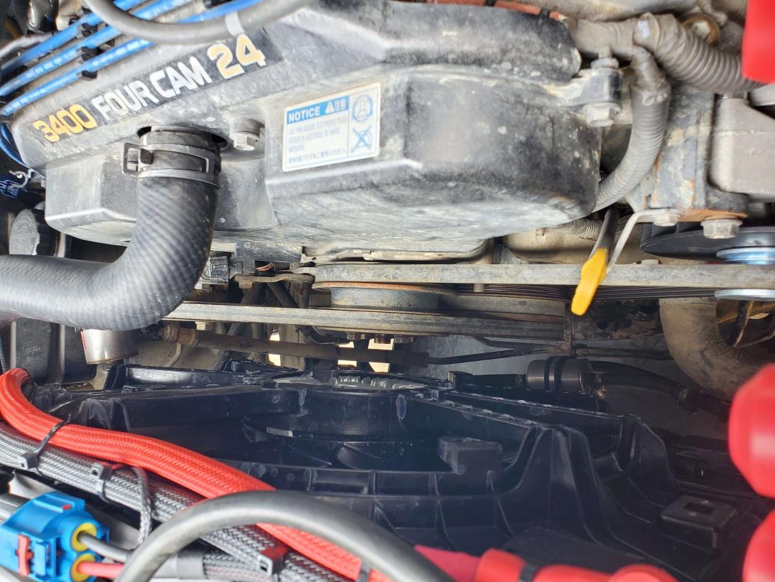

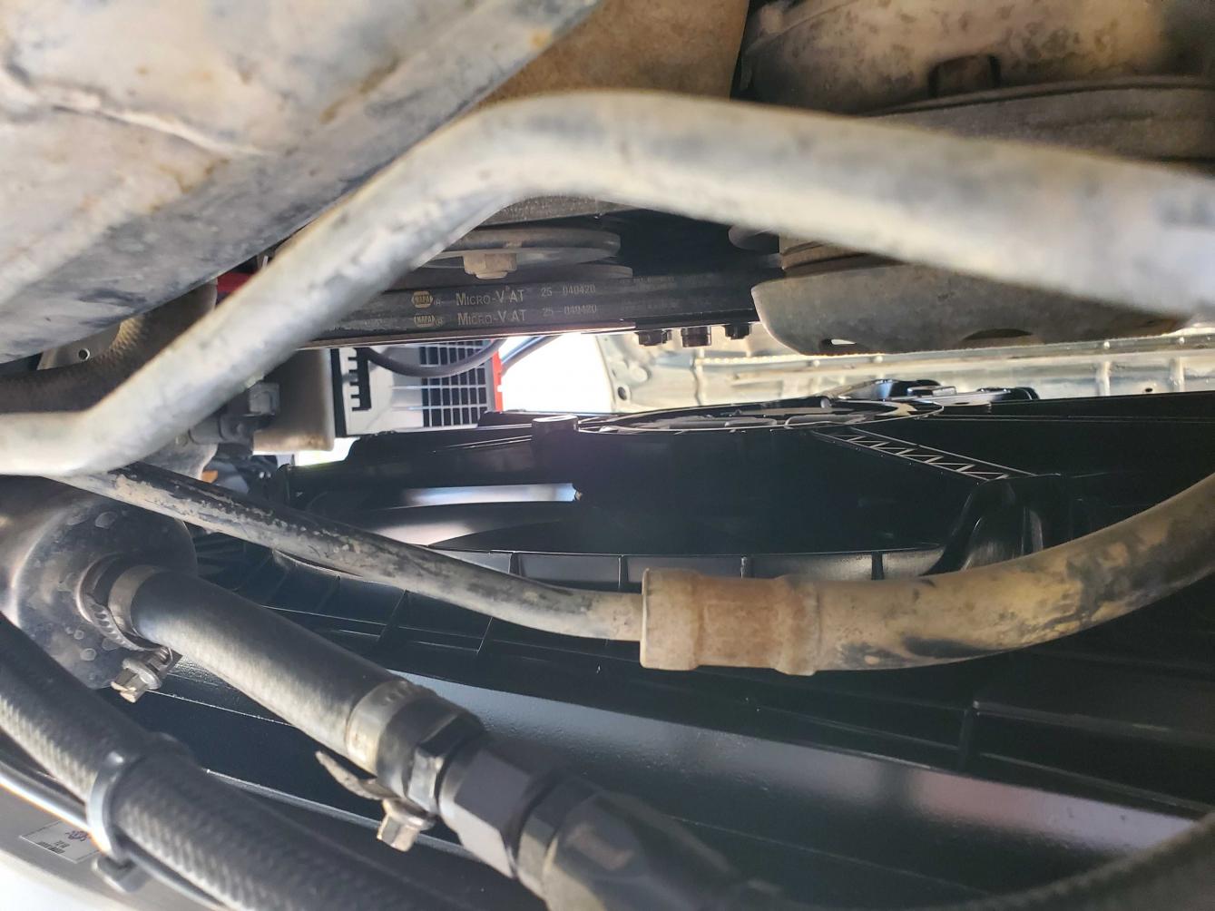

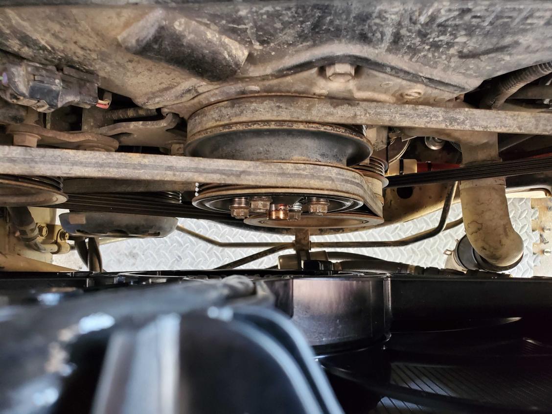

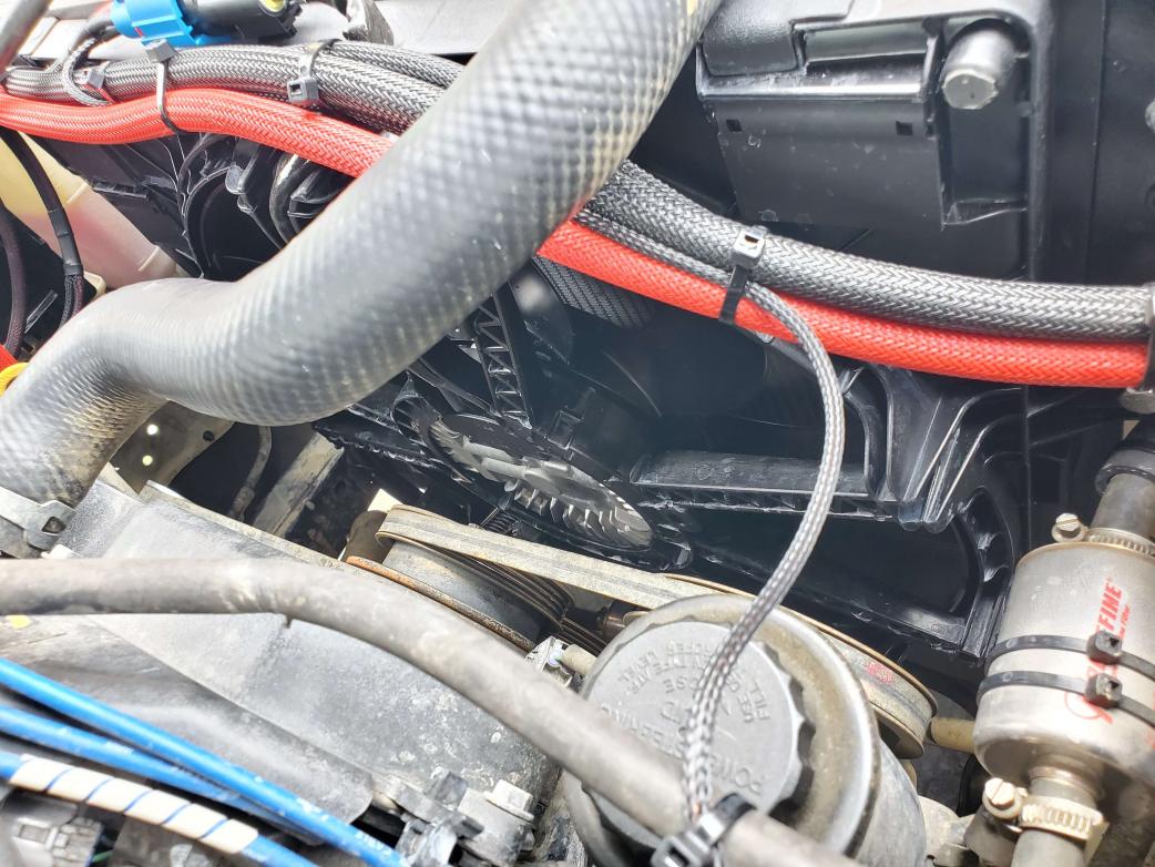

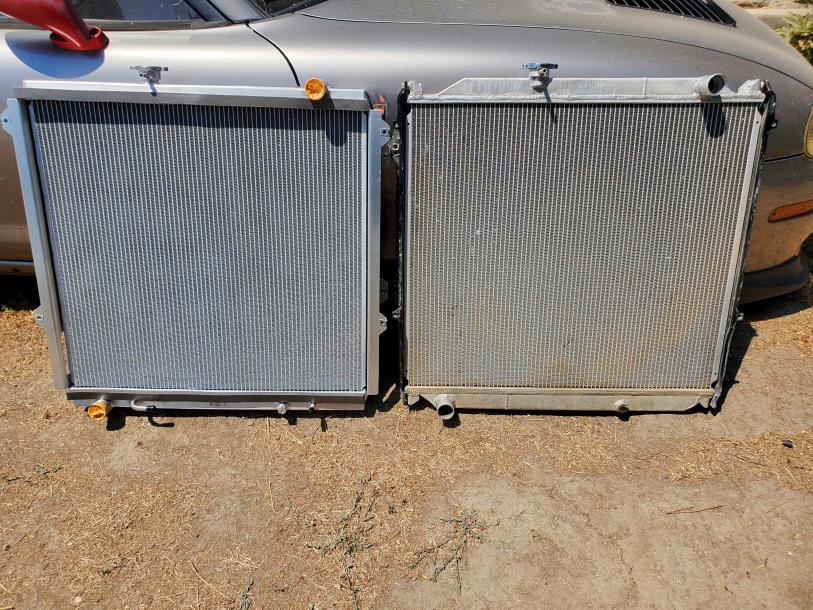

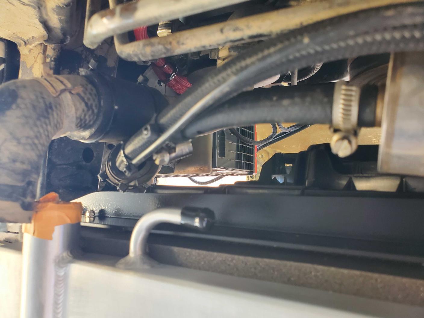

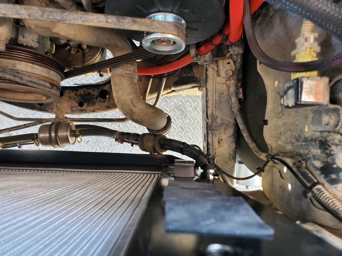

Ok so progress has been made today, got the csf radiator in. It's massive compared to the koyo. It looks bigger then what the specs I posted in the 1st post. The csf doesn't have the ears like the oem mounting, but it's not hard to install. Start with the top bolts first. Well there was some strange stuff going on in the neighborhood so I was a bit distracted and forgot to put the sealing foam on the shroud. Of course I filled the system with coolant too, 2.5 gallons.so I have to remove the upper hose and reseal the shroud with the foam I forgot. Sigh. Wiring should be quick. I do have to move my winch master switch, but have a good location for it. Between the grill and top radiator support.
See pics for clerance of pulleys and other stuff. Was going to eliminate the whole fan mount, but forgot there was 2 belts on it and didn't want to spend any more time or $ to figure out what belt I needed. The fan clutch base is 6mm thick and it a m8 stud. So some spacers for that should be here tomorrow. Fan controller will be on top of air box. I'm tired and pie eyed and hungry, so enjoy the pics.

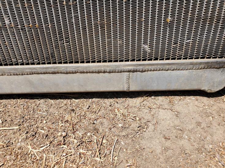

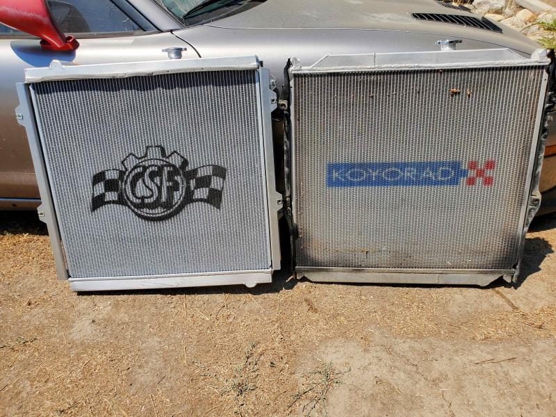

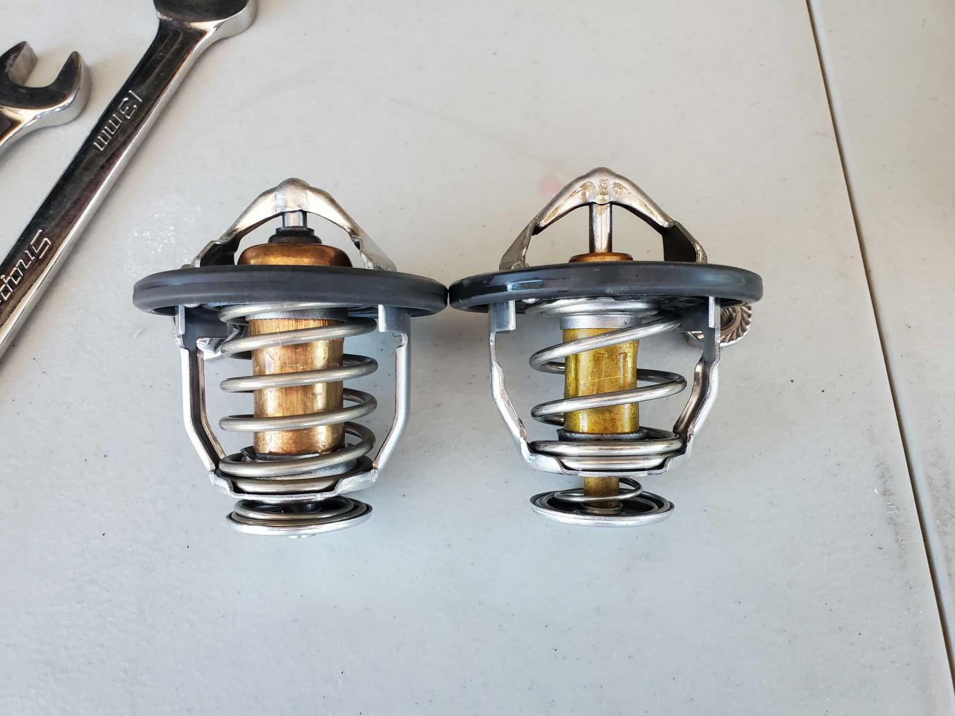

Pics of radiator. And one interesting thing I found. Since I was due for a coolant swap, I changed the t-stat too. Be careful where you get toyota parts from. I don't know where I got the t-stat I took out from. But the replacement is from toyotapartsdeal. com. Look at the difference, and the new one is stamped with teq. New one is on left. Also, yes the csf has massive end tanks compared to the koyo, but it's the core size that matters.

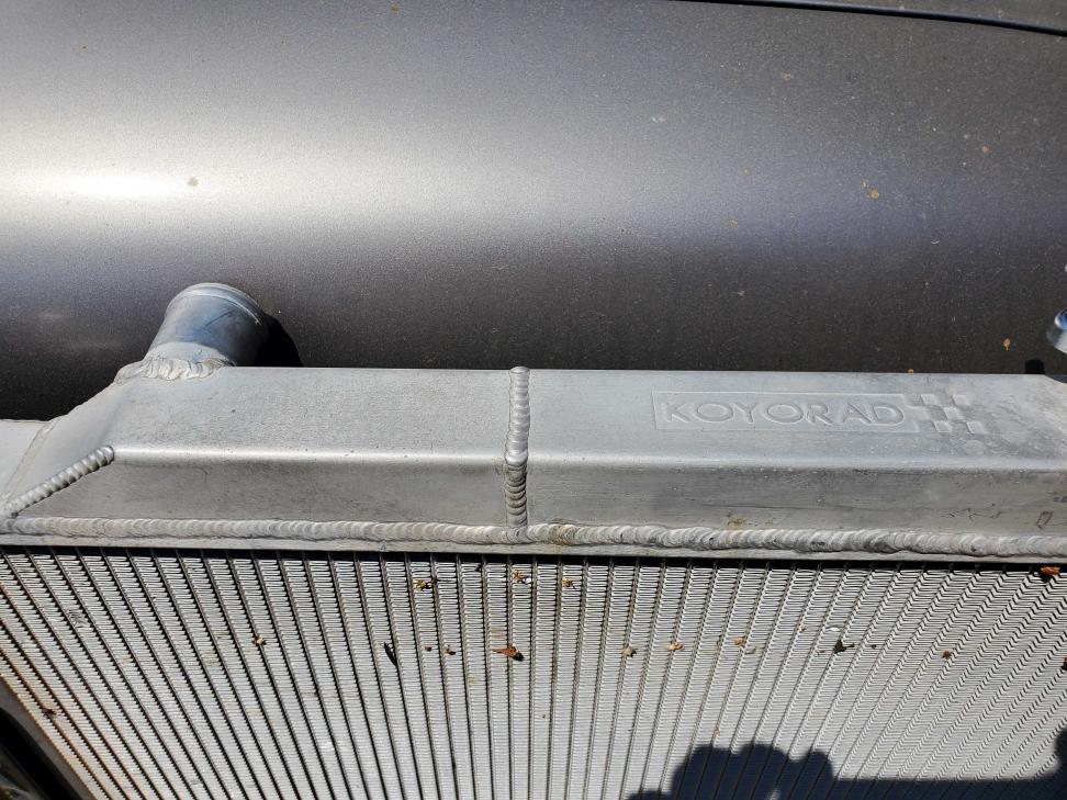

The koyo is 100% a triple pass radiator, see the division welds. From what I have read regarding triple pass rads is that you need a high flow water pump. Much higher then stock to use the rad correctly. A dual pass can function correctly on a stock pump, a cross flow radiator would be awesome too, but custom rads are serious $.

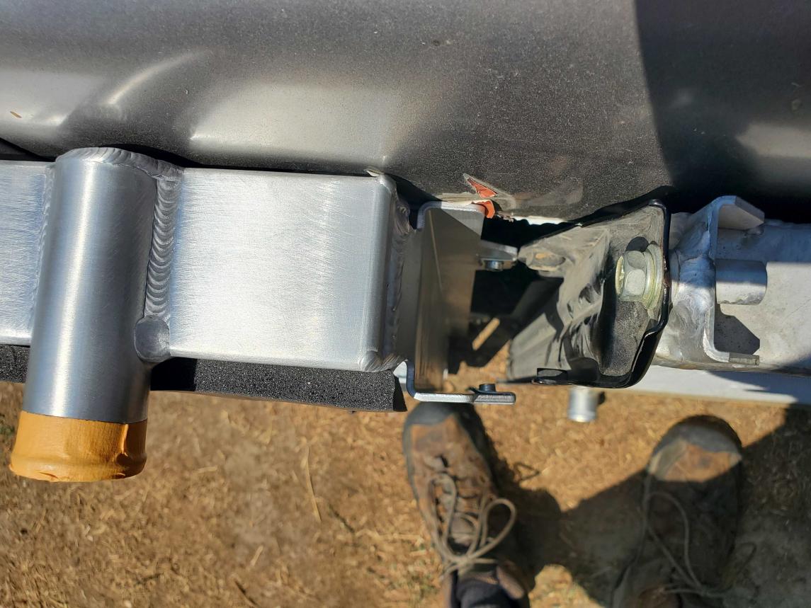

Two things I do not like about the csf for sure: the top hose hump, great place to trap air. Second is the non oem mounting system, sure you can squeeze a row or two more tubes but it's really odd and leaves a gap that air can bypass the actual core. Which reminds me I need to run a bead of silicon to seal that up. They didnt need to make the width of the mounts that wide. So if you use the csf with oem shroud and fan, it will push the shroud further behind the fan. That is a bad thing. There needs to be a % of shroud depth vs fan clerance. It may be 1/4 inch or more thick. Think air is lazy, any area with no resistance, it will take that path.

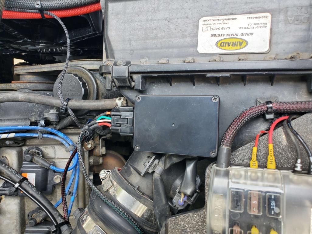

Alright, figure I'd update with a bit of info. Got the foam sealing redone today and finished all the wiring for the fan and it's controller. Did the fan test to make sure I have all the parameters correct. Then I set out to "learn" the widget man's fan controller (will describe later).
The fan test has 2 modes. Switch 7 on, sends the fan to 90% of its power. Let me tell you it does, and it move serious air, more then a fully locked up fan clutch. Downside, pulls nearly 75 amps iirc. So to my knowledge there is no alt capable of putting out that amperage at idle. So I had to raise the throttle to get it the proper juice. Good news is, there is zero reason it should ever go on full blast unless you are testing it like I did (and what I'll describe later).
Switch dip switch 1 to off and the fan will drop to the slowest speed possible. It did. So I have all the correct dip switch settings. Fantastic.

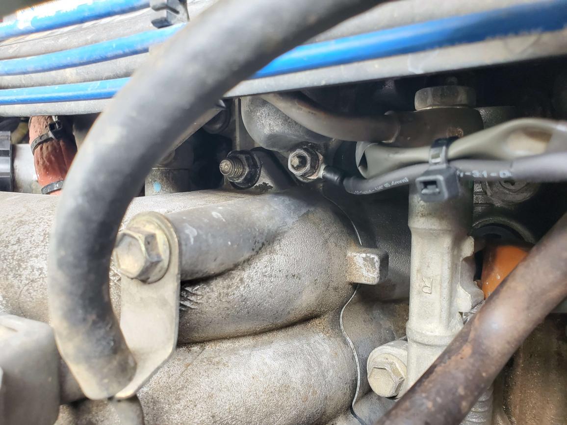

So sorry for the wall of text. I'm going to switch to the widget man's RTD (FPMS) temp sensor tomorrow and bolt it to a stud on the upper water neck. Then go through the relearn process again. Looking at the rtd's temp to resistance to 5v drop between middle of 185 and 194 (190 on my scangauge) ~1.115v and 203 .96v should be close to 130mV drop. It should work. I'm afraid to set the max on speed anywhere near 215-220. But then again when I did hit 220 the dash temp needle was still dead smack in the middle.
One other note, the new tstat works 100% better then what ever I had in there. I mean, scan gauge hit 188 and the tstat was already open. Never had that happen before. So that is where I'm at now.

The RTD's output is nice and linear. No big voltage drops or shifts. Even better thing is if you use widget man's fan controller and the RTD sensor you can mount it virtually anywhere on the engine. It maps a custom tempature profile (pwm to send to fan) between on point and max. When it was doing this you can hear the pitch of the fan changing. After a hour, it had a profile and was steady.
So, to sum it up. It's working good as it sits now. I will test drive it tomorrow to make sure it is all working while driving etc. I misplaced my amp meter, but I want to see and update this thread with amp draws. I know when it soft starts and is at lowish speed it drops the voltage .1v (14.5v to 14.4v at battery).
I'll do periodic check ins to update how this is working. But a short rundown of what I have as of now:
6th gen camaro ss pwm fan
Widget man's pwm fan controller
Widget man's FPMS RTD sensor in NTC set up (voltage drops as temp increases)
90a fuse for fan
8awg wire for fan motor, direct to battery, no relay needed due to soft start
All other wire is 16 awg
RTD wire is like 30 awg so I adapted it to 20 awg then 16awg.

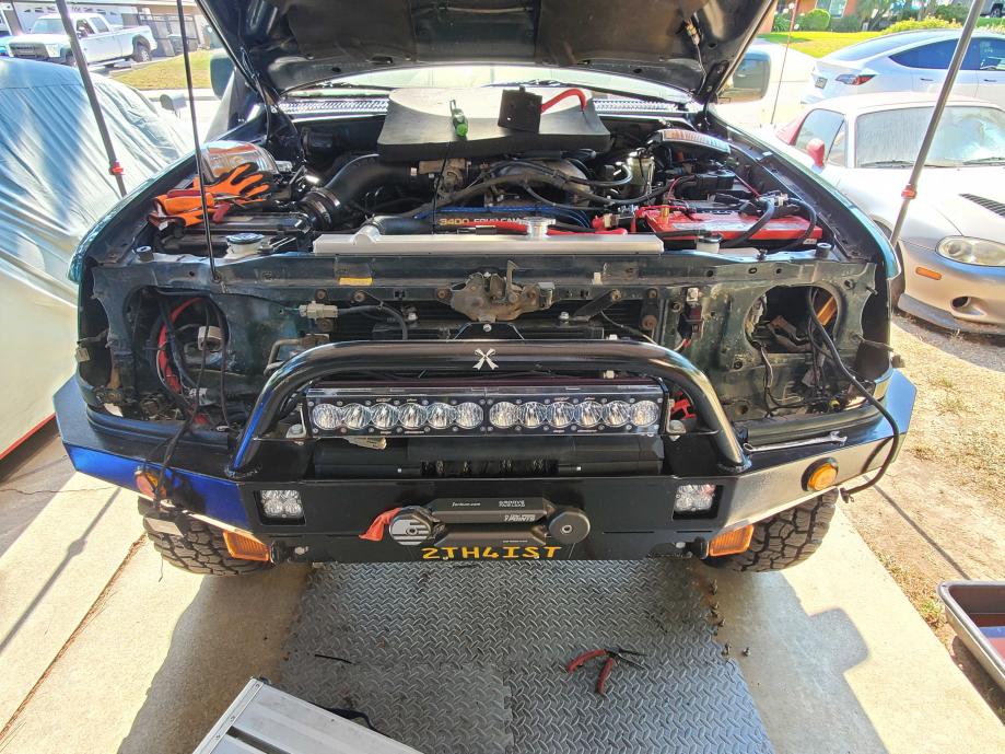

[MENTION=222826]clearock[/MENTION] yes I have a pic. I'll post it here. Well I didn't have an issue with the stock set up with all the stuff in the way. The electric fan had no issue pulling air through the cooling stack, I'd venture to guess about 10-20% more air then the fan clutch. Dead serious this e fan pulls massive air! Also the 6th gen ss camaro this fan came off of, it's cooling stack is 3-6 inches thicker then mine. Also everything is foam sealed. Forces air through heat stack vs around. For testing, I ran 2 weeks without the front light bar in front of the grill. I saw zero difference in temps, both on street and freeway. The first pic is what I had to take off to get to the lower radiator bolts. That or take the bumper off.
The issue I'm having is that the fan stays on when I'm driving at speed. Which in turn causes a sort of air lock. I can set the trip points for the fan higher, but then my engine temps will be higher and when it hits that point the fan will come on.
The csf radiator is substantially thicker then the koyo, but the csf is a single pass radiator while the koyo is a triple pass. Im wondering if its not letting the coolant stay in the radiator long enough to cool off. But at idle the e fan had no issue cooling the rad as did the fan clutch. It could also be the new tstat I put in. Since spring weakens over time the old one I had could have been opening wider and letting more coolant flow.
That's where I am at now. I did a bunch of drive cycles yesterday night and today. I'll check in the morning if the air pocket is out of the csf radiator. (Pass top, as the inlet hose is higher then the filler neck). I'll also contact a few of the pwm controller companies and get their opinions too.
