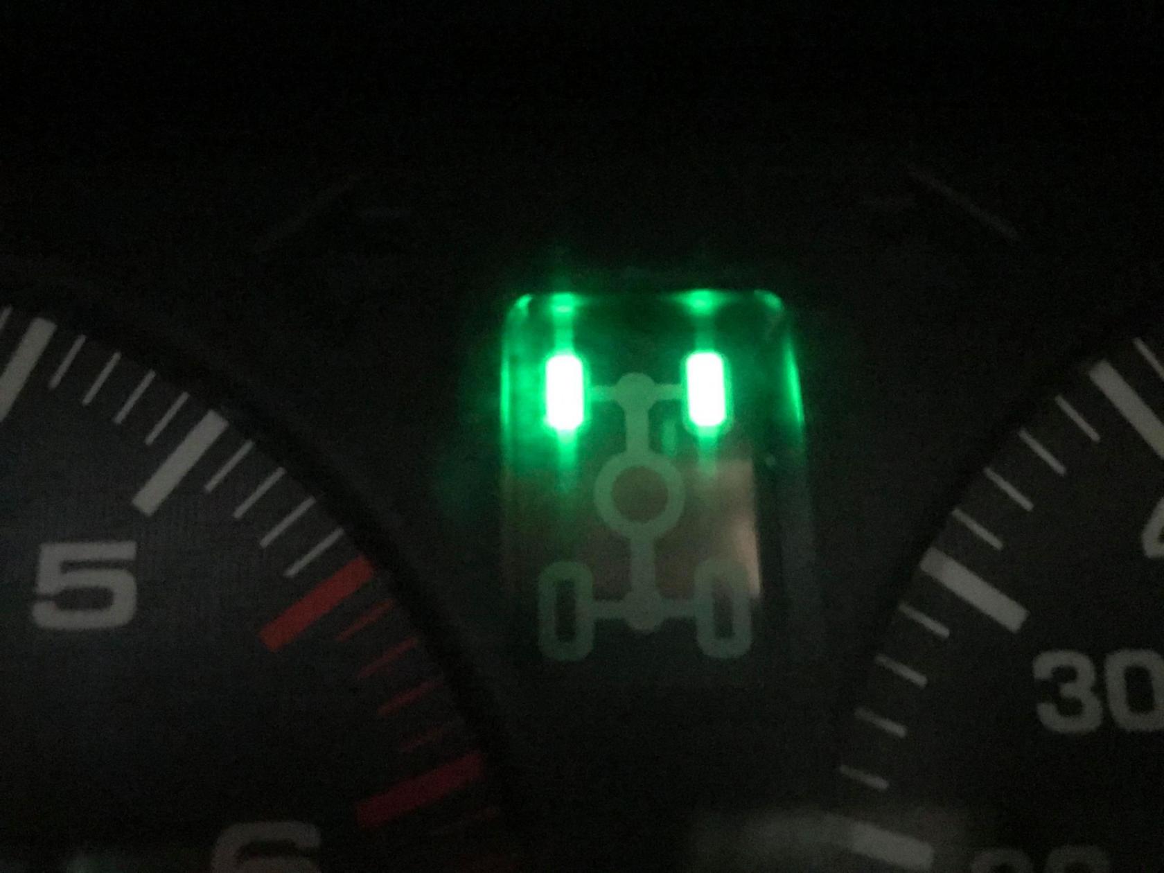

So I did some bulb swaps while I had it apart and now my other set (upper) of 4wd lights(wheels) work. And my D symbol (Drive) now works. Funny –but I have no idea how long the D has been out – nice to have it back. So I truly did have just a bulb issue and not a 4wd issue as I initially thought. I like bulb issues. Lol

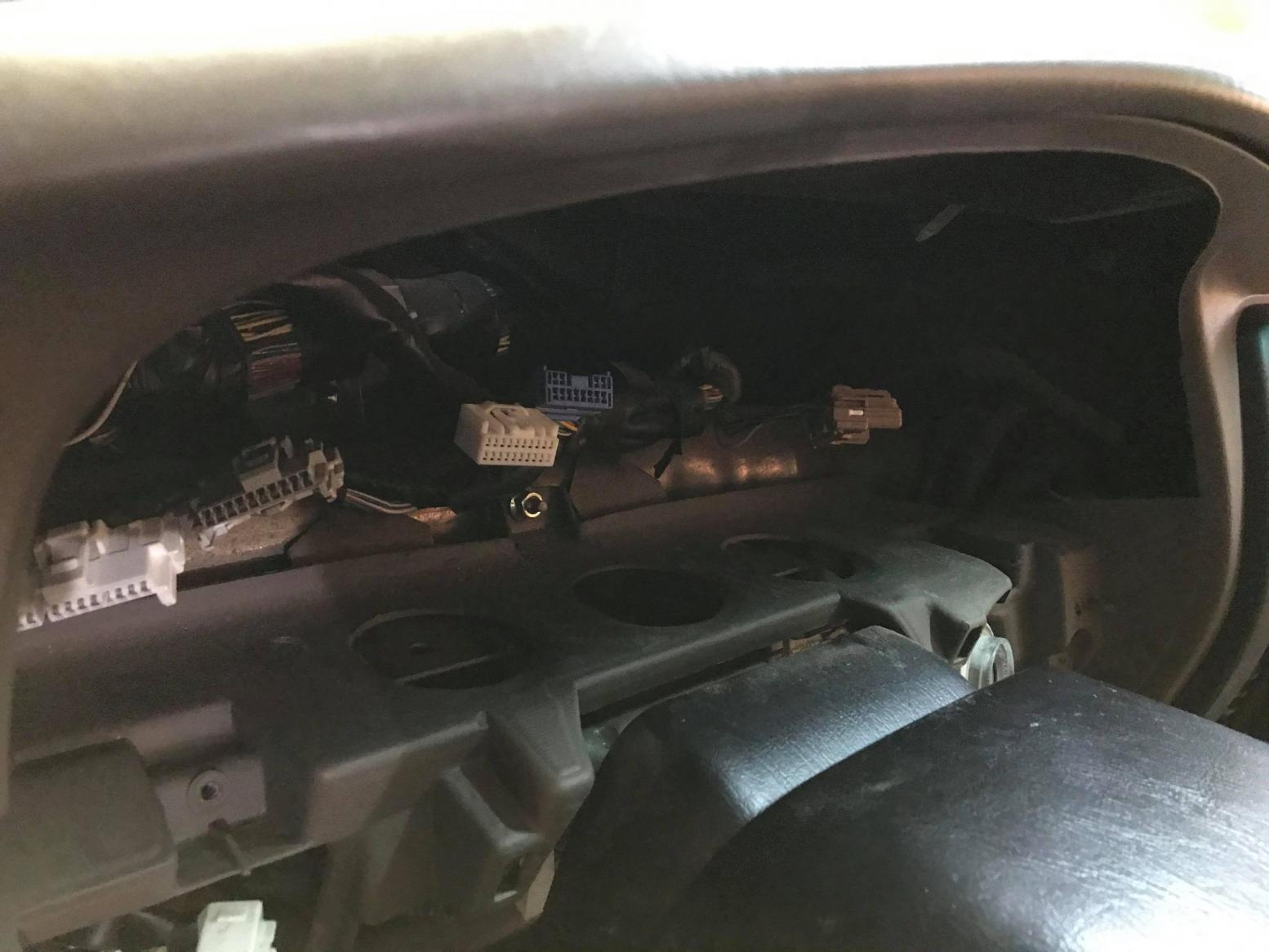

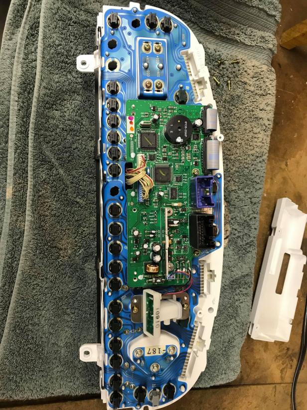

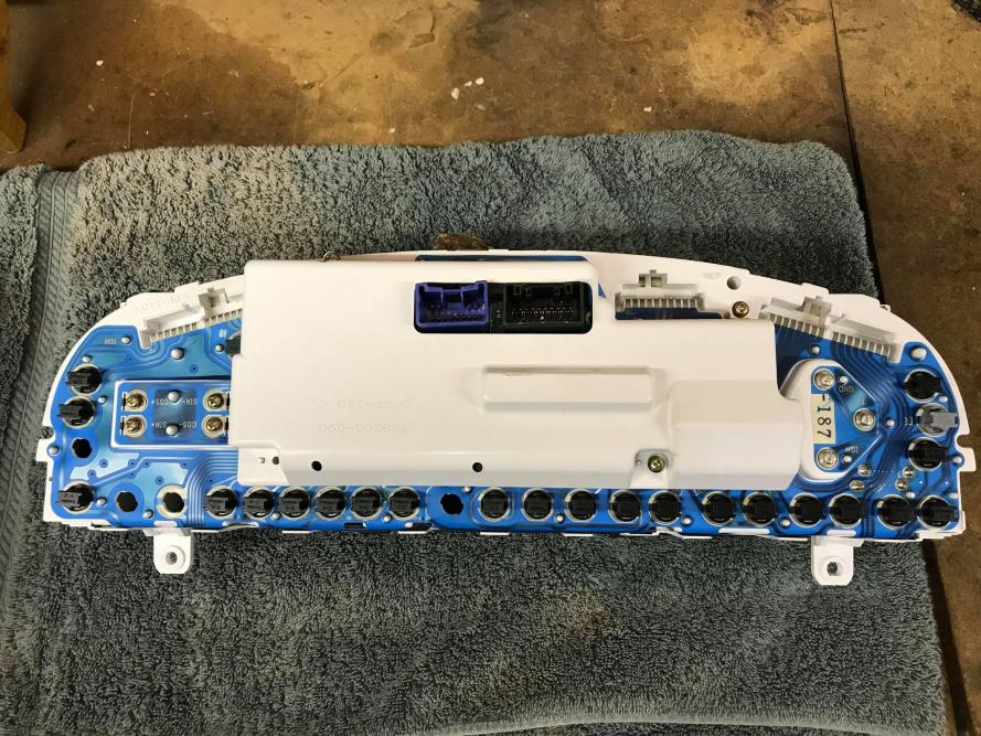

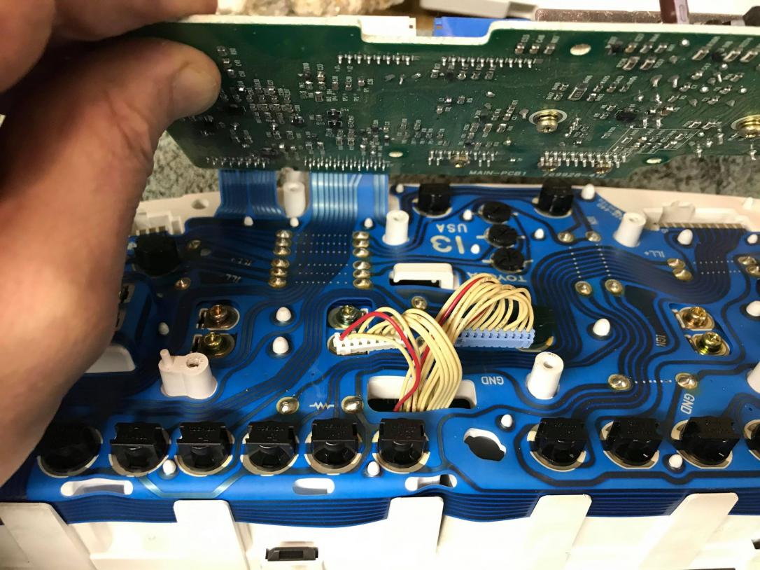

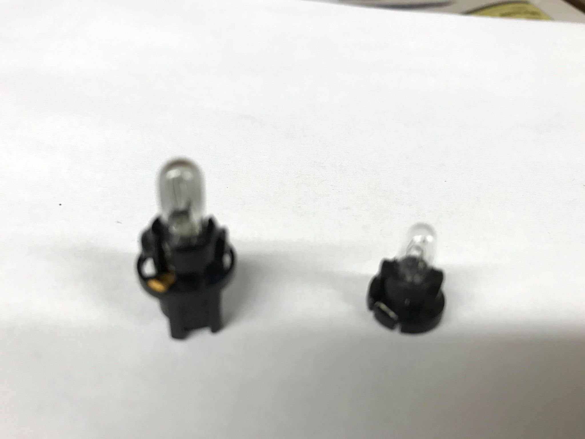

Posting a few pictures.
1. First one is my working upper 4wd lights (before it was the bottom)
2. Second is the 5 disconnected cables
3. Third is the back of the instrument cluster
4. Fourth is with the white cover plate removed
5. Fifth is showing access to the three 4wd light sockets at top middle (empty socket at bottom center is the inoperative Windshield Washer socket)
6. Sixth is the 2 light bulbs I need (small one is for 4wd, large one is for almost all other indicator lights)

[MENTION=35589]jonfasch[/MENTION] Not sure if you need it, but for the two bulbs you posted a picture of, the larger one should be a 74 which you can just pull out of the base to swap in a new 74. The smaller one is a Neowedge. From the picture I can't tell if it is a T3 or a T4, but for that one the entire unit is replaced.
Yes... Thanks! I was able to pull the larger one out of the socket with the light grip of a pliers. My fingers kept slipping.
