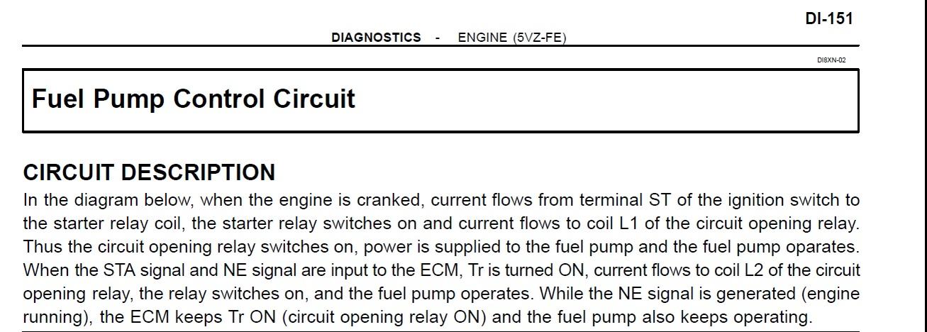

Our pumps don't prime. Once you are cranking they are pumping. Since it runs fine once it starts, your pump should be good. Maybe a check valve letting the fuel drain back? Does it ever start to fire and then dies and won't start?

I haven't seen anything about a primer pump. I used to think that noise was the pump priming too but since reading the FSM I don't know what it is.
