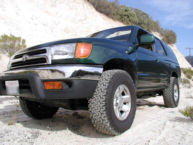

.......I think you'll have more ground clearance on the 4runner than you did with the grand cherokee, even with the stock 225's on the 15's. And you'll probably want to remove the running boards to give you a few extra inches as well.

Here's a picture to give you an idea of the ground clearance you'll be getting with stock suspension/no lift, and 31x10.5's on 15" rims.

Dude, this is what I wanted to hear !! The SR-5 that should be here in 2 weeks or less is a "plain Jane" version, no running boards, no fender flares. I did not want them as that is just something else to hang up on the small boulders, roots, and fallen timber I sometimes have to negotiate. Again, I targeted this particular 2002 model for its unusually low mileage of less than 38,000. Most of the 4Runners around my area of NC that are of that age have well over 100,000 miles.
I really appreciate the photo ------- very encouraging!!. More than likely, the vehicle will come with good tires that I would wear down before replacing. At that point, I would need to decide between going back with 235/75-15 or go to the 31/10.5-15. Another option is to sell the used tires, but they won't bring much. Without asking, I have a feeling this vehicle has the original 225's. It was Florida driven only 6,500 miles a year and I suspect has never been in 4 wheel drive.
