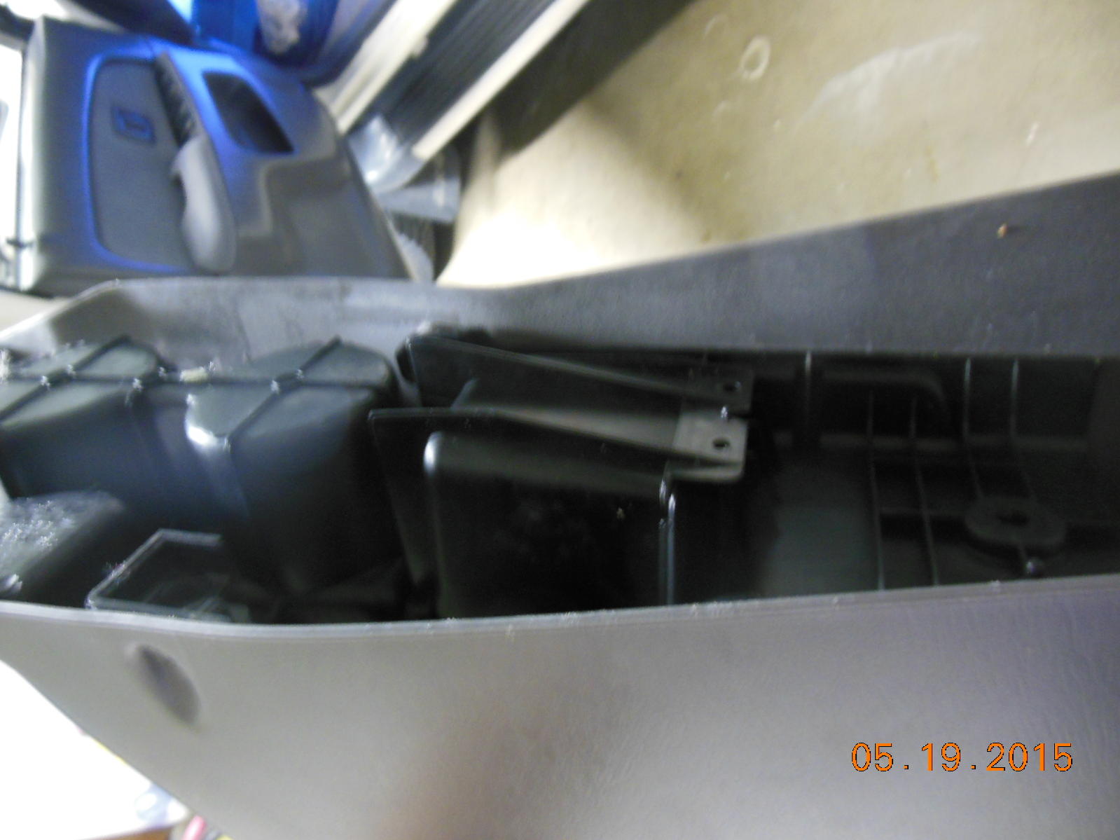

It was straight bolt on. The only cutting is the two bottom fins on the console (3rd and 4th pictures).

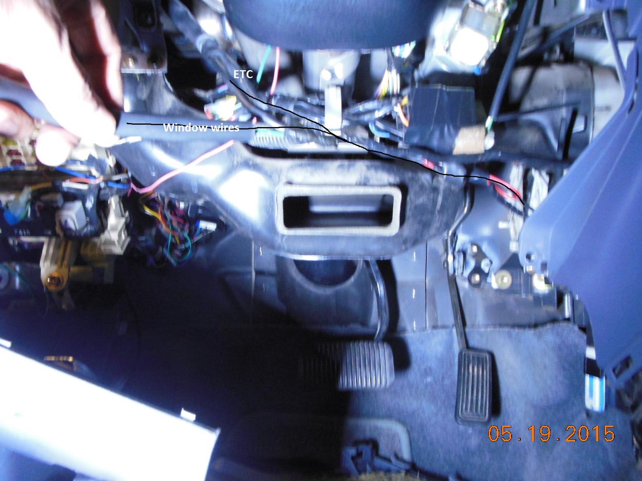

Had to relocate the hatch window and ETC switches. There are enough wires to relocate the two switches into the front dash by the left knee.
So no cutting/spicing wires!

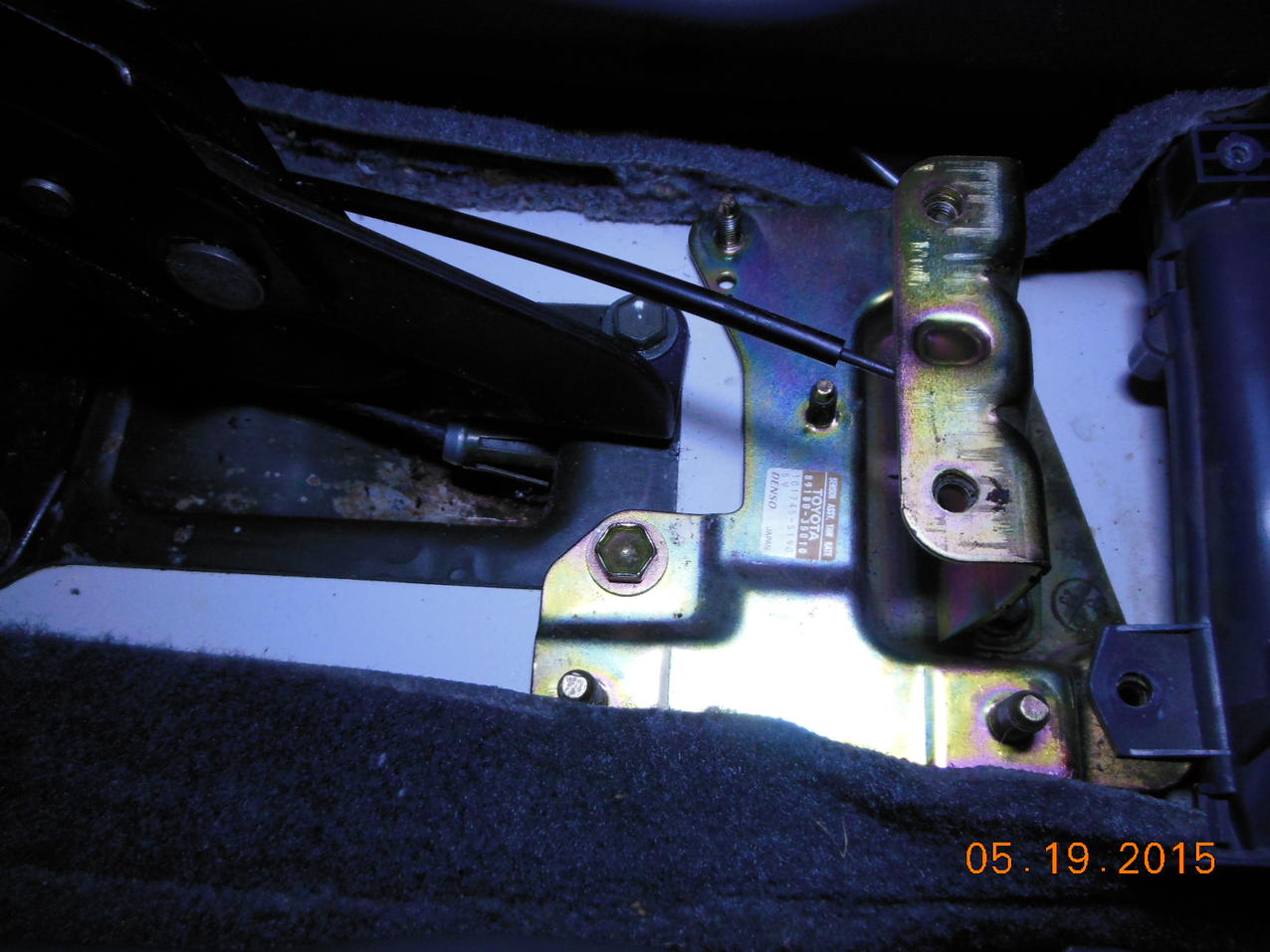

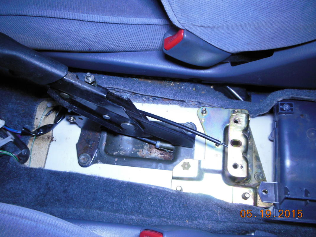

2002 e-brake and rear console mount installed into existing nuts.
Rear console mount: more closer look

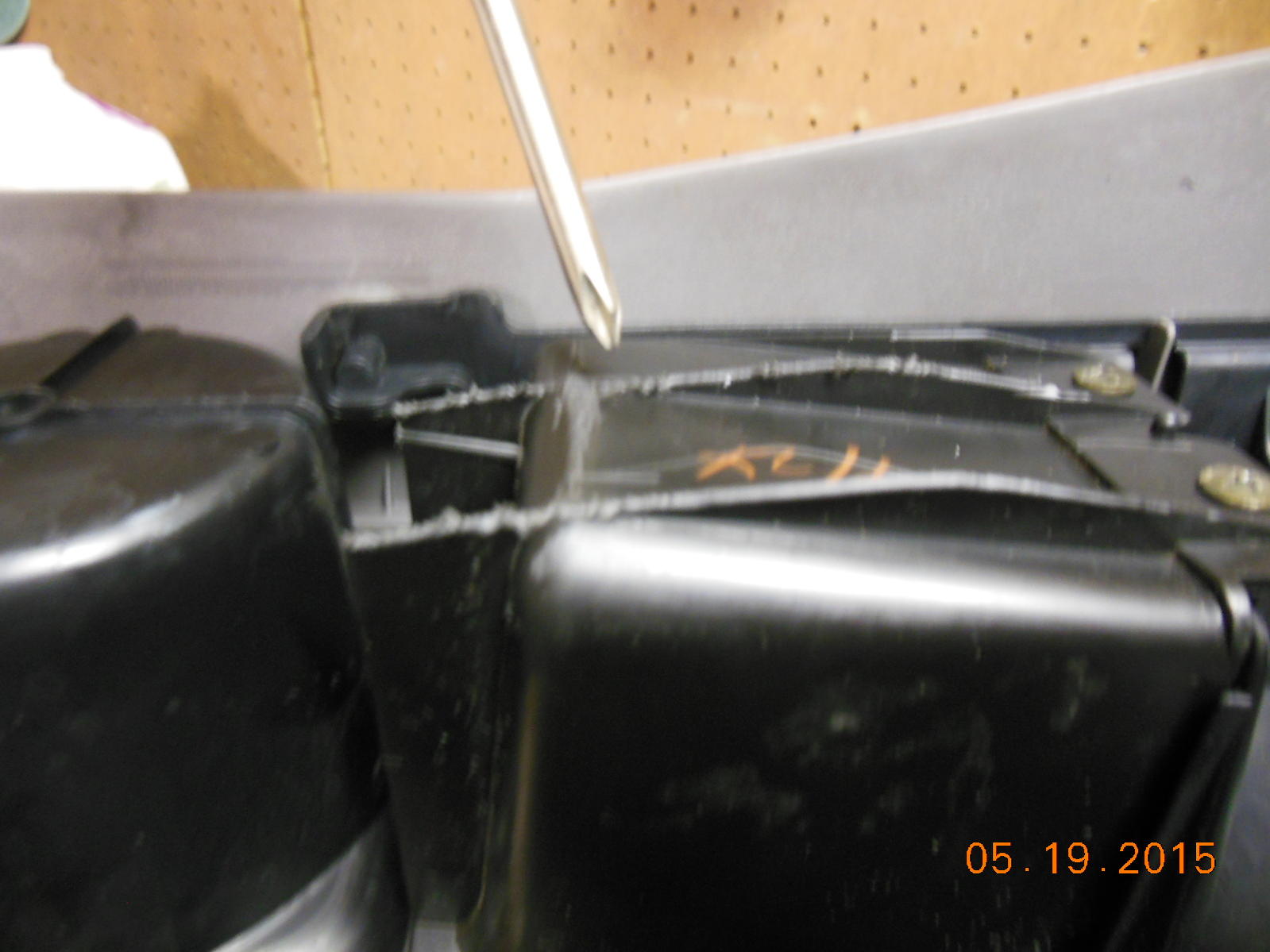

Two tabs to be cut
After cutting the two tabs

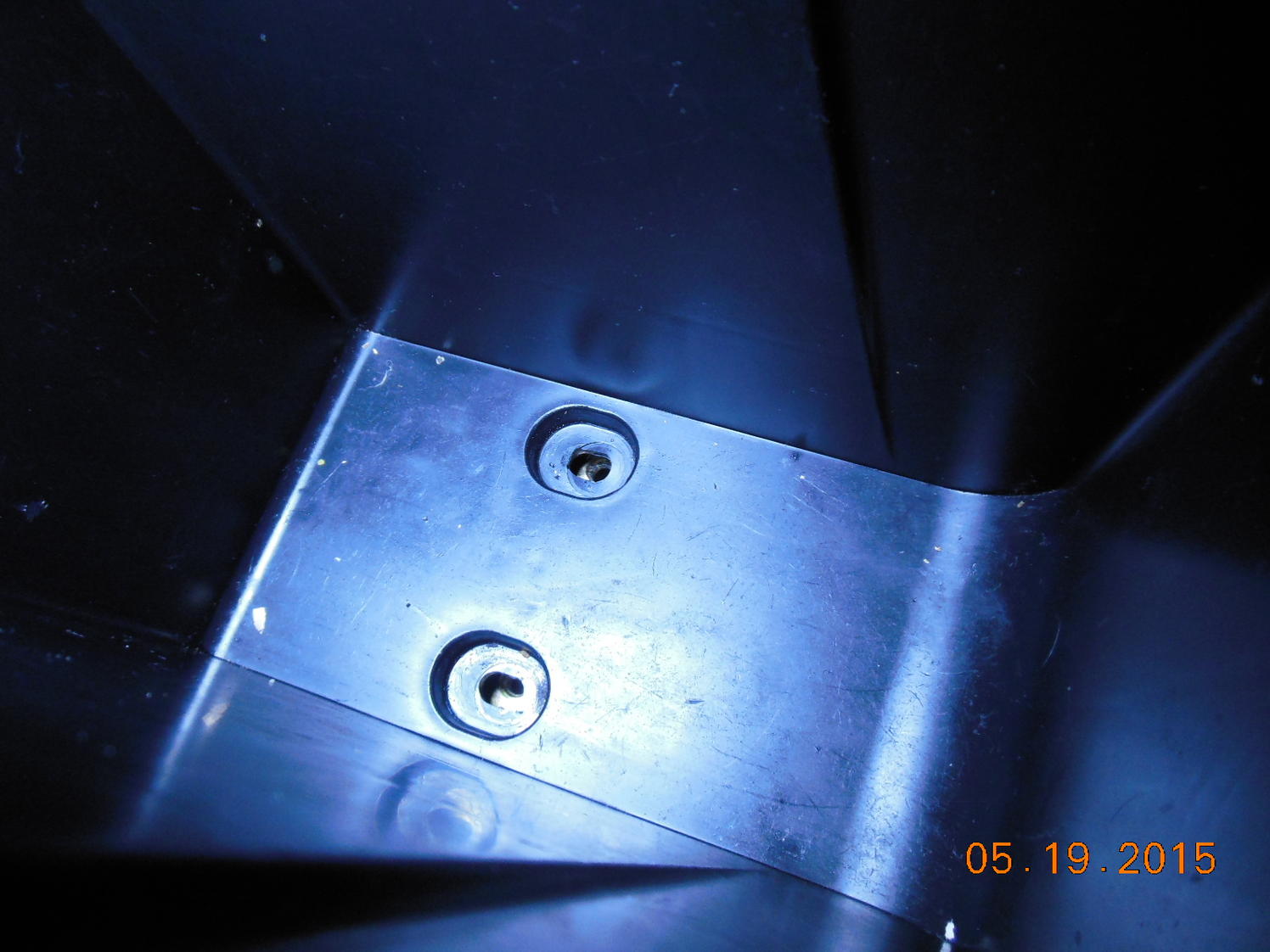

Rear console mounts align with the console
ETC and WINDOW wires

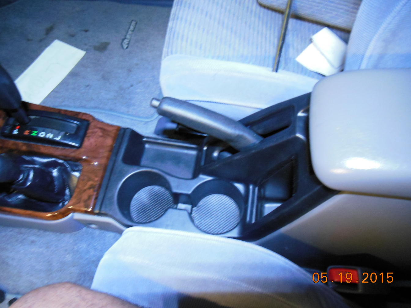

Mounted

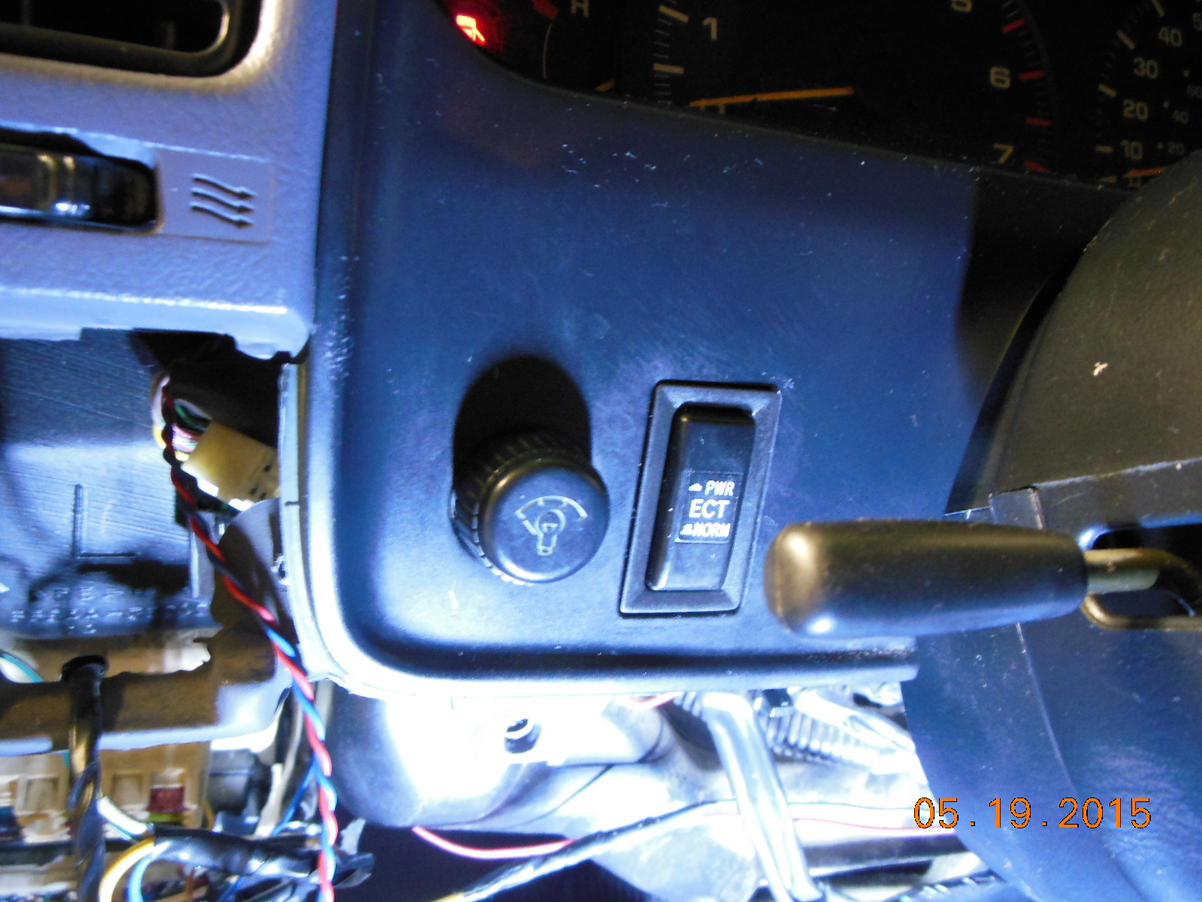

ETC switch mounted.
DONE!
