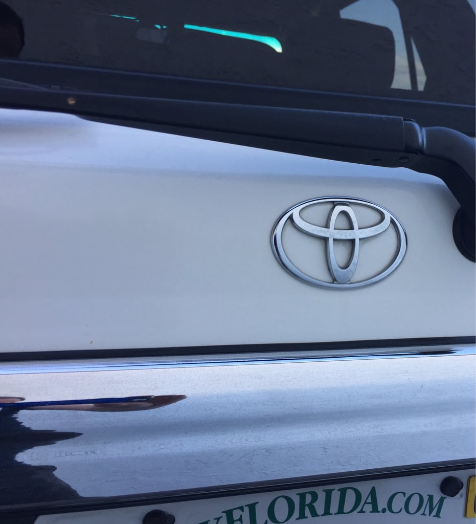

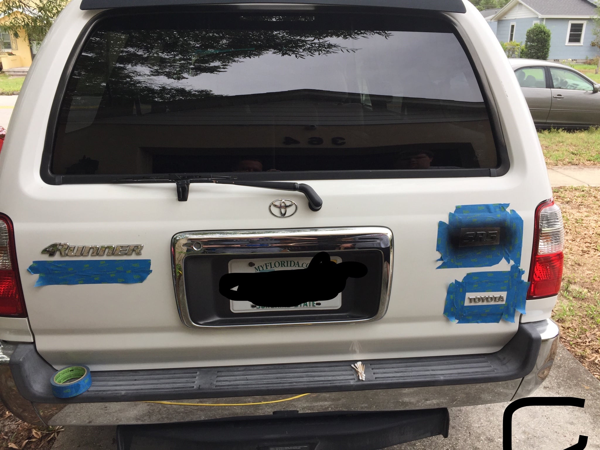

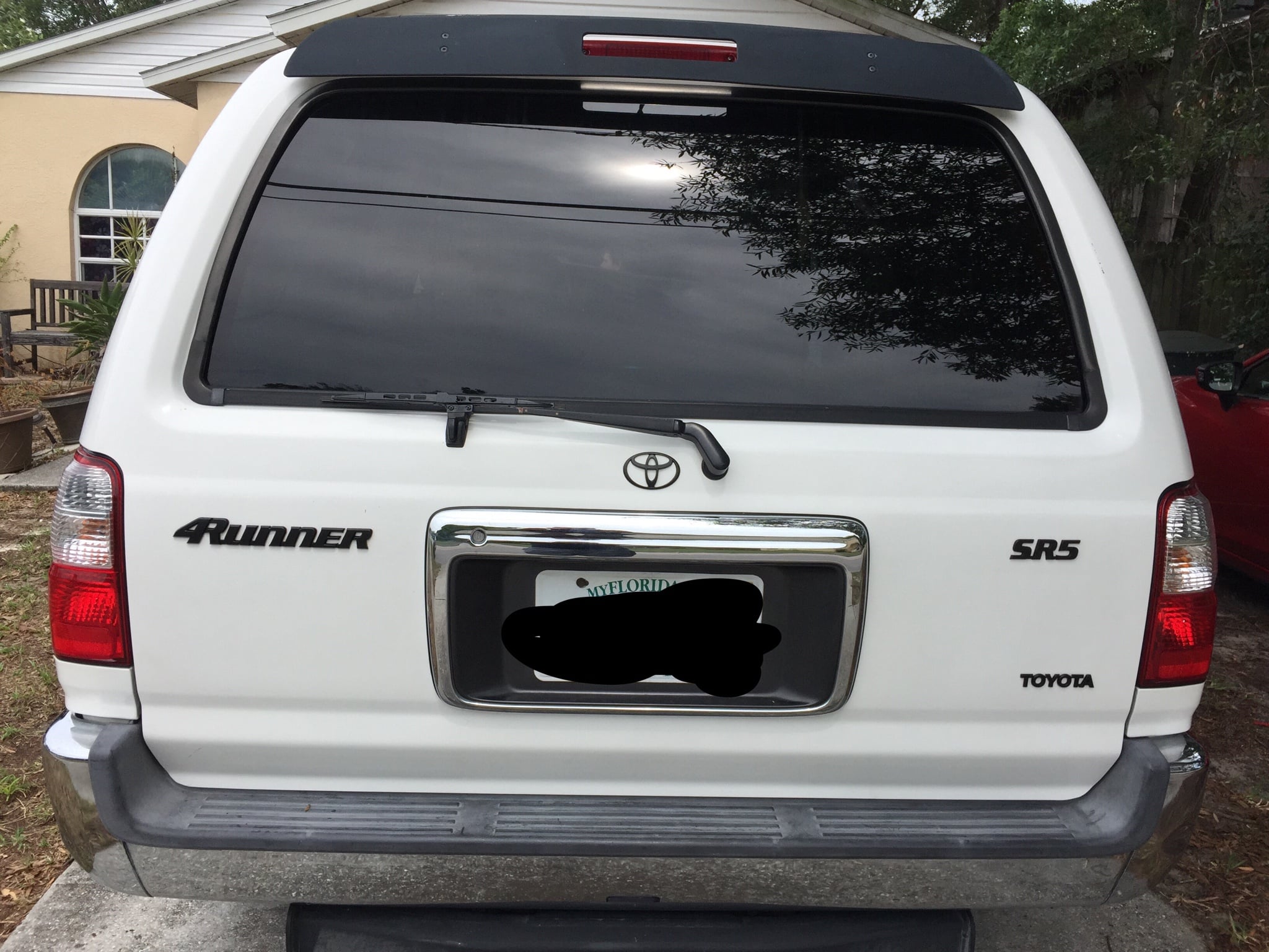

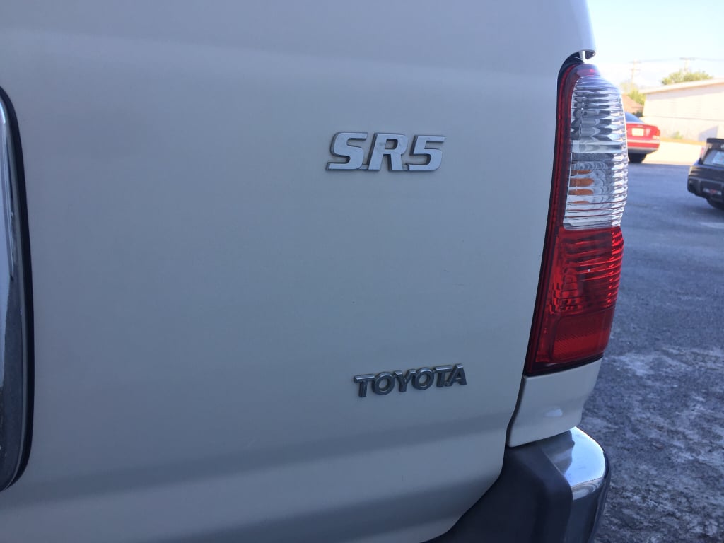

Pull those badges carefully and then you need to deal with the glue on them and the body - that's a PITA

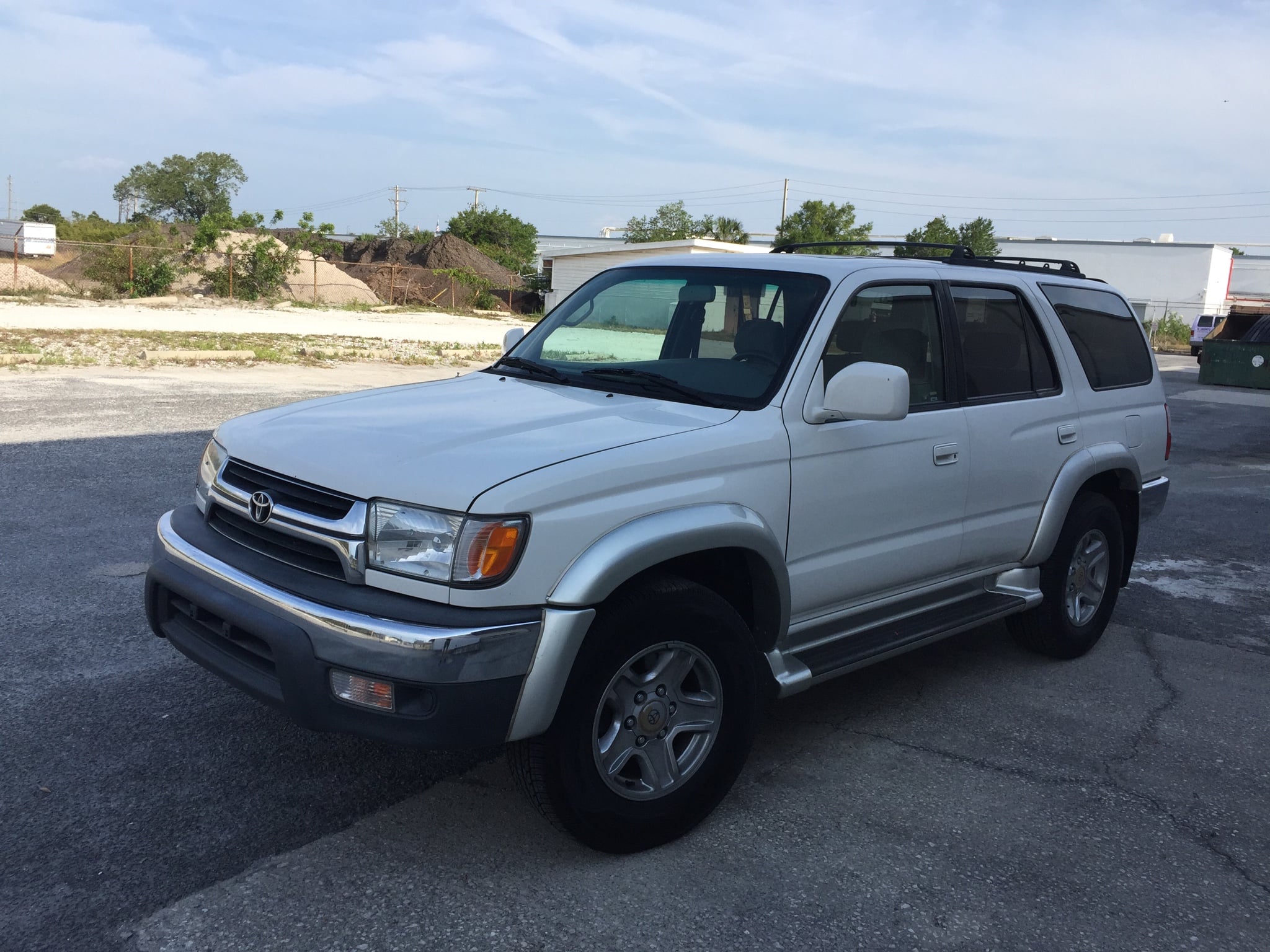

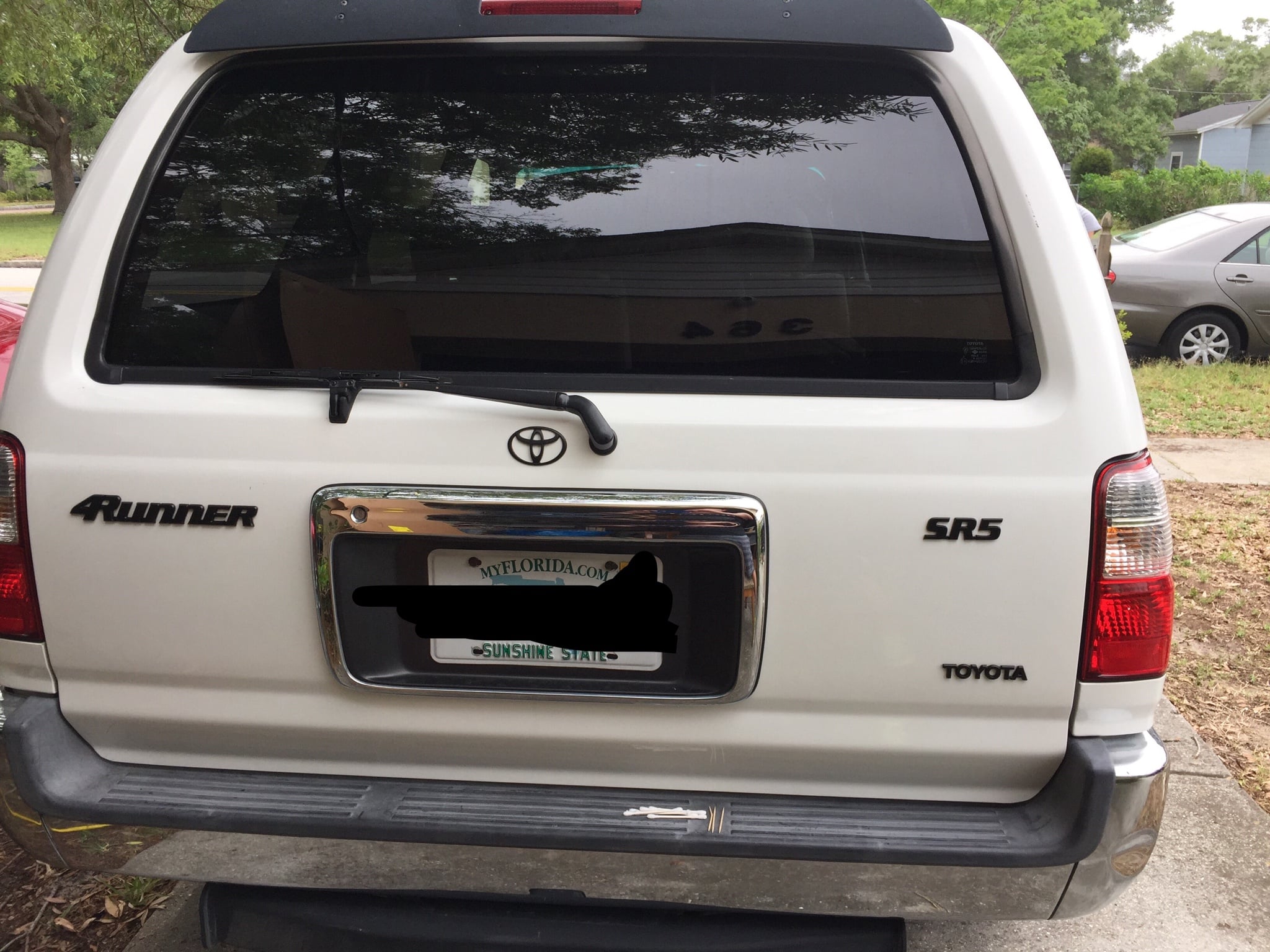

Is your rear end sagging? Kinda looks like it. It's a common thing on 3rd gens. Do your research. Lots of good info here.
Welcome to the club!
Thank you. I hadn't noticed it but it does look like it is a little bit. I'd like to do a small lift on it at some point. What do you think would fix the sagging until then?
Just replacing the rear springs, Old Man Emu 906 will likely net you a couple of inches. Springs just wear out and sit. Tons of info on different spring/height options on here. Use the alternate search thread at the top of the 3rd gen forum.
Ok cool. Thank you! When I'm ready to do that I will be doing a lot of researching
