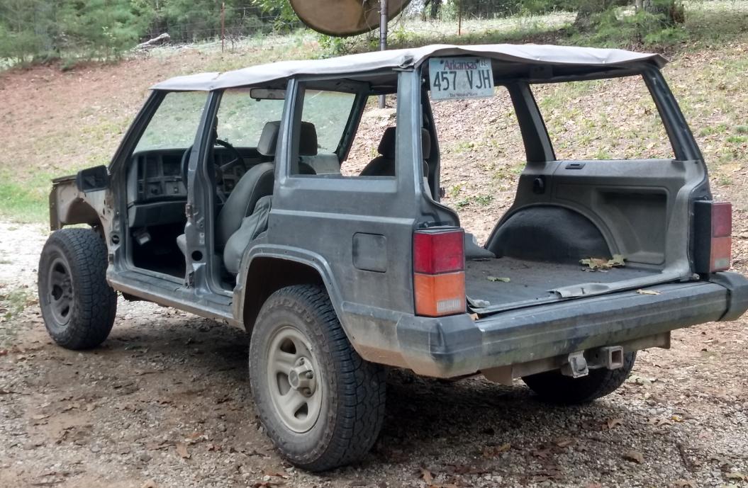

That thing has ac! Fancy! Looks like we have some sh1t in common. This is my dirt truck aka "back up b1tch" I've had for twenty years. I've deleted everything out of it including AC. Not to mention every body panel I love the looks people give me and that it'll smoke pretty much anything that wants to give it a try.
