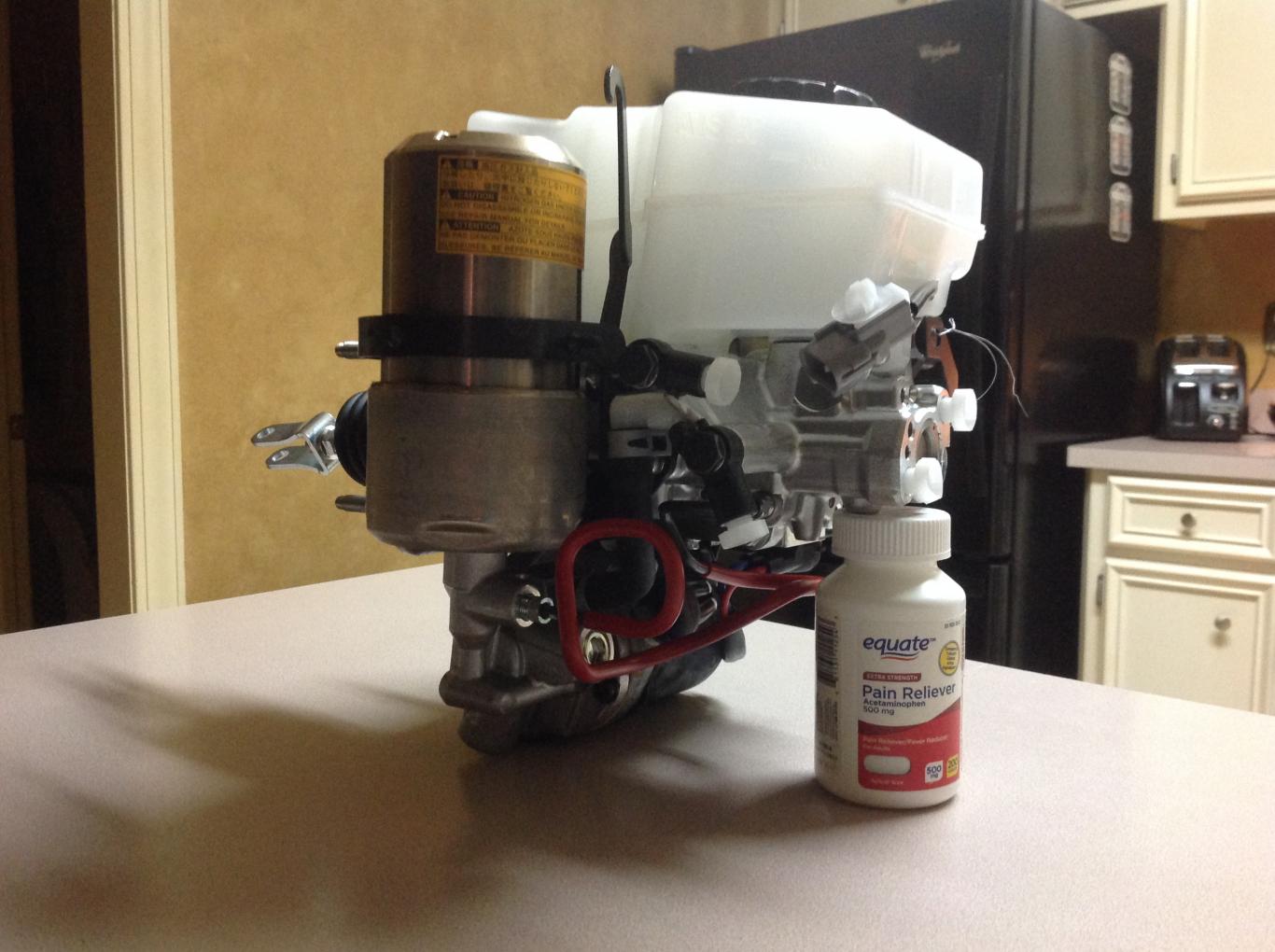

Mine lasted 222,268 miles, debated used rebuilt new, buy once cry once on this for me.
Anything to do with system pressure loss you lose your brakes, nearly browned My shorts when it happened.
Hammer to pump motor got it running = worn brushes not self adjusting, worked couple times.
I'll be good for 200k mi soon, arrived Thursday.
