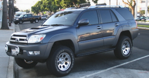

trying out new lift kit on the 4runners. 3 inch cornfed spring spacer and 2.5 inch upper strut mount spacer from extremetrucktoys.com for an fj cruiser totals to 5.5inch front and 3 inch rear.
i already had the cornfed installed for a few months running some 285 70 17 revo and pxa 1069 17 x 9 wheels w/ 4.75 backspacing. i was looking for more clearance on the front and found that the 2.5inch front leveling kit for the fj cruiser fit the top of the strut on the 4runners. believe it or not there is enough clearance for the xreas rubber hose on the bottom of the shock/strut and all the brake lines and abs harness with both kits installed. after all that's been done, the t4r now has a prerunner stance to it with the front end looking about an inch higher than the back.
~original[/IMG]
here's a pic b4 the wheels and the additional 2.5 inch lift.
~original[/IMG]
here's a pic after.

Did you end up doing a front diff. drop to compensate for that front lift? Also, how are your stock UCA's holding up with the extra clearance?
no diff drop, i'm running a 2wd (sad huh?) the UCA seems to be ok for now, the inside of the UCA seem to rub a bit on the spring if the suspension is at full sag. i was thinkin about getting some new UCA's, but i dont know where.
moocowjr said:
no diff drop, i'm running a 2wd (sad huh?) ...
Here is the catch - 2WD. You wouldn't be able to do it with 4WD. Front driveshafts wouldn't allow that much of the lift. 3.5" is the maximum you can have with 4WD. You may go with 4", but that will be at the limit. That's why most lift kits for 4WD have 3".

ALEXJET... what about a diff drop kit? i think they offer a 1 inch bolts and spacers diff drop. would that be enough for a 4wd? or not? i'm only asking because i have a frind that just bought an FJ 4wd and he wants to put the same kits i have on his.

I was thinking of diff drop for my truck, so I shopped around and talk to many people. The front diff on the 4Runner is positioned in a such way that 1" diff drop kit offered by ToyTec wouldn't do anything noticeable. It will lowered the lower point of the diff by 1", but lower the shafts less then 1/2", so no big gain. Basically drop kit will rotate the diff, nit lowering it. I wouldn't go for it.
Best bet for your friend is OME if he doesn't want to spend a lot of $$ or Donahoe coilovers and Deaver rear coils with Donahoe rear shocks; this will at least doubles the price of OME. It's all depend of what kind of wheeling he wants. Fast desert runs - DR; rocks or any other off-roading - OME. I have OME and I more then happy with it, it cost me less then $1000 for the set + installation.
