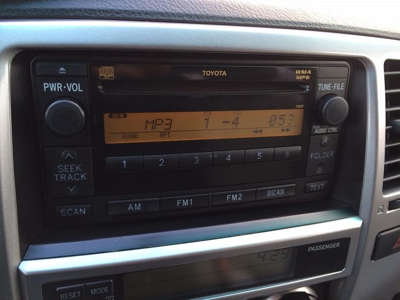

Flawless direct swap
Just had a chance to get the new Toyota radio swap done and it's a direct exchange--no splicing of wires or new harnesses needed. I purchased Toyota P/N 86120-35401 (faceplate 11829; non-JBL, single CD, internal amp; off a 2010 FJ Cruiser) off of eBay for just a bit over $60 shipped. The backlighting is orange, like the rest of the interior lighting in my 2003 4Runner (SR5). The fonts and style match the original radio and looks like it originally came in the car. The other radios (non-JBL, internal amplified) listed above should work as well if you wanted to upgrade from your original radio.
The new radio sound is pretty comparable with the old radio, but the new radio bass seems slightly less vs. the original radio, but what can I expect from a stock stereo. It plays my MP3s on CDs and I do like how the newer radio knobs light up with circular rings (old radio knobs were black and stayed black at night). Nice touch of independent bass and treble controls for the FM and CD player portions. All-in-all, the new radio meets my needs.

UPDATE: Another factory radio swap to P/N 86120-35410 (faceplate 11823)
To get MP3 playback capability, I originally bought a radio (non-JBL, single CD; P/N 86120-35401 (faceplate 11829)) that came from a 2010 FJ Cruiser and while the radio worked and looked like stock, I have come to the realization that bass was pretty lacking compared to the original radio in my 2003 4Runner (non-JBL, single CD). I tried lots of bass/treble combinations to no avail (with the radio, CD and MP3 playback) to get the bass levels back up to an acceptable. The bass was lacking so much that I considered adding a subwoofer to the system.
Just for comparison, I bought another used radio ($70 shipped) on eBay from a 2007 4Runner (P/N 86120-35410 (faceplate 11823)). On physical examination the 2007 4Runner and 2010 FJ units look identical, except for the faceplate ID and part number. Nonetheless, I did another swap and here's what I found out:
  • 16831 (original 2003 4Runner non-JBL radio, non-MP3): sounds good with decent bass [baseline radio]
  • 11829 (original 2010 FJ Cruiser radio, non-JBL, MP3 capable): crisp mids and highs; but bass is pretty flat and lacking compared back to back vs. 16831 and vs. 11823
  • 11823 (original 2007 4Runner non-JBL radio, MP3 capable): sounds like my original stock 16831, with a bit improved sound overall (and bass levels at least just as good)
In a nutshell, while the 2010 FJ radio fits and works in my non-JBL 2003 4Runner, it appears to be tuned differently for the FJ cabin acoustics--so don't use it in your 4Runner as it will result in low bass levels. The 4Runner radios are tuned specifically for the 4Runner, so I'd stick with either of the 2 part numbers known to work for optimal tuning of the bass/mids/high frequencies. Now with the 11823 in my car, I'm happy with the stock stereo with MP3 playback and has acceptable bass levels I expect.
