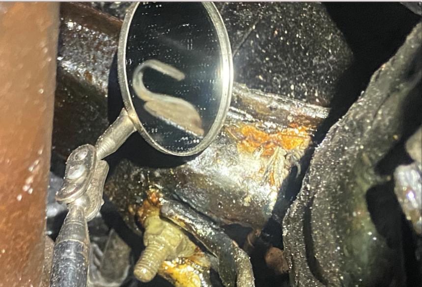

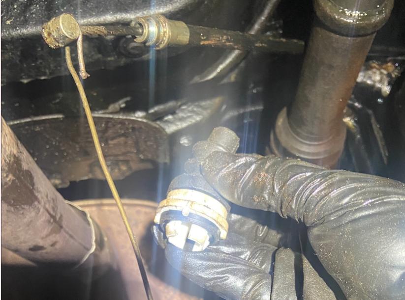

I cut the old cable left and right the tank.... then I could pull out the middle parts. That third bracket is not a fixed connection to the cable. It is an open u-shaped guide for the cable, see picture.
Then I removed the rubber boot that seals the cable to the chassis where it enters the floor to the inside in order to get it fiddled through behind the tank.
I used a stiff wire, connected the end of the cable... fiddled the wire through and could pull the new cable.. the rest was easy. I did lower the tank slightly but only loosened the strap bolts 1/2 "- 1", non of the bolts came off.

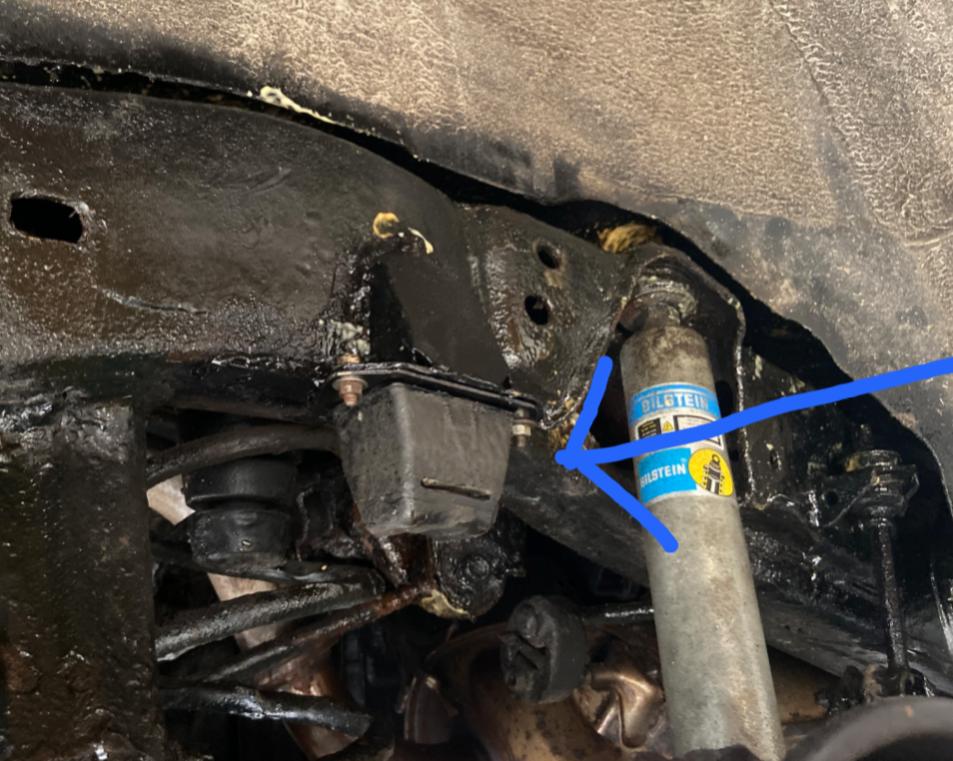

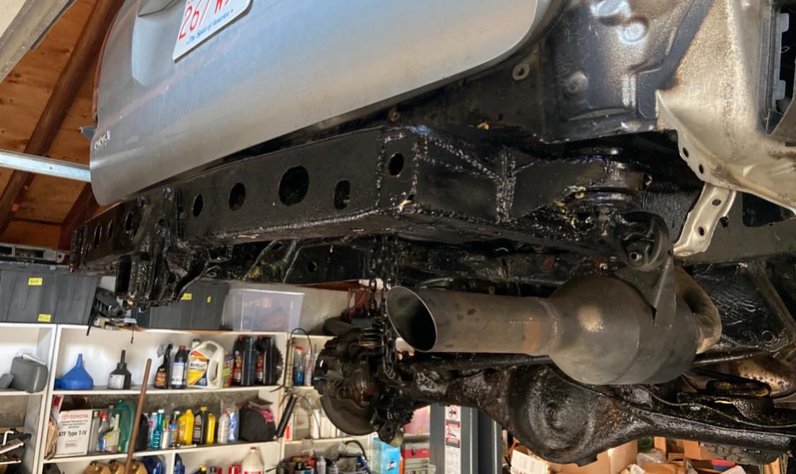

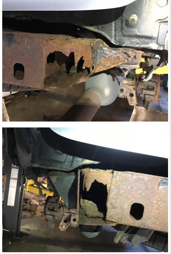

here is what I found a month ago when I removed the rear bumper.
Both ends of the frame were gone... left side a lousy job from the former owner
(left rear cabin bracket was gone obviously) and the right side bracket was now gone and I welded it back in place because I did not have the guts to remove the old bracket... I just welded a new one over the old bracket.
Also both rear axle end stop buffers were gone. I was welding new ones.
See pictures

Glad to hear you got it done. The zip tie trick is a winner for sure. These parking brakes really are on the weak side.
Looks like your rust in the back was worse than mine but I did something similar rebuilding that section. Looks good now!
At least I enjoy metal fabrication as long as there's space to work. BTW, I did not bother installing new bumpers in the back after the old fell off.
