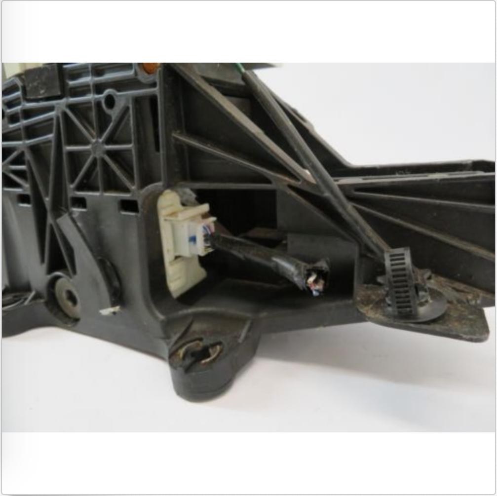

So, it turned out to be a small, wired, shifting mechanism in the console.
The electrical contacts had broken, so they no longer engaged the solenoids in the transmission.
Turns out I not only lost 5th gear, but 2nd and 1st.
Took a while to trace the electrical issue, but is was a much cheaper fix than a new transmission.
I have not seen/found another T4R post involving the same issue (outside this one), so any info you can provide would be great!
Unfortunately, I didnt take any pictures of the defective part - sorry all.
I can say though, that if you take apart the console, in the shifter assembly, there is a white, plastic box on the side, with electrical contacts.
I've attached a picture from the Interwebz, which is the best one I can find, since none of the assemblies have been taken apart.
Iirc, the box dimension are about 2" high, 3" long, and maybe an 1" thick.
This is the part which broke.
Used shifter assembly cost me $250 (I'm in Canada, so obviously cheaper in the US).

As a follow-up on this issue, I finally got around to fixing it. The problem is with Part # 85903-60020. Some places list it as Control Module while others have it as Computer sub-assy, shift lock control.
I couldn't buy just that part from the junkyard but they sold me entire shifter assembly for $50. I swapped out just the control module and that did the trick. It was very easy, maybe 30 minutes to get it swapped out. (Another 60 minutes spent cleaning 15 years of crumbs, hair, who knows what in there.)
