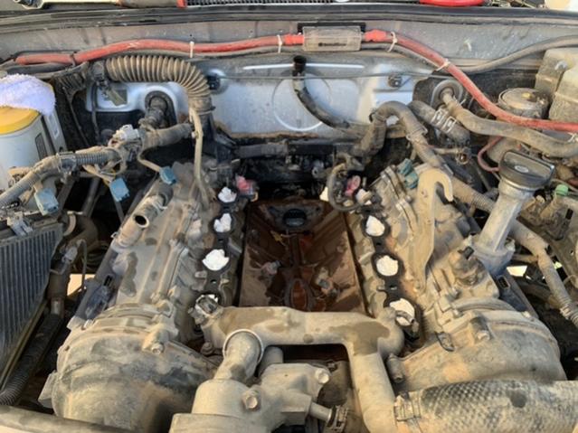

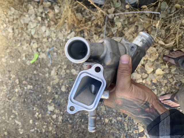

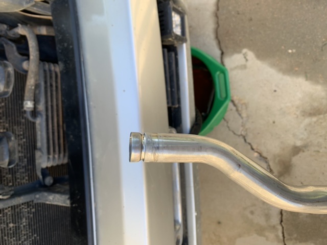

I had a similar issue on my 04 V8 it turned out to be the Oring on the backside of the thermostat housing super easy to miss but pretty easy to replace. There was also another smaller Oring that failed on the coolant bypass hose that was underneath the intake. It was a little harder to replace but I did it when I replaced the starter.
