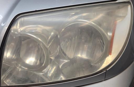

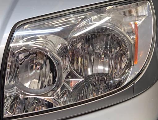

I used a 3M kit I got off Amazon for about $16. It says it has a 2-year warranty. I think I spent about 2 hours actual time. I had to recharge my drill batteries a few times and I don't include that in the total time spent. If I have to spend 2 hours every 2 years, well, that's okay. :)
Here's a link to my restoration
https://www.youtube.com/watch?v=i0PryhTrClc
