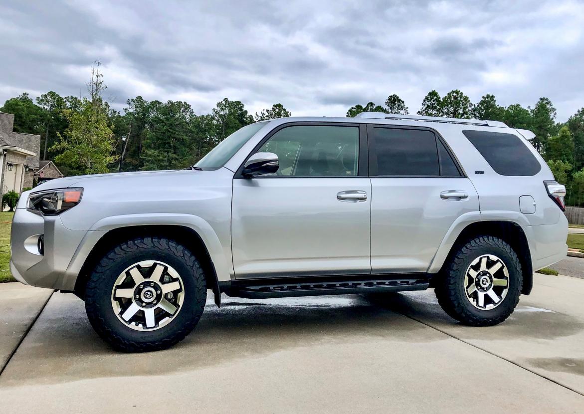

My wife has a 2018 4Runner SR5 Premium. I installed the Lasfit Pro 4runner specific low beams and switchback fogs this weekend. Now trying to change out the DRL. I don't mind if it is a halogen as only will be used for DRL function but the OEM looks pitiful. Is there any good options from Sylvania, Phillips or anyone else? Or is there a true plug and play option yet for LED? Not trying to run a bunch of ballast or things to the battery. Thank you. I was searching this morning but didn't see anything for halogen replacement.
