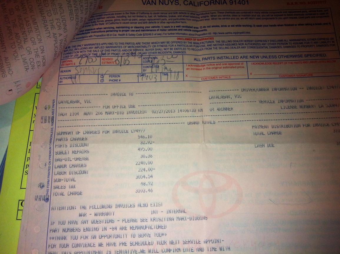

all I ask is that you please prove me wrong and post photos of your estimates / repair bills. Just cover up any personal information.
Man you have way too much time in your hands... go find a proof of who was trolling instead of accusing so quickly. Only time will tell and if it does become a common issue then you will only look foolish in the end.
I do hope this is not a common issue as it is a painful repair bill for anyone. Did not expect this to happen either. Let just help each other in better ways to deal with this problem and find ways to reduce the cost of the repair. Maybe having an insurance when you are close to the mileage, might not be a bad idea.
I paid 38k for my 04 Limited + 3000k more... :sobbing:

I agree 94K is not very good. Sorry for that, I hope the new HG version will take 2x times that.

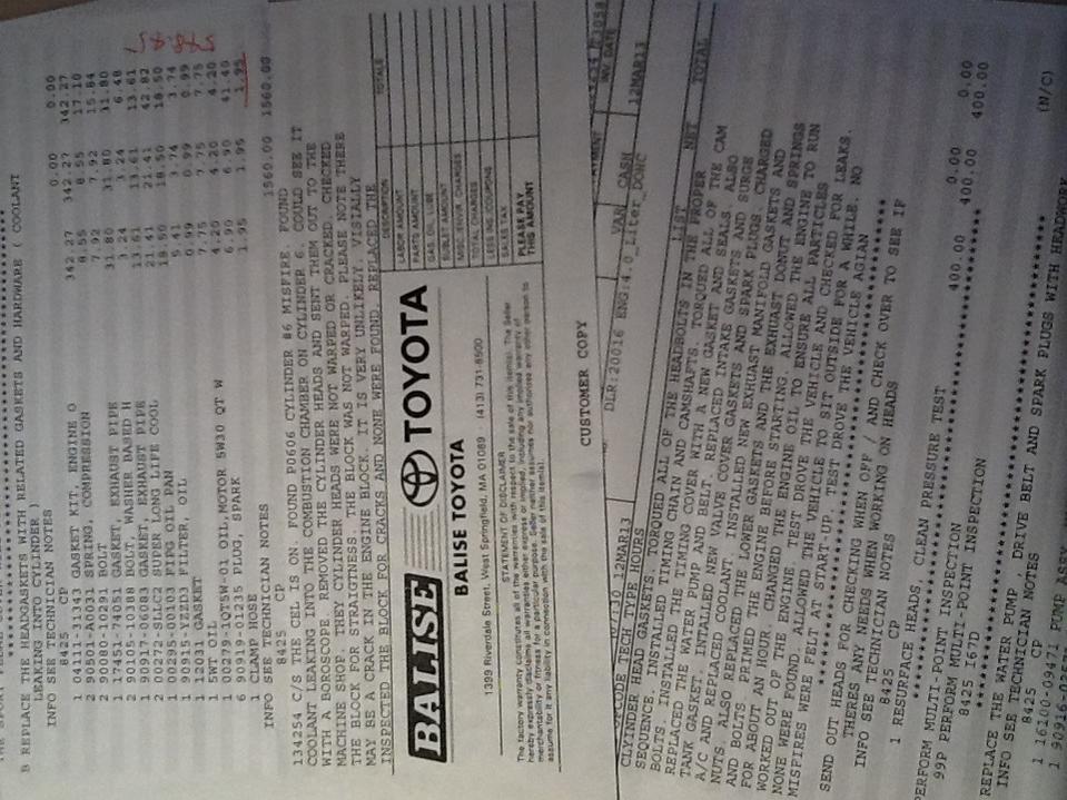

VICRC I apologize and sorry to hear about your expensive repair. Thanks for posting your bill, and Calimander as well.
Thank you both for not disappearing and posting shots of your repair bills. If I was you I would keep hounding Toyota to help with part of the repair bill. A head gasket going bad at 94 is just stupid. Unless they can show it was a result of gross neglect on your end I don't see how they wouldn't help you.
Thanks to everyone for their support. I only got the repair work done at the dealer so in case of a recall I (might) get some compensation.
As a result of endless searching on the web about this issue the main assumption isn't bad antifreeze but either bad original gasket material or the design of the head itself. Either way Toyota should be standing behind us long term owners of Toyota products. My antifreeze had been obviously changed. My understanding is that the new gasket is a redesign. ----- Dave

With my bad eyes hard to tell But Calimander's post of his bill 04112-31720 but maybe some of the guys that actually work for dealeships can chime n Blackworksinc & others will know .
Here is $2,928.01 to disprove your conspiracy theory.
