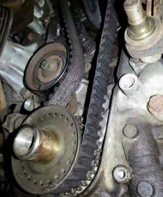

It doesn't look like this does it?
:drum:

It's definitely not the timing belt, and definitely not an inverted one. I don't think the tensioner bearing is seized, as it doesn't make much racket when running (not squealing) and I don't smell hear anything other than an occasional squeak. I got some belt dressing and it changes pitch/frequency when sprayed/watered. I also picked up a new belt and tensioner assembly. Hopefully it is just a bad belt, but I will check for play/resistance of the pulley while I'm in there.
