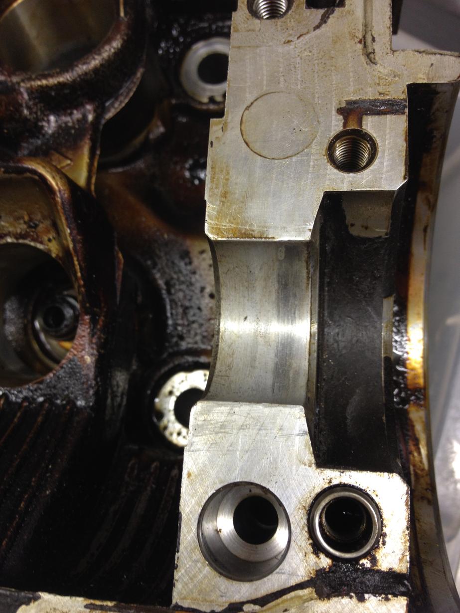

We bought the SR5 knowing it had low oil pressure and got it real cheap but I had the engine from #1. Turns out the owner #1 leased it, no records of oil changes. Owner #2 bought it from the dealer with 89,000 on it and no timing belt change. So at 154,000 the oil light starts flickering and they sell. Dealer auctions it, another car lot buys, and then sells to me.
I cleaned the blocked oil pickup screen on the oil pump and we started driving. Turns out the oil passages to the cam bearings got blocked with carbon and it seized at 70 mph, broke off the cam bolt but didn't wreck the valves! Turns out Toyota or others manufacturers did not require proof of maintenance like they do now and it was common practice of some owners to never do maintenance because they could get away with it.
Look at the clogged oil passages!
