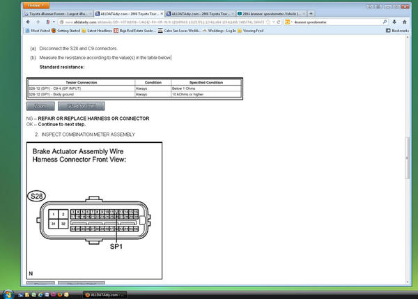

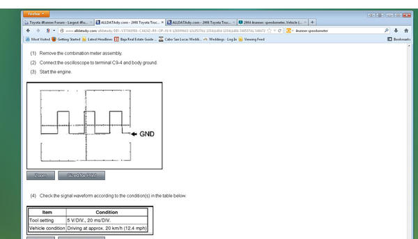

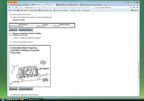

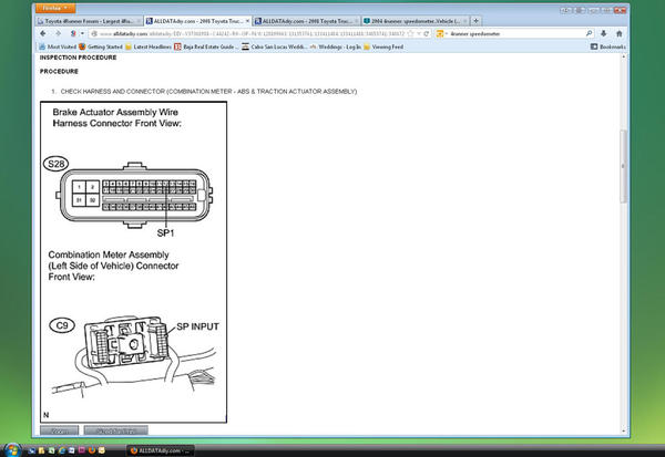

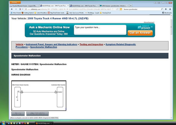

My office machine has my manual on it so I can't help there. I did just check alldata and pulled screenshots.
