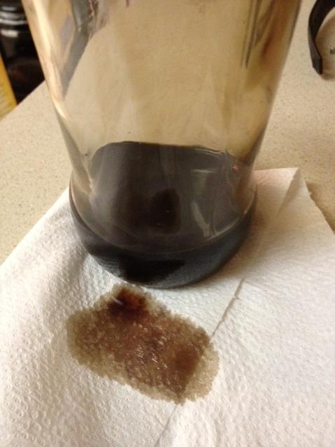

I have been lurking for quite a while, but in summary still loving my 2005, how it drives, how it looks, trouble free for almost 7yrs and all that. Car has been in central NC all its life since June 2005 where it served as the daily and racked up many highway miles and has been serviced exclusively at one dealer incl all oil changes and all scheduled maintenance. For the last few years it has been a 2nd vehicle, sometimes used as a daily driver, more so in winter and otherwise just the weekend carryall and trips to the dog park. For the last 6months since moving up to NJ it has been garaged and only used as a daily when it looks like rain or snow.
About 2 weeks ago and at 118,500miles I felt a slight shudder from the trans as it hesitated before shifting from 3rd to 4th at 25-30mph under light load. Here is my post amongst others on the same issue.
http://www.toyota-4runner.org/4th-gen-t4rs/72998-rumble-strip-transmission-issue-7.html
I decided to take it in for the 120,000mile service and get this seen to. My first thought was that I would insist on a trans fluid change, which the dealer declined to perform at 90,000miles. It would get all the usual 120K service items and I also wanted all 3 diff fluids changed (rear is typically incl in 120K service). I was prepared to accept that the trans fluid change may not fix the issue and would go further and replace the torque converter if necessary. I like the car..
I dropped it off Morristown Toyota in NJ last Tuesday and they called in the afternoon to say that the tech had noted a right front brake caliper was hanging up and it needed to be replaced. They were certain this was the shuddering I was feeling and that they had seen many of this generation with caliper issues at over 100K. I was troubled because I thought I would have known if something was amiss with the brakes and would know the difference between a trans issue and a brake issue, and the rotors and pads were replaced with OEM at around 110,000miles. Nonethless, I told them to replace it if they were certain it was stuffed.
This was going to take at least another day to get the part in, so they put me in a rental car (no charge), which happened to be a 2012 4Runner SR5 with Nav package and 250miles on the clock..
Come Friday morning I pick up the car and take a drive with the tech, trans shudder still there, he acknowledges it and I request the fluid change at my own cost and accept that this may not fix the issue.I specify that a want a full flush/exchange, not a drain and fill.
Days go by..I put 250miles on the loaner trying to like it..Tuesday morning I inquire on the status and they say the car is ready (and I am so ready to get my car back). I pick it up and expecting a bill of around $1,300 (it adds up fast) they tell me that they are not charging for the fluid change.
To those who aren't familiar, it took 2hrs of labor and 7quarts of fluid to do (so about $300)(update: apparently a full change would have been 12quarts so I plan to follow up on what gives), has to be done at operating temperature and its kind of a PITA. (I have left out some back and forth discussion of how Toyota does not recommend doing this - world standard lifetime fill and etc., but I never requested any financial assistance or discounts). See pic of the oil below, its not Coke.
I drive home and immediately feel and improvement in shift quality, about 20% smoother shifts and more responsive to down shifts - smoother than the 2012 I have been driving for a week (granted it is brand new). I am grinning at having my car back, the same only a little better in every way, a little more grunt, steering better, braking better, shifting better. I have tried to replicate the hesitation multiple times tonight and cannot do it. It seems perfect.

what's the whole story, root cause, on the transmission/oil ?
bad batch of oil from the factory ? improper factory fill level ? hidden warranty ?
That is exactly what my tranny fluid looked like when i changed it at 125k. on my 06 sr5. I truly think Toyota is starting to backtrack on the life time fluid claims that came out originally. Nice that they changed it for free. Im wondering if they are getting more complaints about the rumble strip problem. when I asked my dealer about it they said they dont do fluid exchanges and wanted to go straight to changing the torque converter. So I bought the fluid and did the drain refill 3 times to see what it would do. So far so good..

Are you still rumble-strip-issue free? I've started experiencing this, thinking about doing some trans fluid drain-and-fills.
