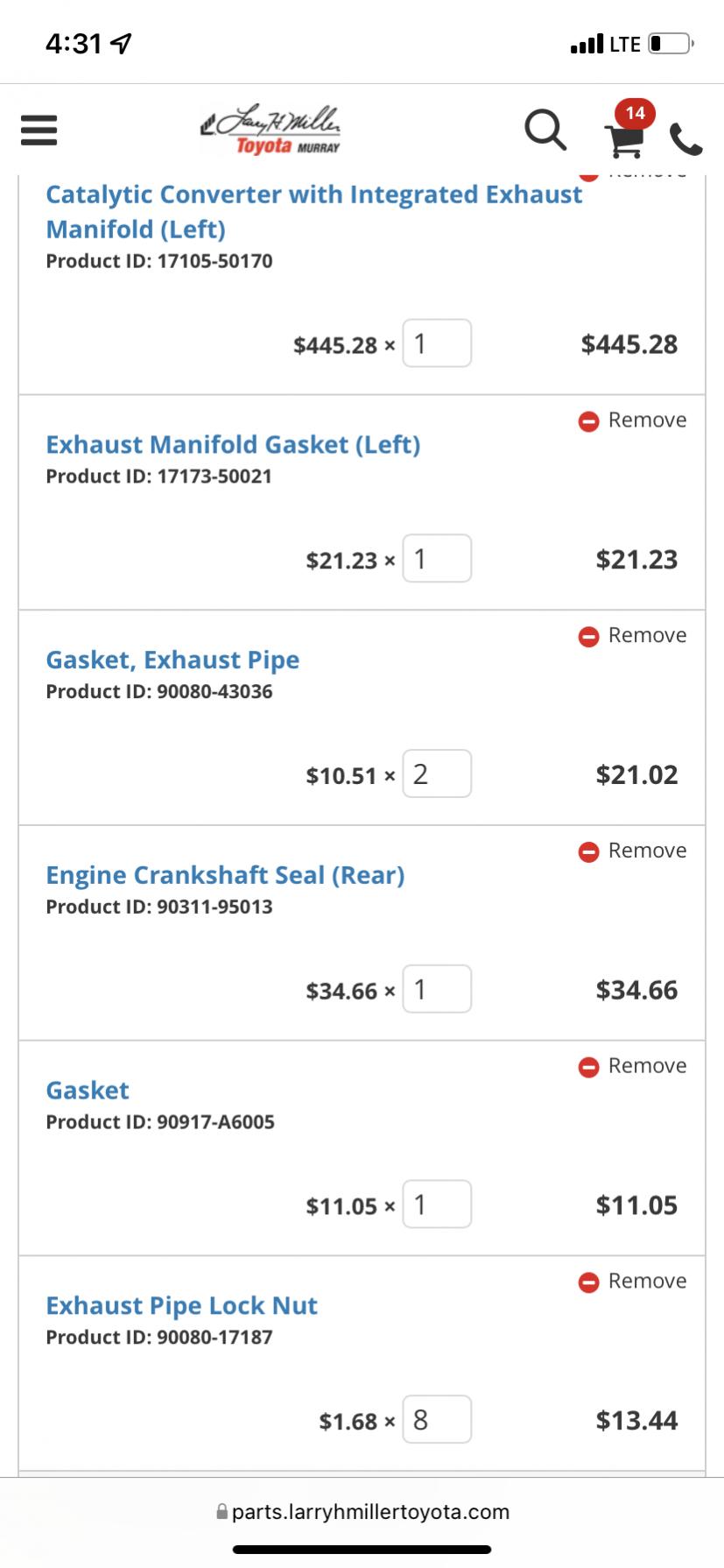

This is the parts list I’ve acquired for my 04 and the nuts are on the bottom no studs. Hope this helps.
