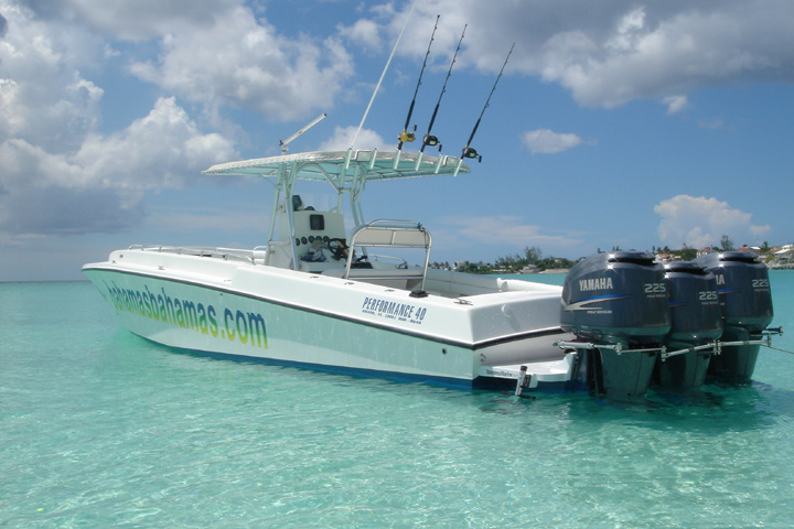

I'm a consultant. I bought the 42 Performance 15 years ago, Ran it on many 100 mile round trips and caught hundreds of YFT and dolphin (including a 71.1 pounder landed in the Marlin Marine Tournament that is probably the biggest ever. (Won 2nd - the winning boat had more weight)
Know what to do when you have a steering failure? Using my tabs I got home without any steering. Push the starboard tab down with the switch and the boat tacks to the left. Push the port tab down and you goto right. Got home from 100 miles offshore this way at 40 MPH, without calling the coast guard or begging for a "pick up" or tow! No Steering.
In all my year's boating I never called anyone for help except 4 miles from port a few times when I ran the boat out of gas.
Called a buddy with a boat parked next to mine. I took him fishing many times, so he bought me a 5-gallon jug of gas..
