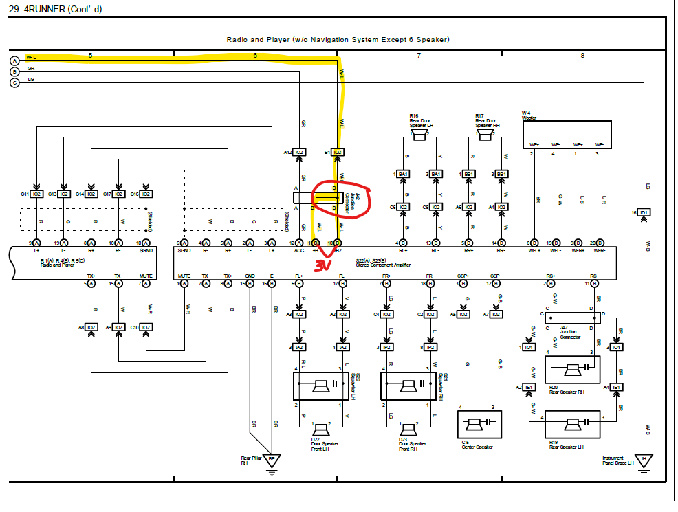

Replaced the radio with Pioneer unit 5 years ago using the adapters to convert the RCA on radio to use the stock amp and speakers, worked great for 5 years. The other day it suddenly stooped producing sound. Radio looks like it works fine but no sound from any source. I checked all fuses for amp and all good. So I replaced the Pioneer radio and still no sound. Figuring it had to be the Toyota amp in the back I bought a factory amp off Ebay and installed it and same issue.
What next? I just want sound not some crazy aftermarket system just music for wife. I don't know what to try please give any input you have.

Ok so thanks for all the help. The problem has been solved. Checking the constant power wires to the factory amp (white with blue line) showed that I had 12v on one lead and 6v on the other.??? Also when I turn on the amp they both drop to under 3V one more than other but both low. After getting a hold of the wiring schematic and seeing that both wires are supposed to be bridged together that should have same voltage...Ahh Ha! I cut the factory wires and ran 12V from battery to the two White blue wires into the amp the thing came alive!
I still have no idea how two bridged wires have different voltages I'm sure they are compromised somewhere but I really dont care to find it. Just ran a new wire and I'm happy. Hope this helps someone else out .
