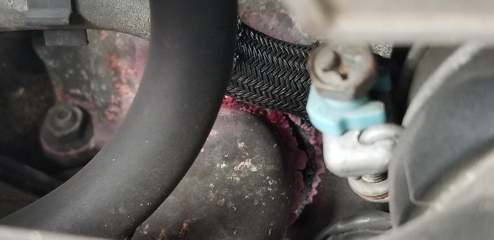

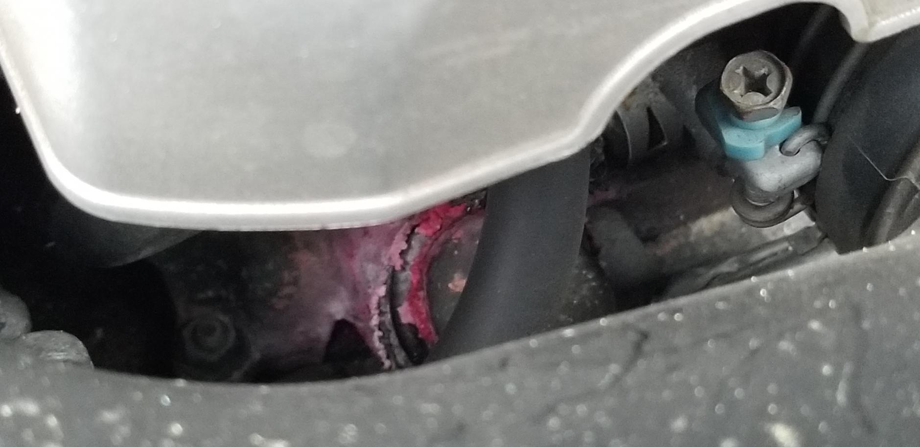

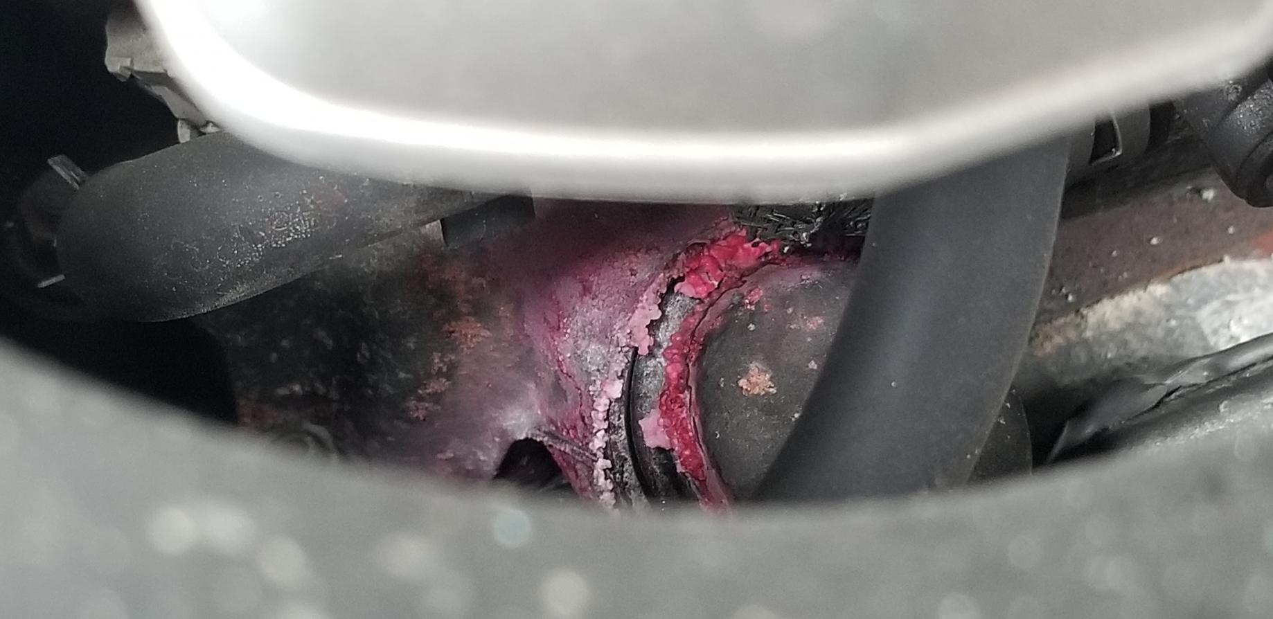

I noticed an antifreeze leak on my 2006 Toyota 4runner but I'm hoping it's not a huge expense to fix. I've attached pictures to help identify the spot of the leak, any insight would be appreciated

The hose runs from the bottom of the radiator to a metal piece where it splits into the engine which is where it is leaking

You’re leaking coolant. If it leaks when you start the vehicle, check your radiator (Front of the engine behind the grill), water pump(Usually by a motor mount, connected to a belt via a pulley) and coolant lines for leaks. If it only leaks after getting to engine temperature, check the heater core lines for busted hoses, or even a heator core leak (Signaled by wetness in cab, and maybe some leaking outside).
