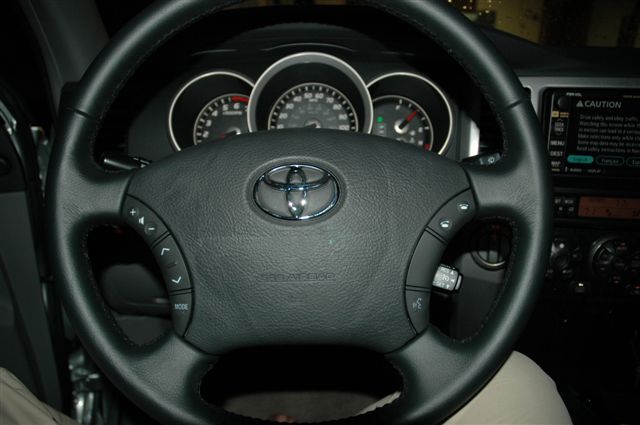

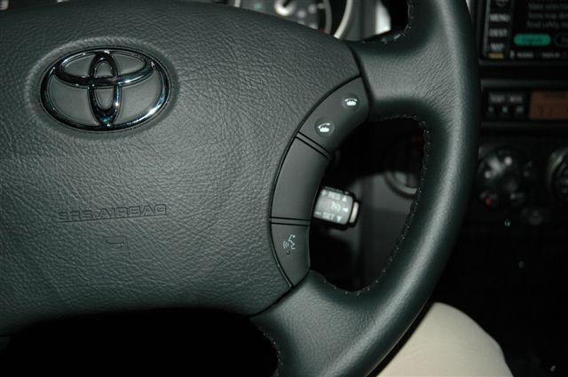

If you can take a picture of your steering wheel controls, and also the sunglass holder (mike?) area....
Do you have RSE?
j0.
j0,
Sorry for the delay... have been out of town, but back now. I don't have RSE, but can take pics of the steering wheel controls for you.
Brad
steering wheel 1

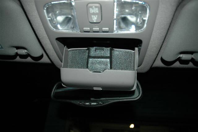

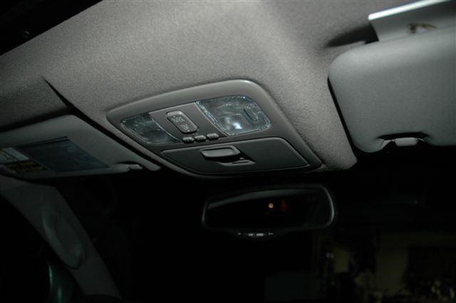

Thanks... can you also take pictures of the sunglass holder area, thats where the mike is supposed to be.
j0.
front center in the sunglass holder. there are two (maybe three, have to check ) wires coming out and going above the headliner. I'm pretty sure the gps antenna is integrated into the mirror mount as well. I'd have to take pics thru the windshield to show you, but that won't work with a flash, unfortunately.

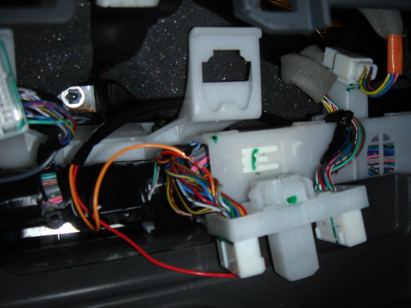

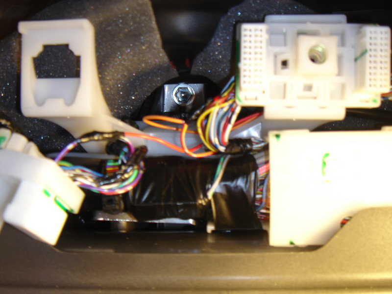

I ended up grabing the Reverse wire (red/yellow stripe) from behind the cluster.
