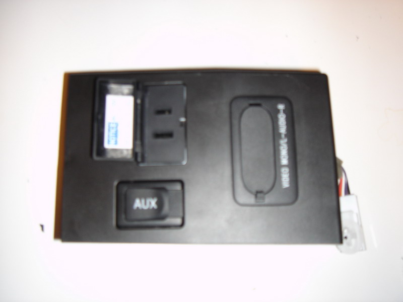

Added the Video AUX Input

video/audio aux assembly
Hi J0e;
do you know if this video/audio input assembly (and the right side switch and microphone switch) will work on my 05 4-runner limited w/ Nav and Rear seat radio?
i have been looking for an audio input so i can install a dvd player using the jbl system.
thank you much.
Well the input of audio and video has to go thru something with a RSE Controller, or the display in the front will NOT go into a video mode.. and the right side switch will work.. Since I did it in my Dads 05, the only thing I havent tried with that is putting the 06 switch (with the bluetooth fone) buttons..

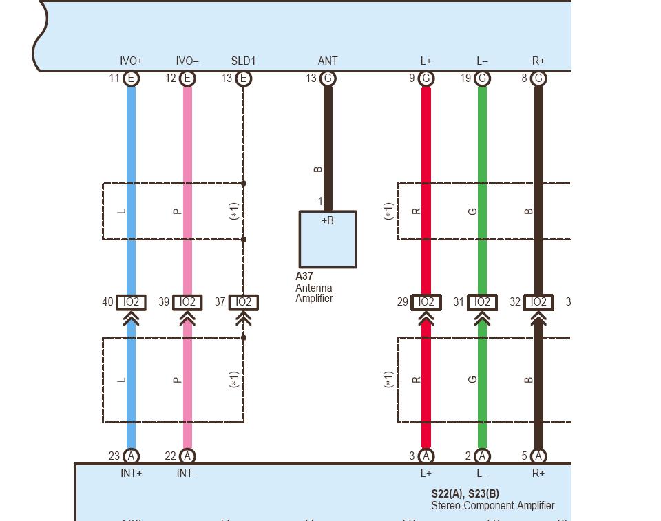

j0mama said:
Well it seems that the 10 Speaker JBL amp does not have the voice input... I just tried wiring it..
SHIT!
So I am gonna try a 10 speaker Sienna Nav amp..
j0.
This diagram is CORRECT. A Factory 10 Speaker JBL does have voice inputs.. I also did it on my Dad's 05 4Runner, and that also worked with the Sienna Nav.
j0

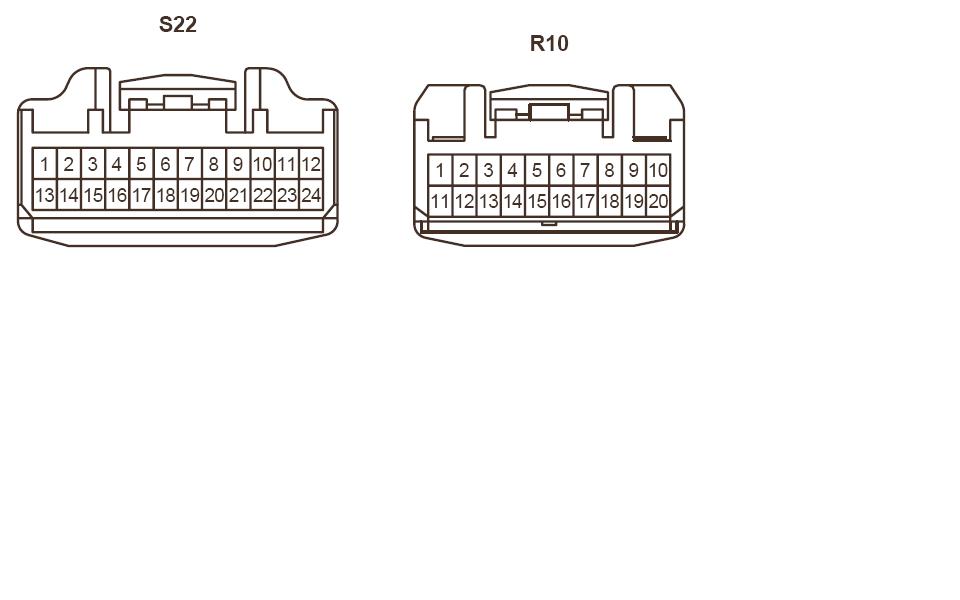

So.. From Connector:
R10 Pin 11 - S22 Pin 23
R10 Pin 12 - S22 Pin 22
R10 Pin 13 ---SHIELD.

J0mama, can you break this down a little for those of us who aren't as technically proficient?
You are saying I can get the solara nav voice sent through the JBL amp if I just hook up pins 11 and 12 under the R10 connector on the nav to pins 22 and 23 of the s22 connector at the amp, right? So, what is the "shield" that pin 13 should be connected to??
The shield is just the metal around the two conductors to stop it from having noise...
Thats it.
j0.
Cold you give a little more detail on the parts you used? With my current setup I don't have a shirld.
I used two connector wires from a computer cd-Rom connector as suggested by OEMVALUE. I hooked up one connector to the 11 pin under the R10 connector, and the other one to the 13 pin. I then connected these to a Radioshack amplified speaker. The 11 pin is connected to the input, and the 13 pin is connected to the shield.
This works okay, but doesn't sound good. I've been looking \for a different speaker. Connecting to the JBL amp would be cool, but my current setup would not have a shied or ground.
I found a cable with two wires in it (red and white) and it had a metal conductor around both wires... I used the metal conductor as the shield, and ran the other two wires from headunit to amplifier.
