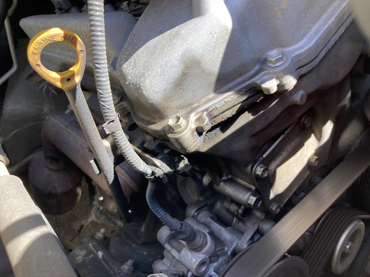

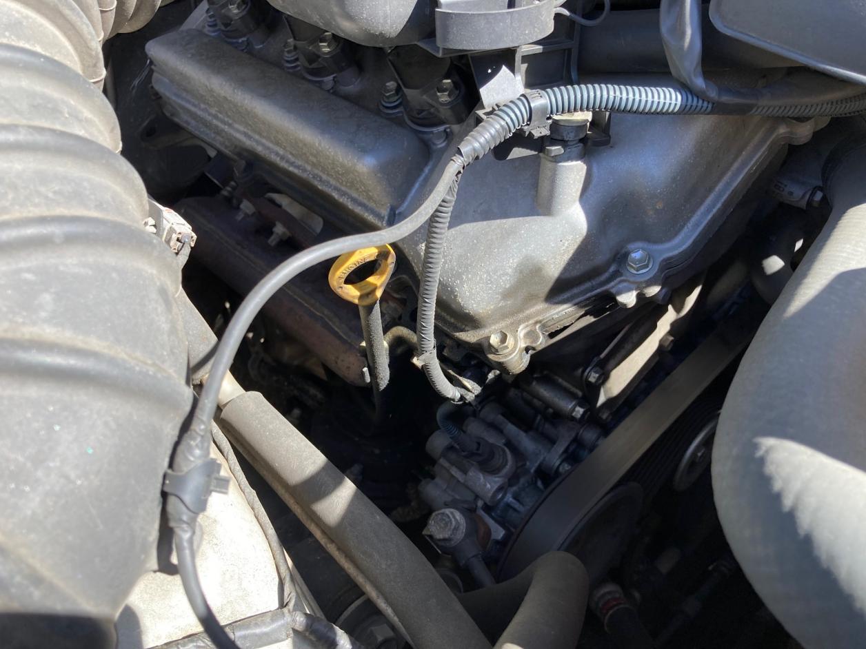

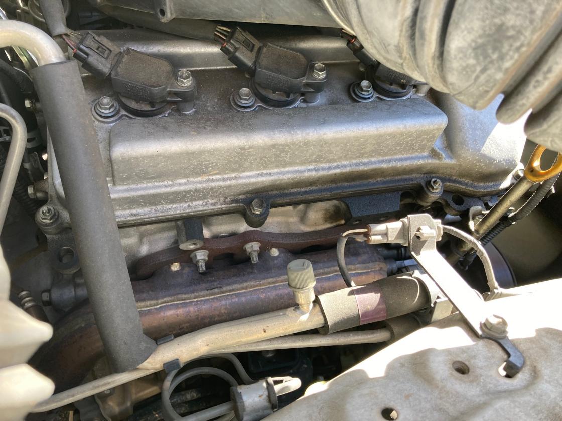

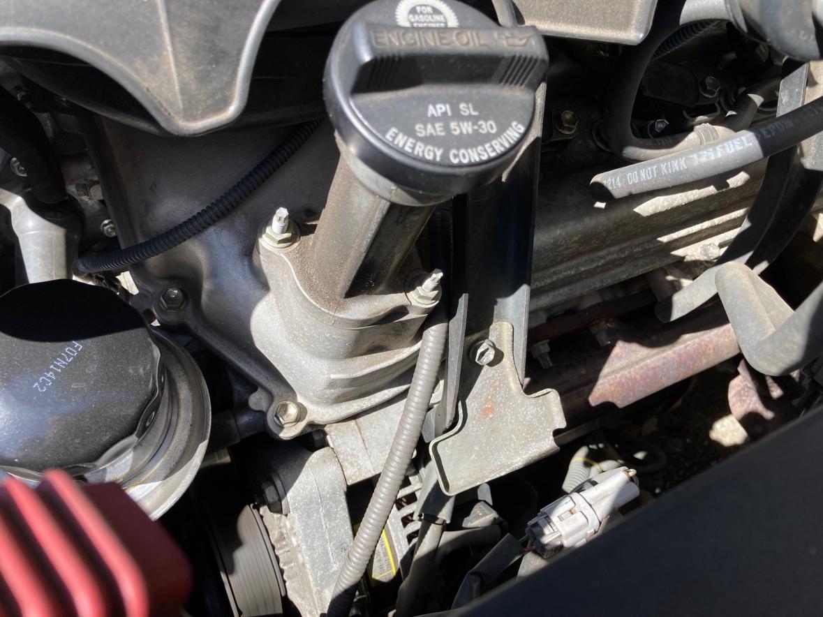

Thanks for all the feedback. I cranked it a few times today and couldn't get the loud whining sound to come back. It may have been there but it wasn't loud enough to be noticeable. One thing I did notice was an oily substance on the passenger side of the engine around the valve gasket. Is this something I should be concerned about? Here are some pictures (first picture is the drivers side for comparison):

Looks like you have some seeping valve cover gaskets. I wouldn't say it's an emergency repair but probably something you'll have to repair at some point.

& on the valve cover residue, looks like minor seepage built up over a long time, nothing wet or fresh oil. i would wipre it down & monitor it to see how quick it comes back. can also gently check the valve cover bolts & snug them up a tad. at 194k miles it would be a good idea to start using a high mileage oil like valvoline maxlife or any other decent brand, it is a more robust oil & has conditioners in it to soften up seals & gaskets to prevent leaks & prolong their life.
