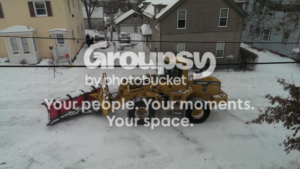

The city of Portland, ME doesn't mess around with snow removal:
