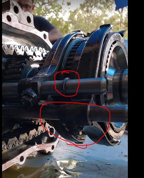

I've torn into my Tcase in order to replace the two O rings inside and to address the lethargic shifting into 4low or CDL engagement.

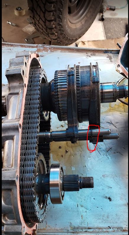

You can't just pull out the actuator, then replace it due to the two rods that are connected to sliding forks inside the tcase. This is for a V8. Take a look at the pics below and you'll see what I mean! The rods go through the shift forks and have C clips! Additionally the shift forks are attached to the rods with bolts.
I also reclocked the actuator but I had another V8 tcase actuator to look at for a sanity check. This is a royal PITA and should be avoided at all costs. Otherwise, the whole project is doable with the right tools, jack and of course help.

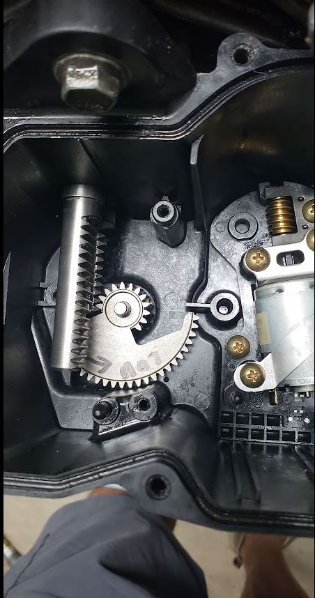

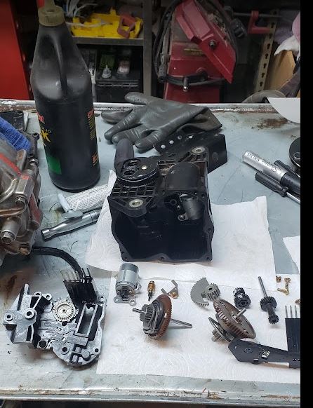

Now, if you want to do this from the actuator's end, that's doable with a huge amount of caveat due to the timing issue. What you'd have to do is to take apart the actuator, so that the plastic sprockets are disengaged from the serrated rods which is monumental to me. Then you can unbolt the black plastic actuator box from the back of the tcase and put it on the bench, replace the two o rings. You can see where they live in the third pic on the back side of the actuator, look for the two circle indentations. The fourth pic shows the "serrations" in the rod for sprocket engagement. That pic shows both rods but they're on top of each other so you'll need to squint to make sense!
