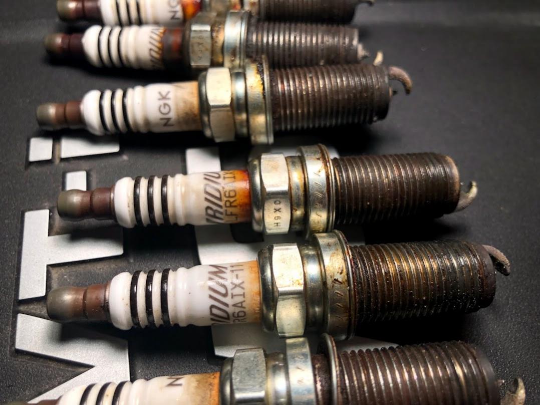

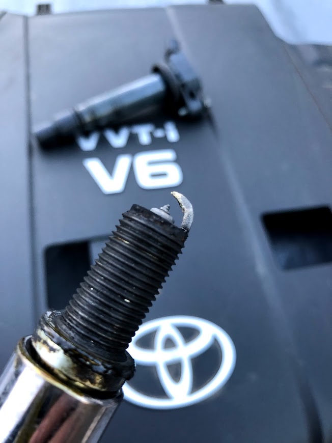

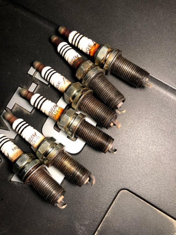

Here's some visuals for you. This is what NGK Iridiums look like when life gets crazy. These things had a great life! I would recommend them for sure!

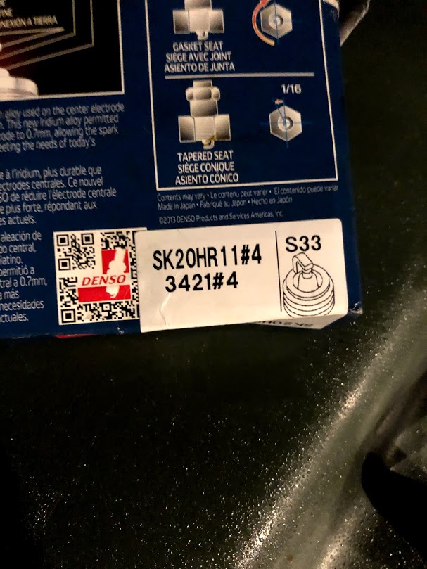

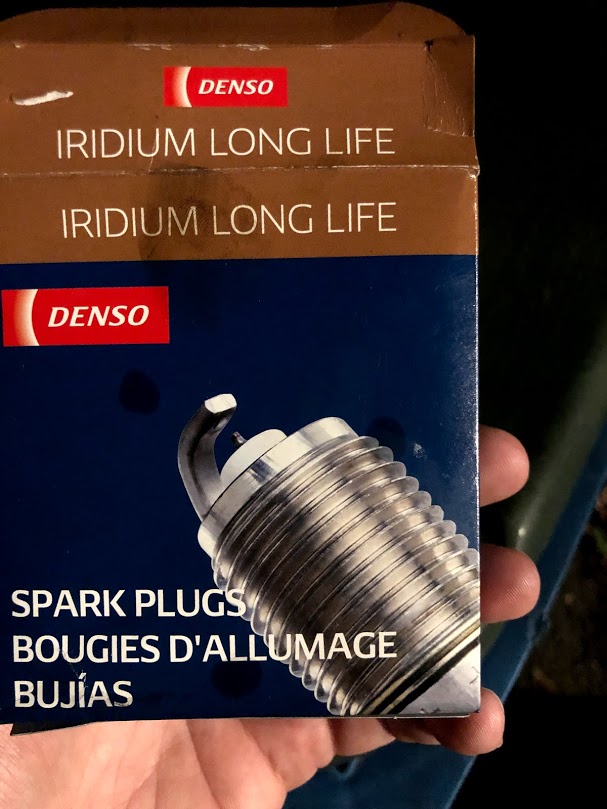

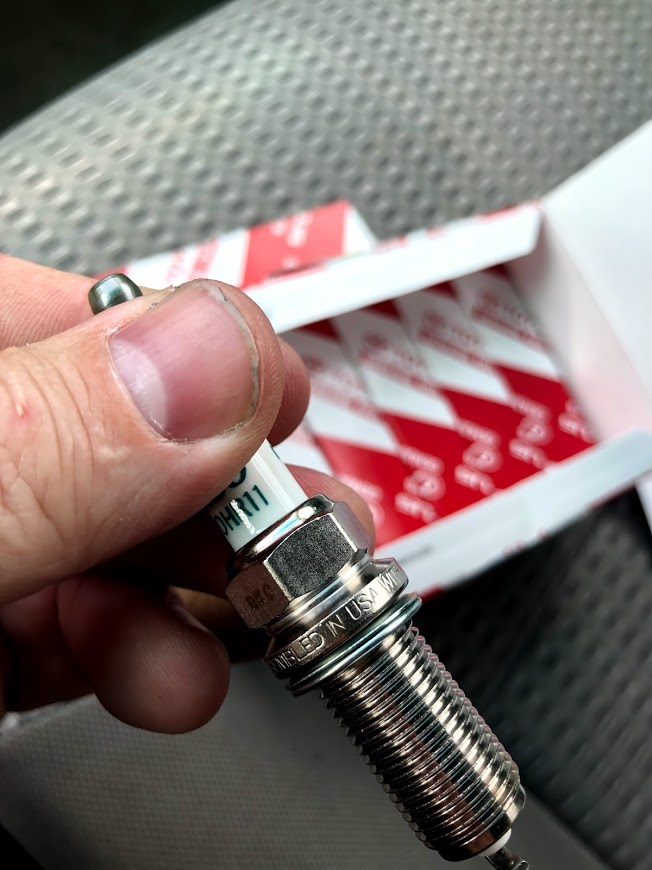

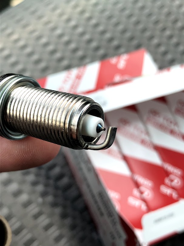

And here's some visuals from the Denso's I bought from AA and what the packaging looks like. Sorry I didn't take more pictures of the plugs themselves. I took that one picture before I installed them. I'll try to get some more for comparison sake. I hadn't read about the "FAKE" plugs until this was started, otherwise I would have just gone straight to the dealer. I must have got some junk plugs.

Okay. I got plugs from the dealer. Same part numbers, but visually they do look a bit different. Very subtle.
FIRST!
The part number for the NGK Iridiums I have been running are as follows:
LFR6AIX-11
This plug cross referenced by the dealer to the same part numbers as the Denso's I purchased:
SK20HR11
These Denso's were apparently only offered on 4.0L V6 in 2009 and are applicable for this vehicle, as were the NGK's listed above. I had them double check everything. These are all "long-life" plugs. 100K plus mileage.
Previous to 2009, only the standard 30K plugs were available, and obviously much cheaper. Praying that the swap goes good and no issues. There shouldn't be, but after fighting with these dang plugs last night, I'm on-edge. HA

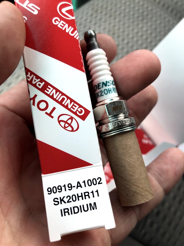

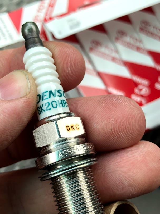

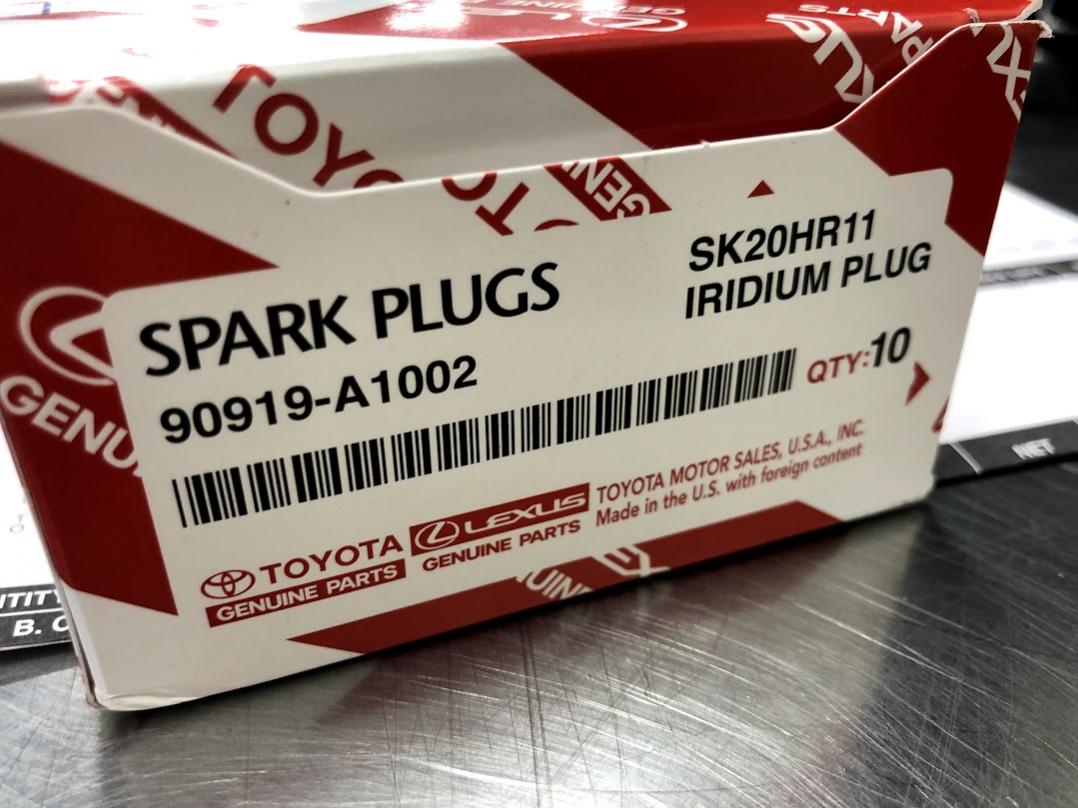

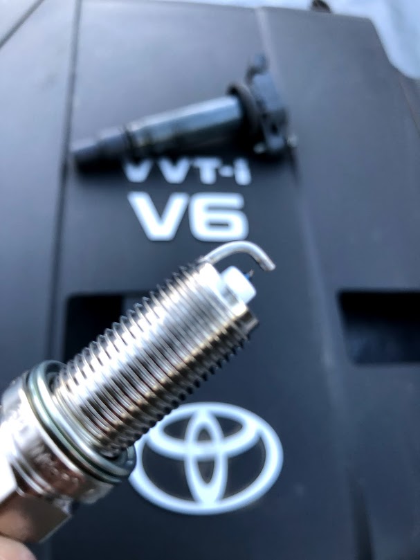

Pictures of the dealer purchased Toyota pars for reference. Hopefully this will help someone avoid what I just went through:
Glad you got it figured out. FYI, it's not really recommended to adjust the gap on iridium plugs due to the brittle nature of the electrodes. However, I've done it plenty of times without issue. Just make sure you are not using the electrode as a fulcrum point when adjusting the gap.

UPDATE!!! We have a winner! It runs fantastic on the new plugs and plenty of power to back it up. Feels good to have this "tiny little thing" resolved. Goes to show that buying genuine Toyota parts will just about insure you're installing the right stuff on your 4Runner. Obviously there's some exceptions where you can get away with non-OEM stuff, but with engine stuff, I'll never risk it now.

just FYI, 4.0 V6 is recommended to use OE copper plugs, not platinum or iridium.
I was just about to post this too. It’s easy to make incorrect assumptions since the 4th Gens have quirks like this, another example being that 4th Gens use ATF as power steering fluid. I had never heard of that before buying this truck.
Adjusting the gap on Iridium plugs is a no-no, and may have been the cause of your issue. I use Iridiums where they are specified and always stick to OEM (Motorcraft for our Mercury, GM for the Chevy). For my '07 4Runner (stretched timing chain replaced at 164K miles BTW) I stick with copper Denso plugs. First set was from Advance Auto, ran them ~40K miles with no issues. Second set was Toyota/Denso from the dealership as they had a parts coupon that made 'em cheaper than AA or Amazon.
Never gap iridium plugs. Risk breaking the tips is not worth their high efficiency even if gap is a little off.
