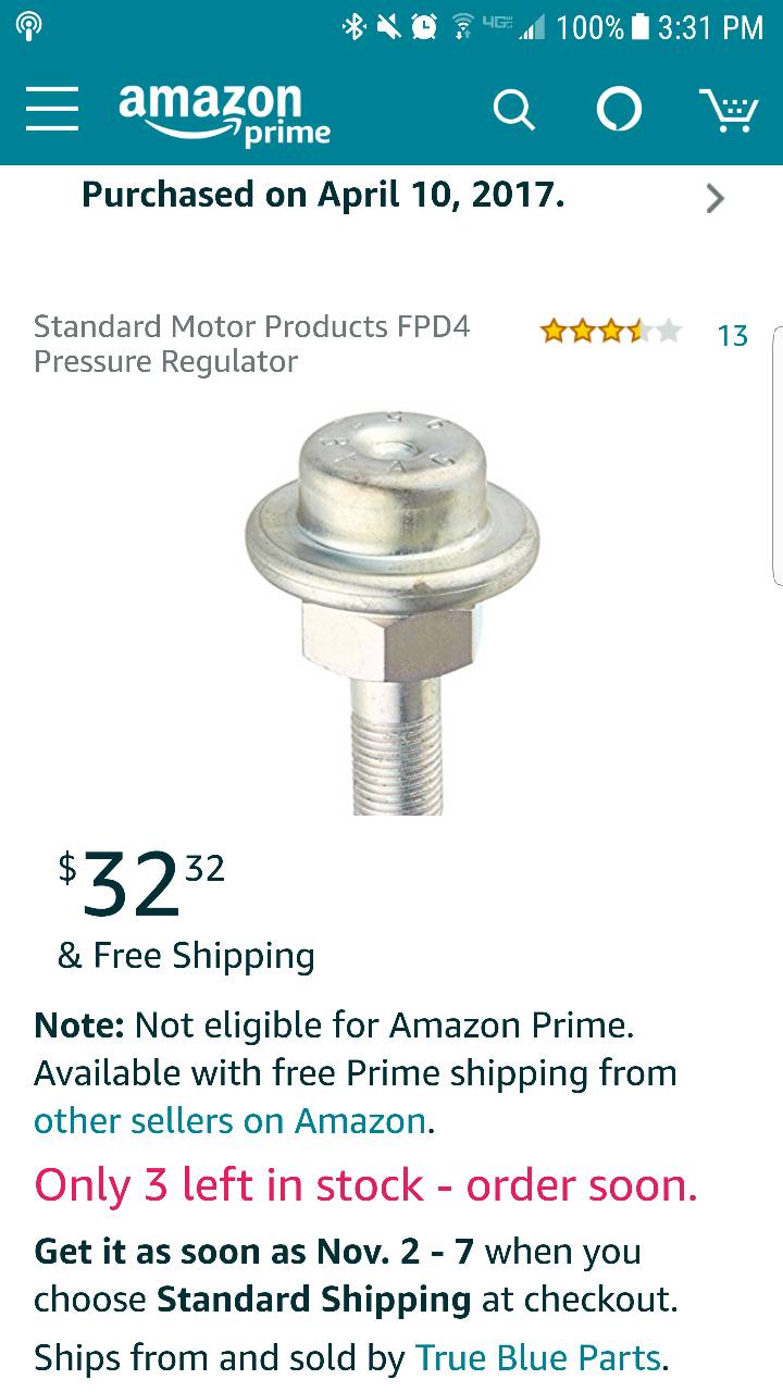

Here ya go
Sent from my SM-G935V using Tapatalk
[MENTION=172281]waypoint[/MENTION] - were you getting a check engine light? did you buy it directly from the manufacturer?
No check engine light or performance issues, just an annoying high-freq tick when accelerating.
I got the Eastern Catalyst part and gaskets from Rock Auto.
