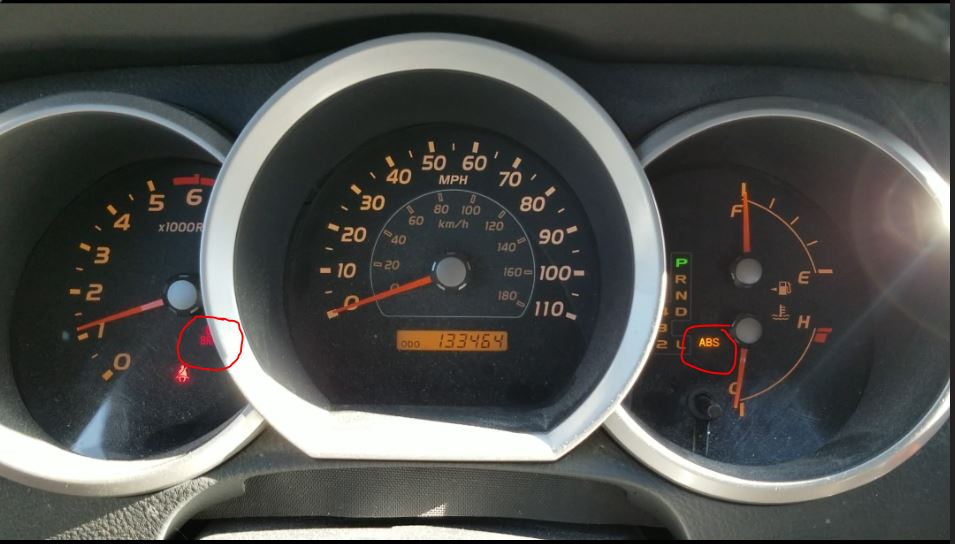

2008 4Runner Parking Brake Warning Light & ABS Light Flicker Simultaneously

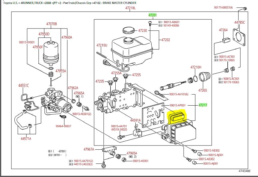

I believe the below highlighted portion is the skid control ECU. Toyota calls it 47217-35010 "Control Module/Solenoid." List price is $1,654.55. Through McGeorge its $1,090.80.

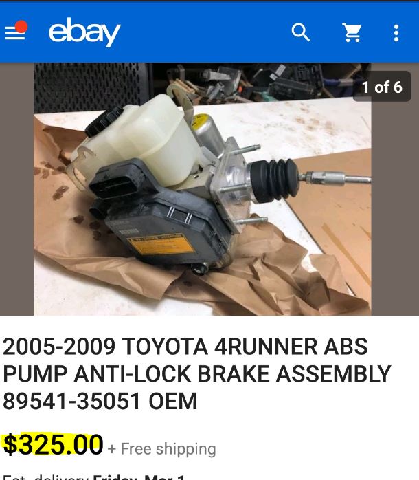

Could get an entire assembly on Ebay for $325 used....might be rolling the dice though

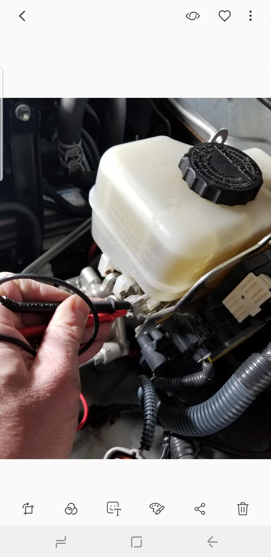

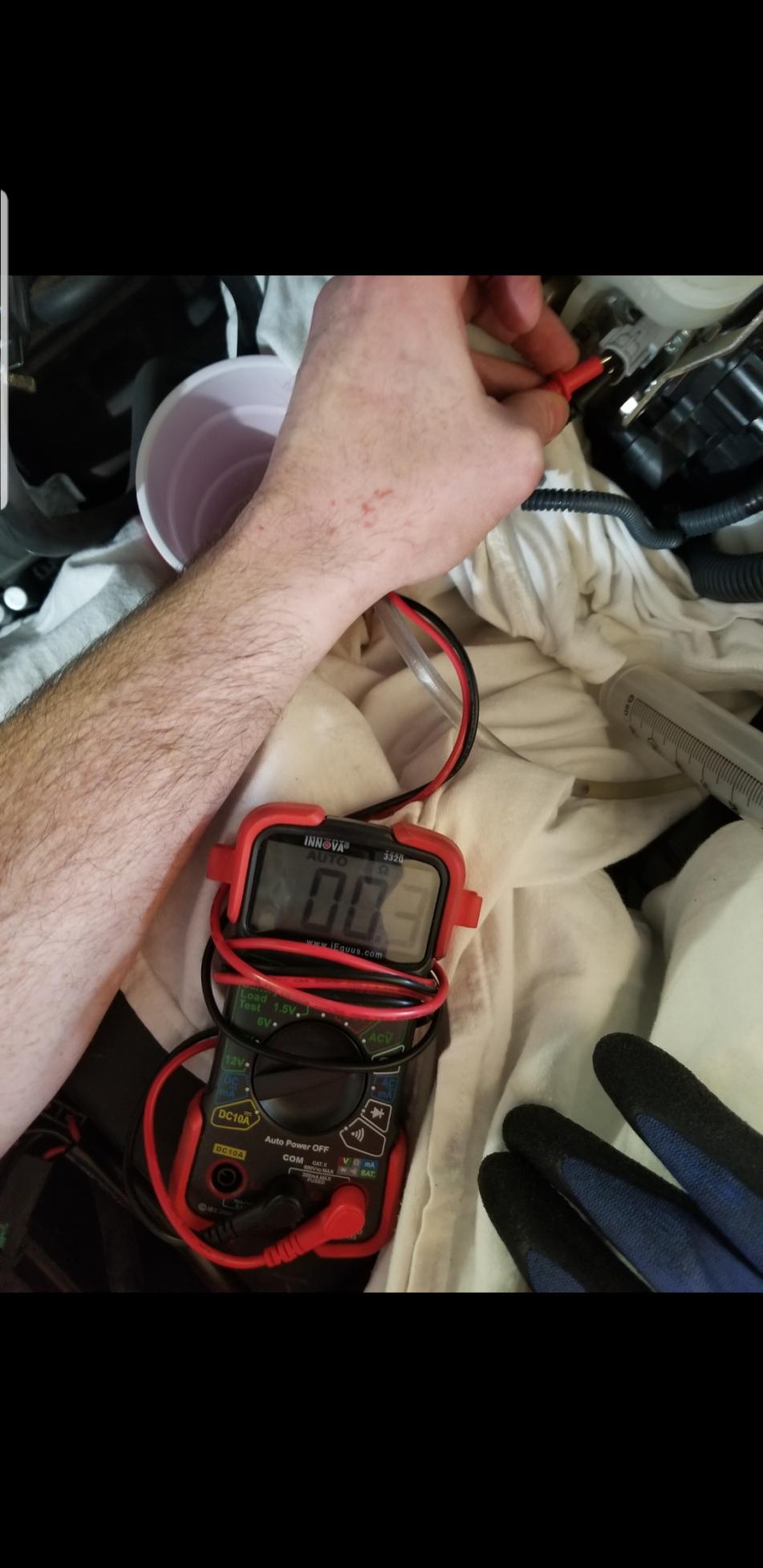

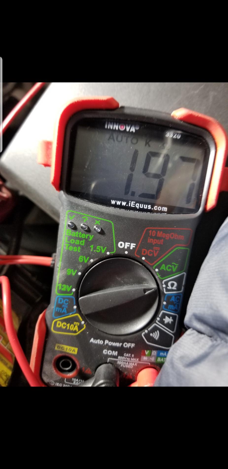

I tested the brake fluid level sensor switch both above min and below min.
I dont think its the switch..the resistance measured where it should at both levels.
Furthermore, the fact both lights flicker when I brake the wheels loose too leads me to believe it's the skid control and abs ECU.
