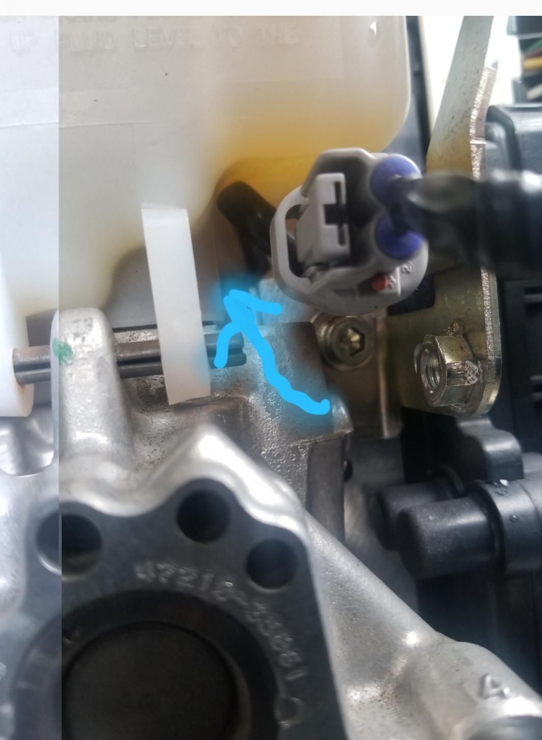

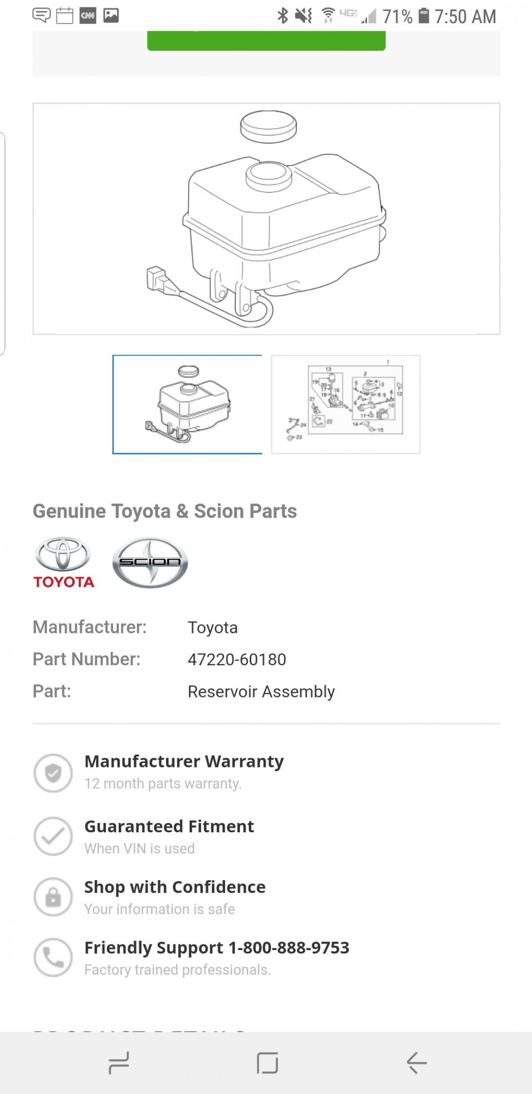

I personally think it has to do with where the blue device feeds underneath the MC reservoir...according to Toyota Parts that is where a sensor exists and its actually integrated into the reservoir.
If so I think it would be this part:
I agree, that would be a sensor that detects that the brake fuild is depleted/empty, so I don't think pressing the brake pedal would do anything to trigger that sensor, so it still maybe something going on in the control module.

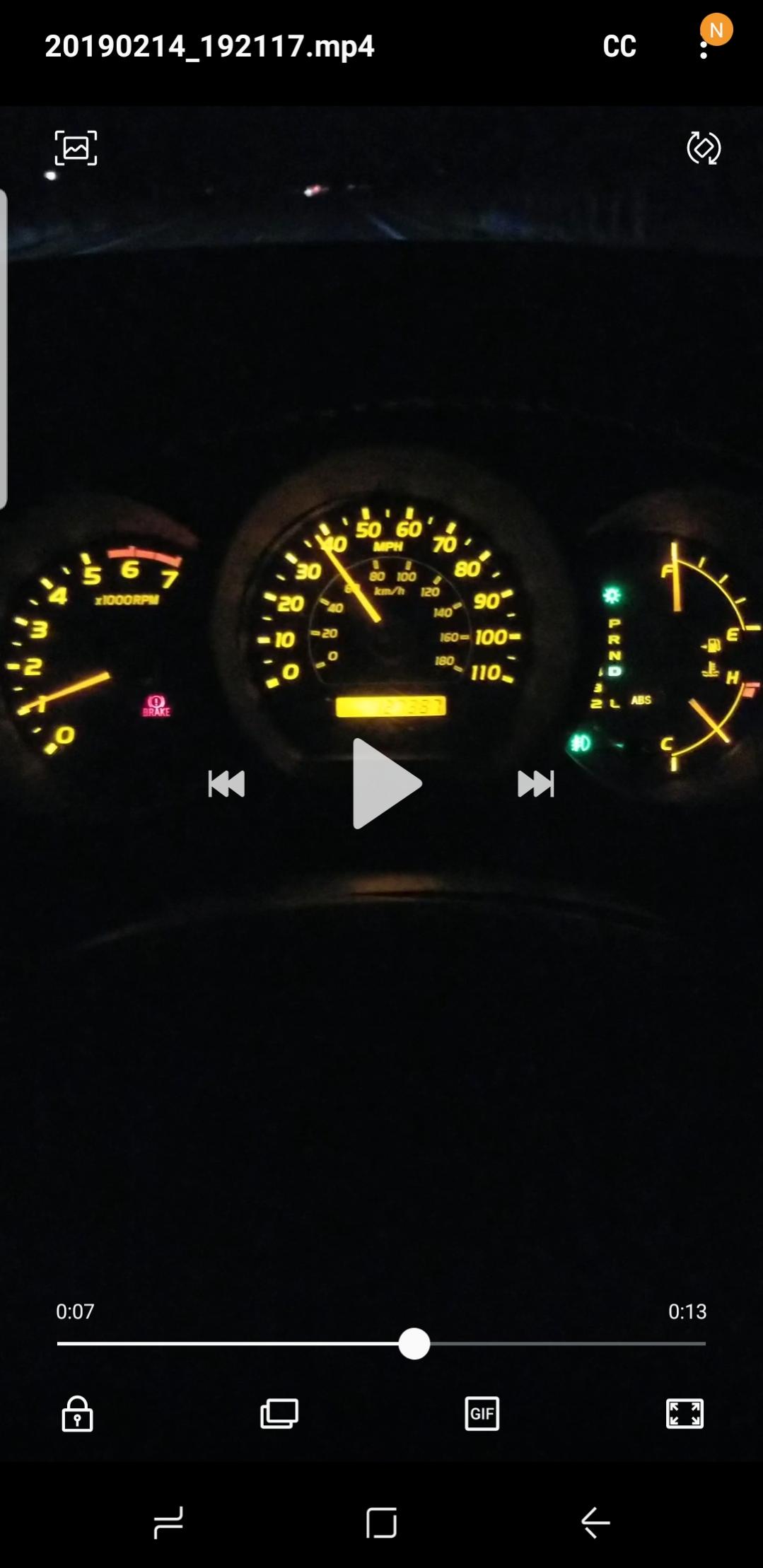

Guess what?? Now the ABS light flickers too when I apply the brake pedal. See lower right in cluster.

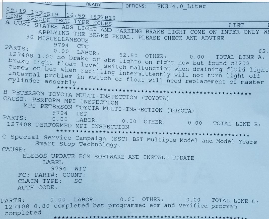

Well.....i brought it in. According to Toyota, I have to replace the entire Master Cylinder Assembly as it comes as one on this particular gen. Two different issues as there are two different lights going on.. $3,513. Not happy. They cleared the codes and the lights and is driving it home tonight to validate before i sink this kind of cash into it. FML
I'm not 100% sure and I could be mistaken but I afraid it maybe intergrated in the control module which is located on the side of the master cylinder and unfortunately nothing on these master cylinders are cheap, a new control module runs around at least $1100 to $1200, I think you may need to take it in to a dealer who has the proper special service tools and let them run tests to see where the issue really is.
If you do need to replace an expensive component you might want to get a complete used or rebuilt unit off of Ebay that has at least some kind of warranty, it will still be expensive but you could most likely find a complete assembly for less than a new control module.
That cost is exactly why I made the post above about trying to find a complete used or rebuilt one on ebay, the cost from where I get my new OEM parts is about $2000 or a little less just for the master cylinder, you can get a rebuilt one on ebay for half that or less, it can be installed by most anyone with a little bit of mechanical knowledge but unless you're lucky it will have to go in to the dealer to get the brakes bled of air properly because of the ABS valves you need a special service tool to get those valves to stay open to get any air out of the ABS system.
It sounds like that dealer is quoting you full retail on the master cylinder..around $2800 and then the rest is labor for an fairly easy install and then bleeding the brakes.
If you look at the link for McGeorge Toyota I posted above and show them the price for the complete assembly item #1 and ask them to match that price on the master cylinder if they say no then go to another dealer and do the same, most dealers will price match if they know you can get the part cheaper then they sell it for, I think you can get them down on price by about $750+/- or maybe even more!!
Also another note these master cylinders can have various parts replaced without replacing the entire unit...BUT Toyota Corprate advises all the dealers to replace the entire unit because it is a complicated unit and not every Tech has the experience to do anything but replace the entire unit and not to mention they make a lot more money doing it the easy way!!

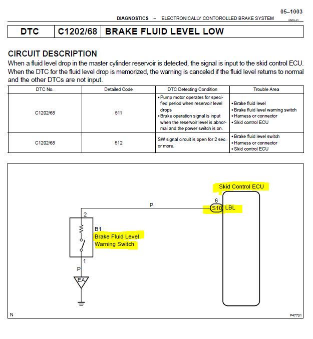

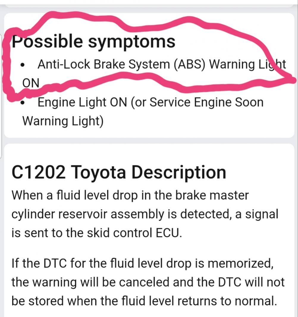

Thoughts? This is from the Master Mechanic at Toyota:

I have researched the heck out of this and my gut says to replace the reservoir with the integrated sensor vs. the ENTIRE master cylinder assembly that Toyota is recommending.

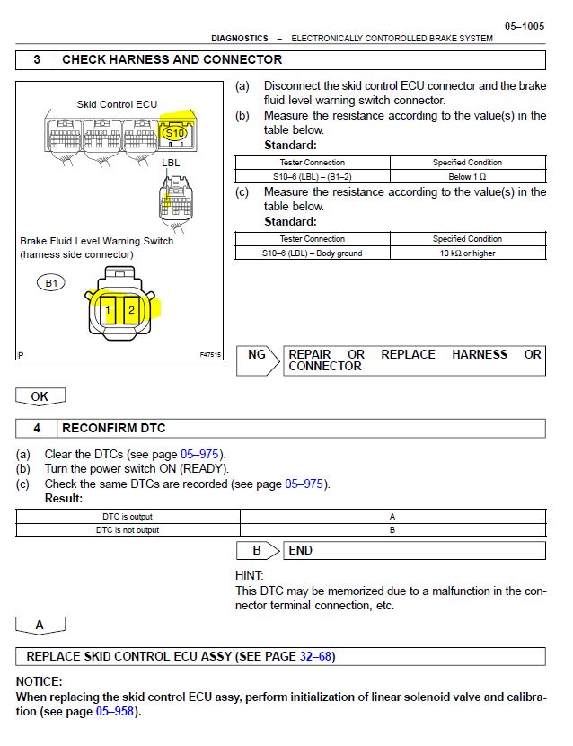

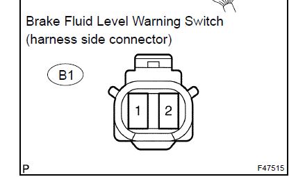

So does that mean I need to disconnect the battery terminals when spraying the Brake Fluid Level Warning Switch (harness side connector)?
I saw your post this morning but had to leave for work, it seems from the Tech's test as he stated that the fluid level sensor is not working correctly, I see you've found the document on how to test it, I was going to post it and it also says that the sensor signal goes to the skid control ECU so it's also possible that there could be an issue with it, but as you have said above I would start with the reservoir/sensor assembly since you can't just get the sensor, because the Tech more or less says it's the sensor...BUT as I stated previously most all Toyota Techs are instructed that anytime there an issue related to the master cylinder assembly to replace the entire unit and as you see the Tech stated just that, I'm not sure why, it maybe the money or it could be it the easiest thing for them to do to ensure a proper and quick fix since the master cylinder assembly is very complicated and the issue could really lie in any of several different conponents.
That all being said I don't think you will be able to get the Toyota dealer to just replace the reservoir/sensor because of what I said above and the Tech stating that the entire assembly needs to be replaced, but if you're lucky they may or you may have to order the part and get a independant shop to replace it, but you need to make sure they know exactly how and has the proper "special service tool" needed to bleed the brakes/master cylinder afterwards.
If either part/terminal of the connector has voltage I would just to be safe and not possibly short something out, it may not have voltage until you turn the ignition on, if you have a muti-meter you can test the connector to see if any voltage is present, make sure you have a good connection to ground and then touch the other +/red probe to the + side of the battery to ensure you are getting a voltage reading and them check the connector for voltage.

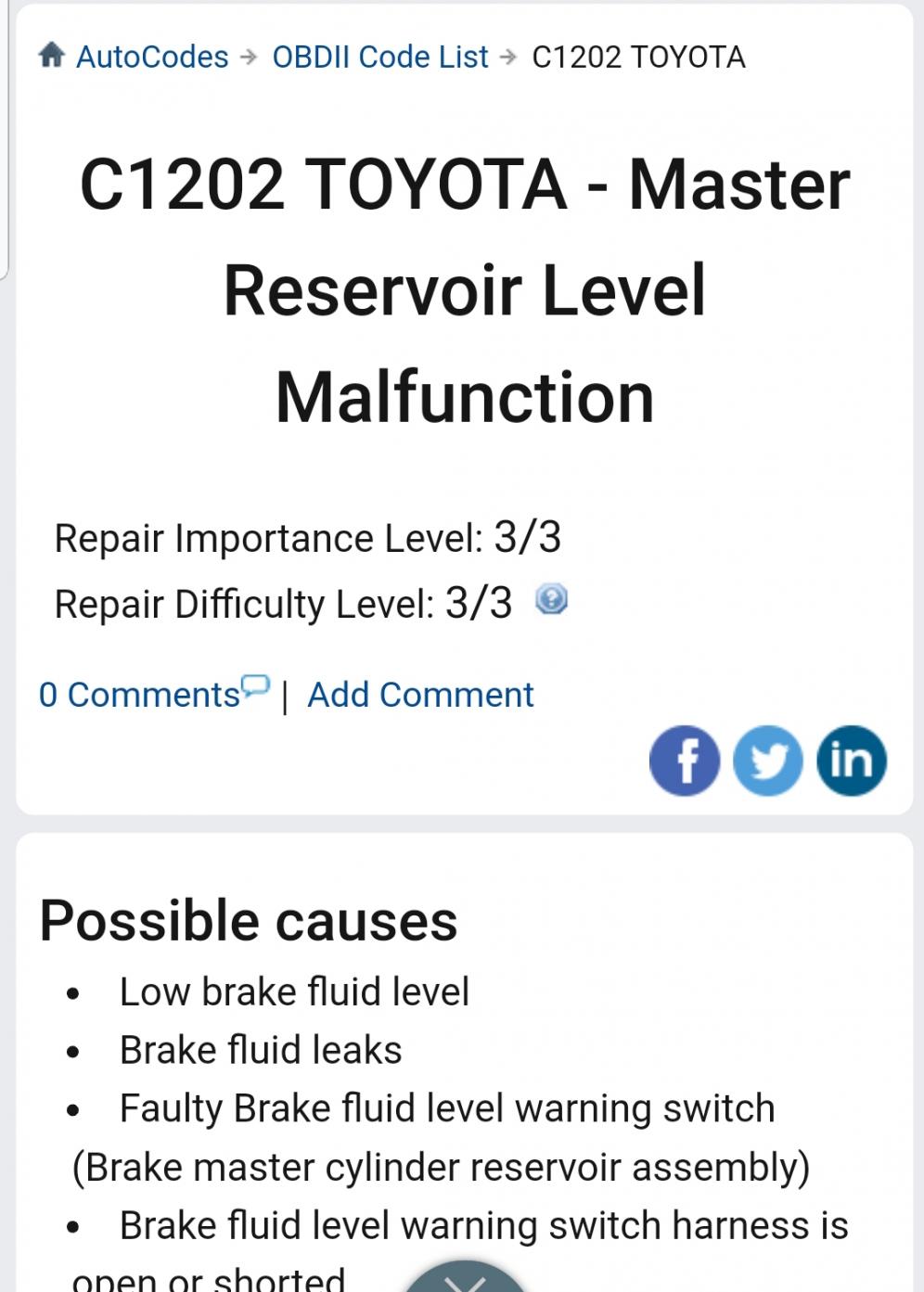

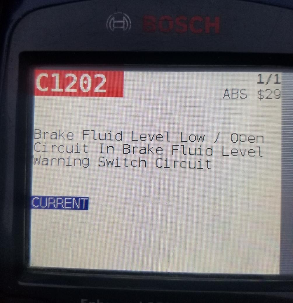

Went to Oreillys Auto Part store and scanned car with OBDII to validate the code Toyota has seen and below is what showed up.
Also Toyota will NOT just replace the resevoir...they will only replace the entire MC assembly...not happening, especially for $3k+. I got them down $400 thanks to the website you sent me. They also said they cant go that deep in discount because they are a smaller dealer..wah wah wah.
I would ultimately buy the resevoir/sensor and probably replace myself. My understanding is the brakes dont need bled if I'm just replacing the resevoir. You are just taking the fluid out of the Reservoir not the cylinder...u agree?
