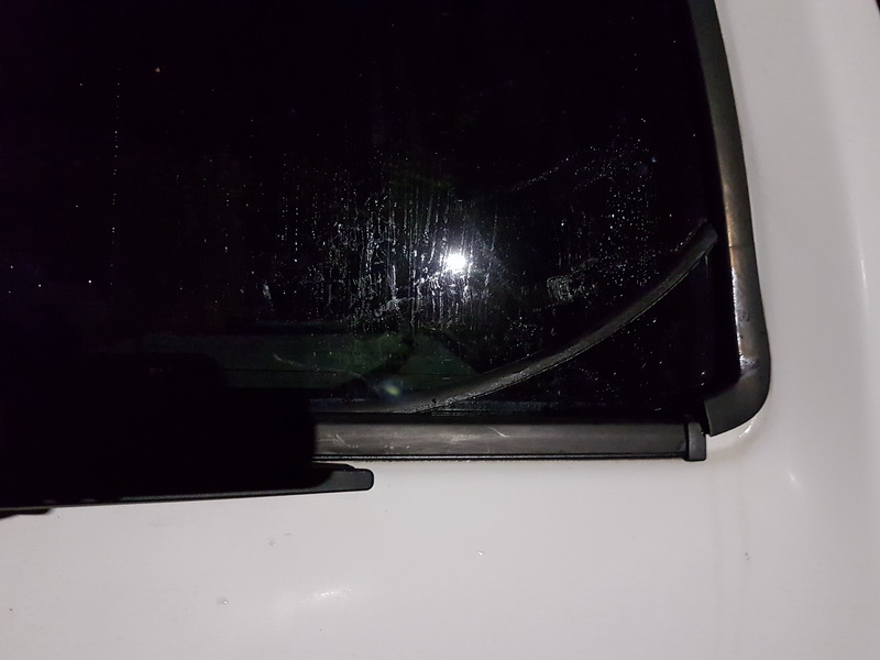

Hi guys I got the same problem on a 2004 4wd SR5. Does this part fit?
Thanks!

Karyins - I hope you've fixed this by now, but if not: yes, the same part is listed for 2003 to 2009 T4Rs. The 4Runner is not known to be difficult to work on, but this is absolutely the easiest thing to fix on the whole truck. No tools are needed. Just roll down the rear window and start prying up on the edge of the weather seal with your fingers. It's just a pressure fit along the bottom edge. It's a little sticky but it will come up. Then wipe out the years of accumulated dirt and slide on the new one. Just be careful of the rear wiper blade mount where it lays against the weather strip.
Good luck.

That same corner of the outer trim molding is separated like that. It must’ve been a flaw where the side pieces were too short or something. I was planning to try to replace that at some point to get a better fit. Fortunately my inner seal is in good shape and doesn’t leak. I wonder if that outer trim molding is as easy to change?
That rubber channel that goes around the sides and top of the window actually goes all the way down the side in the lower part of the hatch, it is also the groove/guide for the glass, you will have to remove the glass to replace it, being such a long piece of rubber it has shrunk over the years and is why it doesn't meet up with the the lower exterior weather stripping any longer, but as it is now it shouldn't allow water to enter the interior, only into the hatch itself which has drain holes in the bottom that will let the water exist the hatch, IF they're not clogged.
