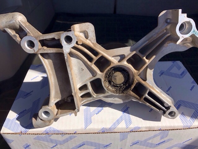

My Fan Bearing took a Dump. Fan Started to Wobble and Make Noise. In less than 24 hours The Pulley Seized and Snapped My Serpentine Belt. Buddy is a Yota Tech and helped me cause I was Stranded. That is Getting Fixed. Just got my T-Belt Water Pump Kit delivered for 2nd Change. New JBA UCA’s Are getting ordered as Stock UCA Bushings Are Shot. He also said my LCA Bushings Are Shot as Well. So new LCA’s are a Must as Well. Brake Job is also a Must. Can’t Complain about 200k miles with original Components. Especially in the Phoenix Az Heat.

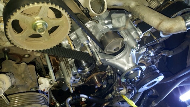

T-belt/Water Pump going in Tomorrow. Along with Cooling Fan Bracket and New Sepentine Belt. Upper and Lower Radiator Hoses.
I’m starting to see more fan bearing failures around 200k. I recently did my major service and replaced all the pulleys and seals while doing the t belt water pump job
Fan Bearing Seized up within 24 Hours of The Fan Starting to Wobble and make Noise.
The Culprit...Look at this Mess. Fan Bracket Bearing Seized. :tsk:

All Done with Phase 1
New Fan Bracket. T-Belt and Water Pump. Serpentine Belt and Upper and Lower Radiator Hoses. Phase 2 is UCA’s (JBA) and LCA’s. Bump Front Billies to 2.5 and Some New Wheelers T-12 1 1/2” or Icon 2” Springs. Not sure which to Get yet. Phase 3 when that is Done is New Tires.

Runs so Much Quieter. Very Happy its Done. Ordering UCA’s (JBA) this Week Also Not Messing with LCA’s Pressing in Bushings and replacing Ball Joints with Moog. Going with Stock OEM LCA’a so I get New Bushings and Ball Joints. Only Doing this Once with Quality OEM Parts. :bounce:
