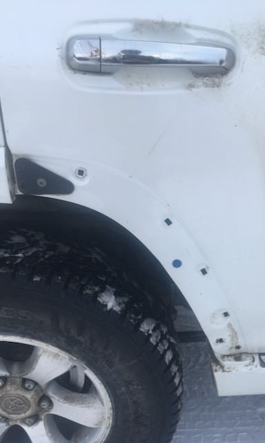

My rear door fender flare came off in the snow while driving down the highway. I luckily was able to find it even though my runner is pearl white. I was able to glue the brackets back on and put it into place, but it happened again. I found the retainer clips on amazon, got them in the mail, and they seem legit. However, I removed the old retainer clips. See pictures. Now I am in trouble, I dont remember what color clips went where?? I was able to call the dealership parts dept. and they said, starting from the bottom, is 3 orange, 3 blues, orange. HOWEVER, in the pieces I still have, there are blue and orange, but also a red retainer bracket. I really dont want to take off the other flare to see the pattern, and was hoping some of you experts might know. Of course I can do what the dealership said, but I dont want to frack it up. Thanks in advance!

So, I got the flare back on. However, the dealer parts dept. sequences (from bottom) of 3 orange, 3 blue, 1 orange, did NOT work. The top hole is square, and will not fit the orange retainer clip. The Red retainer clips did work. So, I set it up 3 orange, 3 blue, 1 red (Starting at the bottom). Not sure if this is correct, but it did work. The clip set I ordered from amazon was good. There are two shades of blue, so make sure and keep the old clips to match them up. Good luck out there!
