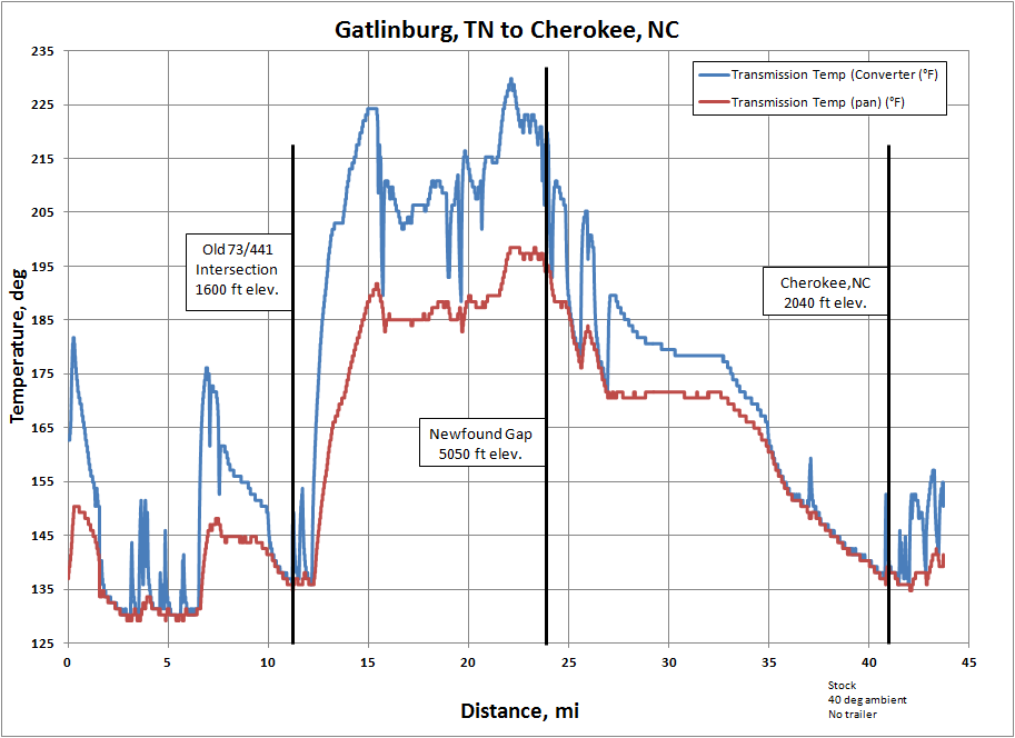

There are 2 temp sensors. 1 that is pan temp. 1 that is converter temp. You're reading the converter temp.
I went over 441 from Gatlinburg to Cherokee last New Years Day and got up to 228 converter temp, 199 pan temp. ~40 deg ambient. Just left it 5th and let the ECU do its thing to see what would happen. It stayed in 5th with the TC unlocked all the way up. :) Not towing anything. The coolant temp didn't budge a bit though.

One of my favorite roads to drive! i'm actually going to our family Cabin in Gatlinburg in 2 months! and i have my scan gauge in the truck with me this time, so i'll get some readings too but i'll probably use 4th gear mostly.

Yeah, 4th is the way to go :)
